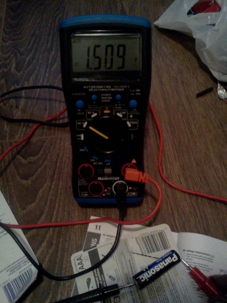

Update: I got a nice auto ranging multimeter today...
So I plan on doing some testing on the coil. Packs, test them once while they are cold, then again when hot.
