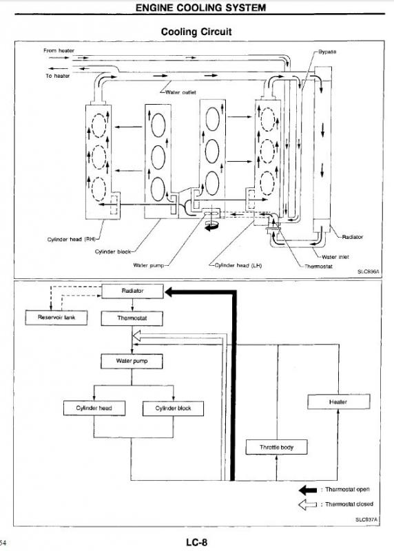

Fakie and CS_AR also have links to the FSM in their signatures. Anywho, here is a direct link to the FSM. Click me
For water pump replacement, you want the LC section. specifically page LC-9

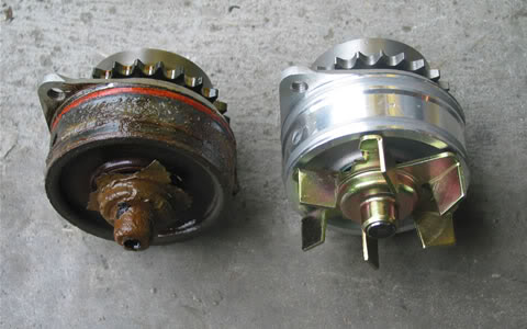

Your ***** not plugged. Every single symptom you've had points to the water pump impeller dealing destroyed including straight water in freezing temps.
YOU HAVE NO FLOW BECAUSE THERE IS NO PUMP!!
Stop treating the symptoms and treat the problem.

Yes, but as Asand1 pointed out, and CS_AR pictured, this is more and more likely a case of the water pump being destroyed rather than going bad through normal wear and tear. As you may be beginning to see, frozen H20 is like the incredible hulk

Ok guys it was the WATER PUMP! Everything works now.... no overheating, hot heat, radiator burped properly, etc... When he took the water pump out, the body (big piece) came out but the fins were left behind, hence the reason why it's in 2 pieces.
I think this happened because the night before the problem arose (couple weeks ago) it was the coldest night of the season. I think water froze in that area. I think that would explain the loud grinding noise I heard when turning the car over.

Try post #78. That link should open up.
I had a feeling a while back it was (based on the comments, symptoms, your comments, etc...) but the water pump was the most expensive and time consuming fix of them all.
I've gotten to know the 4th Gen fairly well and when something happens Sometimes I have an idea. Then I come on the ORG, read up, and figure it out (well you guys figure it out.)
Between both Max's I drove about 240k miles and never had a water pump issue so this was new to me.
