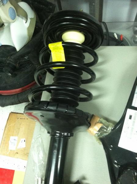

what was actually in the quickstrut boxes
Attached are pictures of the Monroe #171682 & #171683 I purchased from O'Reilly's in the Village in Houston, TX.
The quickstrut with the large white bushing at the top/robust boot/"the one that looks put together properly" is #171682 (front right).
The quickstrut without the large white bushing at the top/smaller diameter, shorter length boot/"the one that doesn't look put together properly" is #171683 (front left).
So the disclaimer is that I've not previously seen correctly rebuilt left and right front struts for a 4th Gen Maxima/I30 - this is my first time working on this car. That being said - I'm pretty sure both sides should look pretty much the same (except for the orientation of the top hat and lower control arm perch) - and I'm pretty sure the one with more robust bushings and boots (the one with the white bushing at the top) is the one that I would want on both sides.
Doesn't it look like the quickstrut without the white bushing/all that silver of the strut rod showing due to short boot length was "not re-assembled with the correct parts"?
