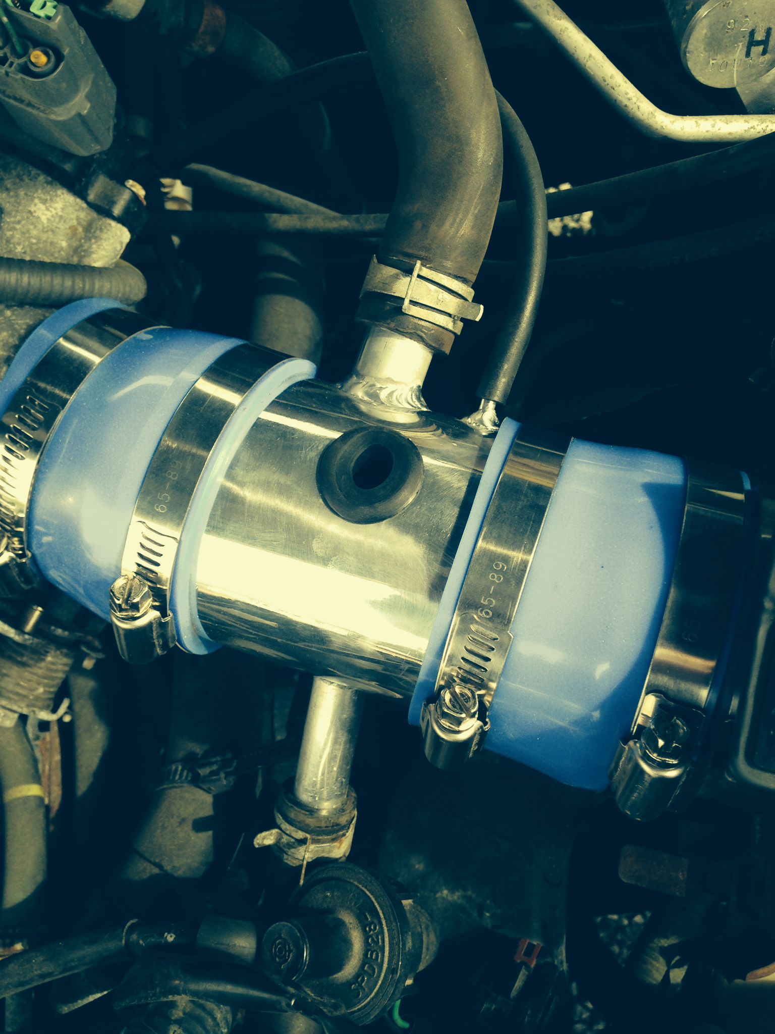

i dont know why it would be a restricted but heres a picture i removed it from its stock position and put the sensor in here, the maf is to the right just out of the picture Name:  bv2D5dX.jpg

Nice photo, but where is the air intake temperature sensor that goes in that opening? Did you leave it in the old air filter box? You have to transfer it over.

No I did transfer it this is just a photo from before I put it in there
