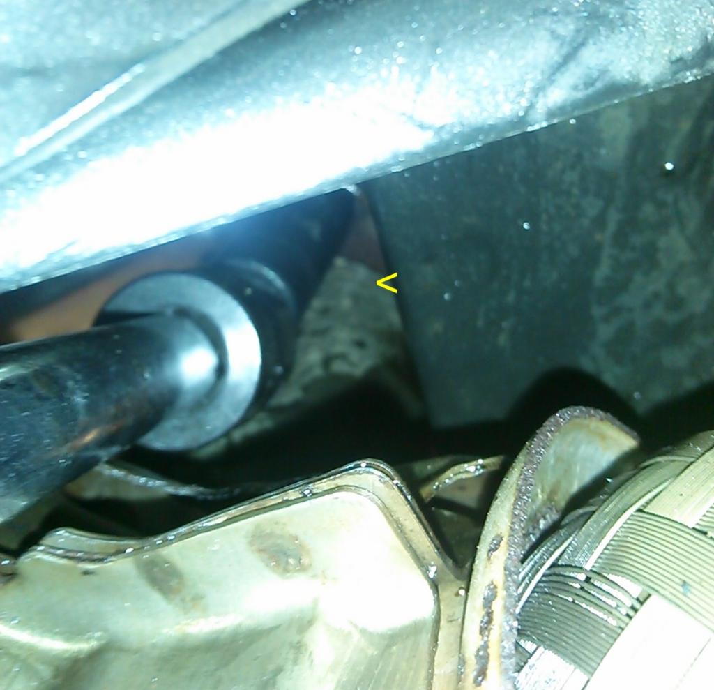

2) Most Difficult 14mm Nut
There is one 14mm nut on the "right hand" (e.g. closest to the firewall) exhaust manifold bolt that was the hardest to reach. The 14mm barrel socket worked best for that nut. You'll be glad you have a 6-point 14mm barrel socket when you start to remove that nut.

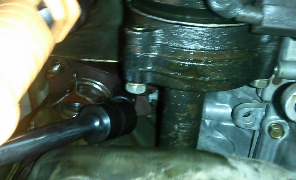

3) Next Nut Removal Pic
After you remove the nut in the picture above, you will want to switch from 14mm barrel socket to the regular size shown in this picture. The barrel was too long for this nut.

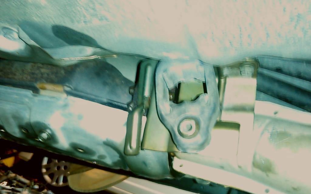

6) Rubber Hanger Bracket
I slipped a large blade screwdriver behind the rubber hanger bracket to slide it off the mount. Removal could have been easier if I had sprayed some NAPA Ru-Glyde (or other tire mounting) rubber dressing on it before removal.

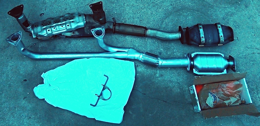

New Y-Pipe and high-flow cat alongside the old.

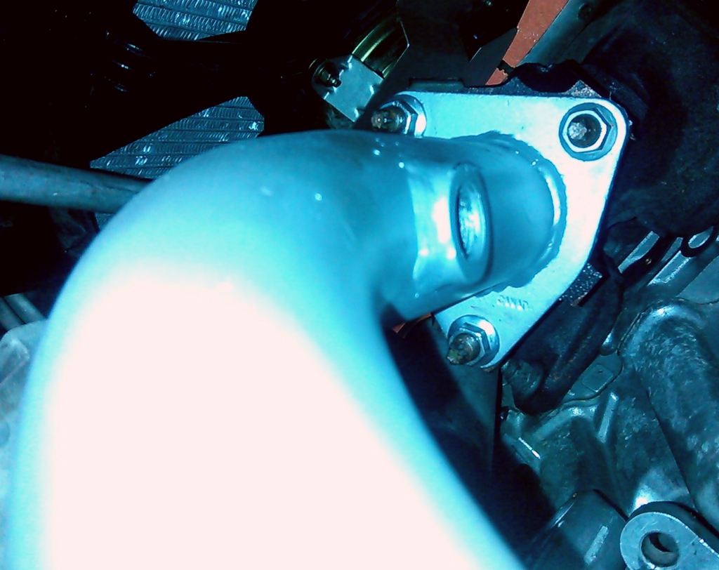

Left Side (e.g. by the Radiator) Pipe-to-Exhaust Manifold

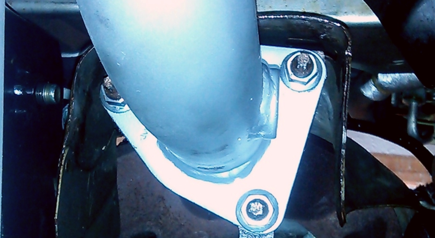

Right Side (e.g. by the Radiator) Pipe-to-Exhaust Manifold
