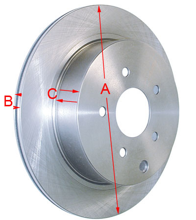

Okay so im thinking possibly my rotors could be causing this ?? The outer part of the rotor the part the part the wheel touches on the oe maxima rotors is 280mm and the rotors i have the outer diameter is 295.5mm can this be my cause??
Old May 2, 2014 | 05:55 AM
No that's the width of the disc itself. See the pic below? The measurements you gave are A. The problem seems to be C, the thickness of the hub;
No.
How thick is the center section of the rotor- the part where the wheel studs go through? factory rotor thickness is roughly 1/4" there. to cause this problem, those aftermarket rotors would have to be an inch thick there, and I guarantee you they are not.

Rotors will not do this, they sit flush with the hub, it they were too wide for car, they would hit brackets among other things...Need to do more homework on your wheels, seems like just a fitment issue. show full pics of the wheels front and back, with numbers...
This is incorrect, it's not "C" it's actually the width of the front face plate of the rotor, where the studs go through. That's what sits against the hub. Think about where a spacer sits. There's no way the rotor is re-positioning your wheels, unless the rotor has a built in spacer. If that were the case you'd notice it by the length (or lack there of) of the studs threads, and it would be a pretty big heavy face on that rotor.
C - Positions the braking surface area properly between the pads on the caliper.
You have the incorrect wheel offset, (or a spacer your not seeing) that's what's throwing them out, nothing else.
