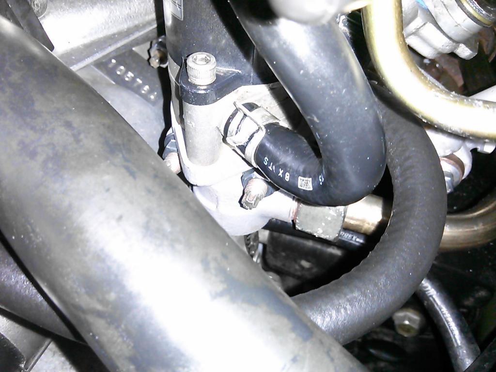

Here's a picture of the hose I used to bypass the Plenum (a.k.a. UIM) U shaped EGR hose.
I found some heavy duty hydraulic fluid cooling line hose that is supposed to carry transmission fluid up to 400 degrees. The walls in this type of hose are thicker than standard parts store cooling line hose. It fits perfectly and it works with standard Nissan hose clamps.
I ran a long piece of hose from the starting point in the picture below to the EGR. The other hoses in and out of the throttle body and EGR were left intact.
I took a small piece of old heater hose insulator from an old Q45 hose and wrapped the area when it rests against the standard heater hose bracket and wrapped it with silicone fusion tape since it protects up to 400 degrees and does not use glue. Then I used a couple of zip ties to hold the bypass hose next to the heater hose.
The smaller hose in the picture below (between the two heater hose) is the bypass hose.
Here's a picture of the bypass hose as it connects with the EGR.

Here are some pictures of my 99 model Throttle Body and EGR coolant hoses without looping through the UIM's U-Shaped hoses.
NOTE: Since I only have 99 models, I only have pictures with the 99 model's electric EGR.
Basically you are making a loop with the small coolant hoses in the first picture (as shown on the left), that connect to:
1) head crossover coolant supply pipe (Coolant Pipe Hose 1) and
2) heater coolant supply pipe (Coolant Pipe Hose 2) that loops through the
3) Throttle Body and EGR.
Throttle Body Hose 1 to Coolant Pipe Hose 1
Throttle Body Hose 2 to EGR Hose 1
EGR Hose 1 (Left) - EGR Hose 2 (Right)
EGR Hose 2 to Coolant Pipe Hose 2
