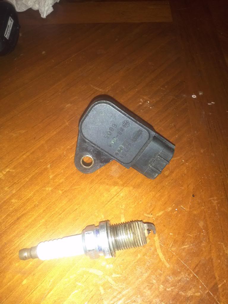

Quick fix for P0303 I changed this sensor when I had a cylinder code that wouldn't go away which was p0305. Your ecu might not be bad and might be this sensor which tells which cylinder how to fire. Here's how I fixed my cylinder misfire. I changed the crankshaft position sensor that hooked up to the transmission and the spark plug for cylinder 3 that only had 4,000 miles on it which was double plat ngk. One year ago I had a cylinder 5 misfire code and it wouldn't go away and I changed the crankshaft sensor on the tranny and it was gone. The misfire only occurred when changing gears and at highway speeds but not at idle and I even changed the maf and that didn't help and the coils were all oem Nissan brand new from about 5,000 miles ago. So the conclusion here is that its not always a bad coil, maf or etc. it could be tiny little things like the crankshaft sensor or a spark plug that could be new but still bad some how. Since the crankshaft sensor is responsible for engine timing, the driver may experience engine backfire or irregular rpm function, if the vehicle starts at all.
Read more: http://www.ehow.com/about_5860665_ba...#ixzz2zTIZR81N
