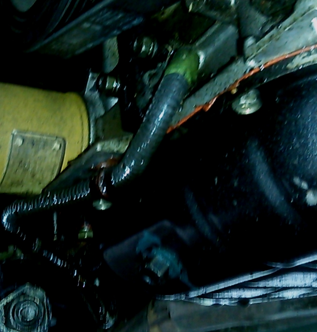

The front CKPS harness wire is near the PS and main belt that runs the alternator. Check to see if a broken belt could have knocked the front CKPS plug loose or damaged the harness wire.
A picture of the CKPS harness wire and plug is below.
