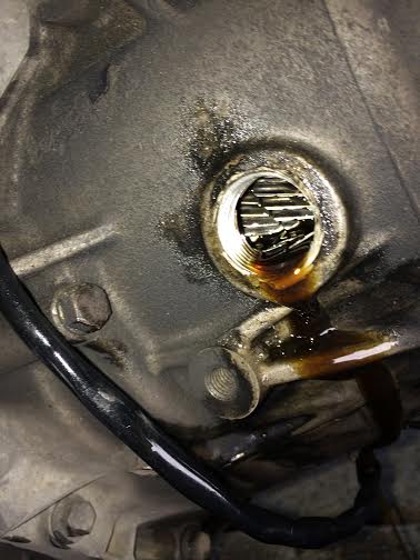

I tried putting a picture of what i am looking at. The leak was way worse at first. i took the picture after i wiped everything off, and it continued to come out.

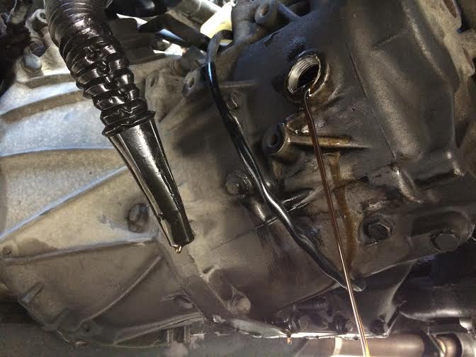

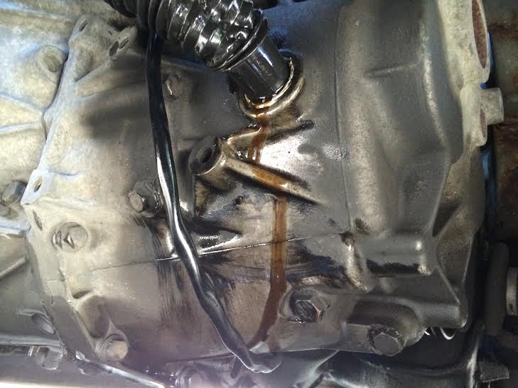

More pics
I attached more pictures of what i saw when i took off the funnel.. all the fluid i put in immediately rushed out. Why is it doing this? the car is almost perfectly level and not on a hill or anything.

And it looks like the "drain plug" you are using is actually the fill hole.
When it leaks out of that on level ground it's full.

Ah I figured it out. It turns out the car didnt leak out ALL the fluid when it popped and grinded into reverse. The reason why all the fluid didnt come out when i removed the drain plug is because i still had the fill bolt on; which means there wasnt good air flow for the fluid to come out properly. Also, there was stop-leak all inside the drain hole, which stopped the fluid from coming out.
