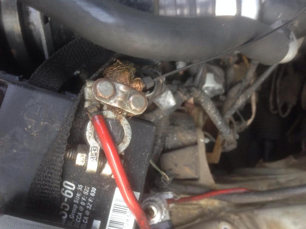

Yeah true looks like whoever had the car before didnt take much care. The wires look decent. All though positve wire looks clunked up.
http://<a href="http://s36.photobuck...1;/ATTACH]</a>

Car has a little bit of a misfire. Were it misfires at idle for like 10aeconds stops and randomly comes and goes. Changed coil and all plugs too. So im guessing the p0600 is something being disconnected and not a fuse. I can be wrong tho
