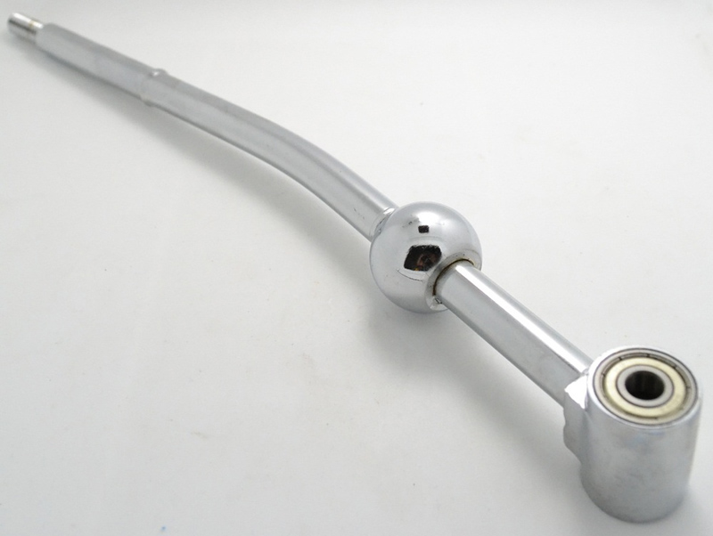

As you know may know, the generic Chinese short shifters do not come with a bolt. These use roller bearings (what you find in skateboards) and the factory bolt is too large to pass through...

I was looking for a budget short shifter so I bought one from China: http://www.aliexpress.com/item/Short...107425073.html
Not bad for $24 delivered. It feels solid and the throw is way nicer than stock.

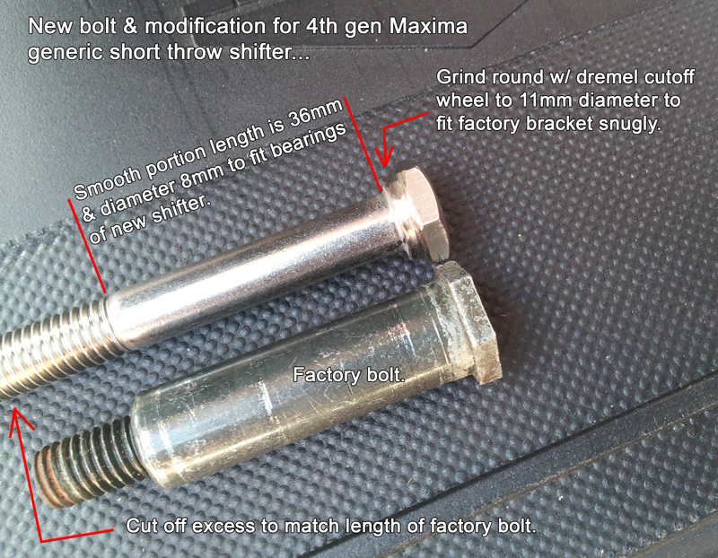

Now, the important thing with this bolt is that the smooth shaft is the right diameter and length to fit into the roller bearings of the new shifter... The rest can be modified from here... See the pic for description.

The rounding of the hex part is necessary for the bolt to sit snugly in the factory bracket, see the 2 bolts side by side.

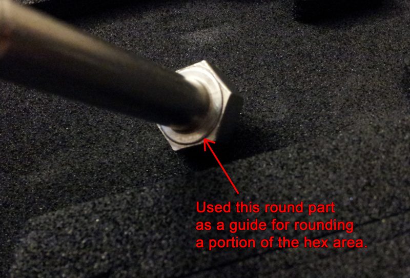

I used a dremel type tool to round off the portion of the hex head. It helps to use a new cut off wheel as it's edges are nice and square and not rounded.
The bolt actually has a round indentation which I used as a guide while grinding.
