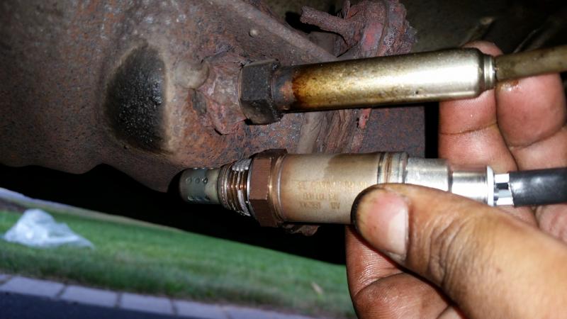

Hi everyone!
I have been getting a rear O2 sensor fault for many months. I went to go replace it only to find what seems to be another type of sensor. This has been there before i owned the car so i have no history of this maintenance. I was under the impression that both the upstream and downstream sensors are identical. Perhaps the original threading was damaged and they put in another type of O2 sensor that works with the Maxima system. Any ideas as to what type of O2 sensor this is and if i can just purchase this specific type again? Any help would be greatly appreciated!
1996 Nissan Maxima
278K
All stock.
Attached Thumbnails Rear O2 sensor alternative?-20140801_183706.jpg   Rear O2 sensor alternative?-20140801_183746.jpg   Rear O2 sensor alternative?-20140801_183715.jpg

Welcome to Maxima.org. It looks like someone welded a different size bung onto the exhaust pipe. I can't identify the sensor. I can tell you the downstream sensors use a different type plug as compared to the upstream sensors. The tool to remove a Maxima 4th gen sensor is a 22 mm or 7/8 inch.

Iirc depending on the date of manufacture 96 came with two different thread sizes on the downstream.

Is the type of O2 sensor that is currently installed shown in the following link?
http://www.carid.com/1996-nissan-max...-21099922.html
Old Nov 24, 2014 | 07:44 AM
ABIGBRAIN's Avatar
Joined: Nov 2011
Posts: 475
From: Tampa, Fl
That would be the one.
Old Nov 28, 2014 | 10:07 AM
IndianSpice's Avatar
Joined: Dec 2007
Outstanding. That sure does look like it's the correct one. I'm going to have to verify the harness but it looks good. Thanks for all the help. The human connection is still better than a computer!
