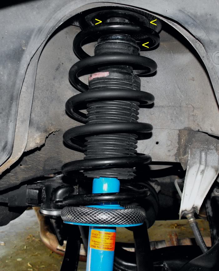

You'll like the Blues. I run Blues on my 99 I30 and 91 Q45.
