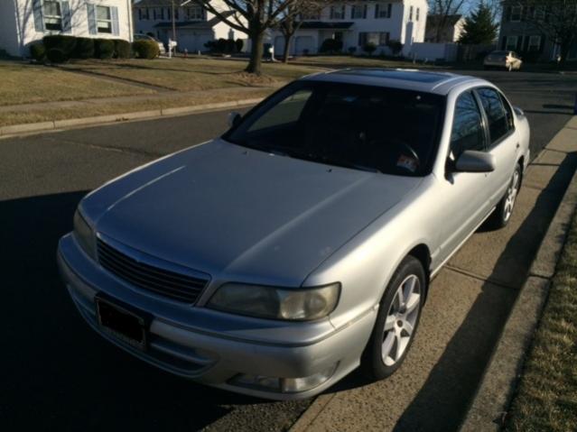

Last night, as I pulled my 98 I30 out of my driveway, I noticed that my steering fluid still needed more time as the wheel was extremely stiff. I waited a little and continued to take the car out and ever since, my steering feels loose between 11am and 1pm on the steering wheel. When at a stop, it clunks, but when moving, I do not feel any abnormality. Any thoughts? The car is slated to be traded in 3-4 weeks, so I'm trying to avoid any major expenditures.

So a couple of weeks ago, I was driving back from work...Tried to make a left turn and the car kept going forward while my wheel was turning left. Fortunately for me, I had let all the oncoming traffic go by and the steering wheel caught by the time my top hand got to the bottom. I pulled into a local shop down the block as I didn't want to take a chance. The shop knew I wasn't about to drop money into a new rack, but indicated that they tightened up a joint piece that was loose, but that a rack would be the long term fix and charged $100.
Steering drives nice and tight, but the only things is that after the fix, my steering wheel needs to be at 10 o'clock to go straight and my clockspring appears to be unplugged/damaged as the horn/air bag appear to have issues.

I can't speak to the condition of your rack and pinion, but your u-joint connecting the steering column to the rack probably needs replaced as well as the clock spring.

hey thanks for bringing this up.. I was having the same issues.. my steering is super loose and my power steering was acting up. I thought it was my inner tie-rods, but now am thinking the rack or u-joint from the shaft to the rack.. I really don't want to drive my car on the highway because of how loose it is. will be taking her apart soon. let us know what happens brotha!

My FIL had a bad joint on his F250 where the aluminum yoke got loose on the shaft and wiped out the splines. This resulted in a loose steering wheel with approx. 45* of slop. I was able to tighten it up for a band aid fix, but ultimately installed a wrecking yard intermediate shaft. A new shaft was $200+. WWJD180, I believe this is your problem, and no fault of the rack.
Another failure mode is a steering wheel that alternates between stiff and normal every 90*. This is due to a joint with 2 dried out caps (needle bearings)
