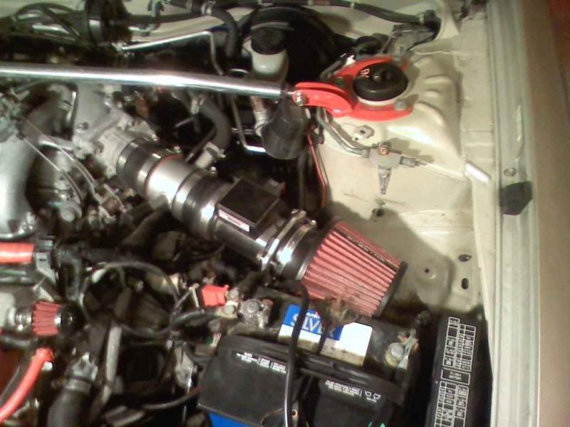

Ok so i am looking for the air box that is right before the throttle body ill post pics for better description. I brake the plastic hose connection to the engine body so i need to replace it . Also i have seen people have small filter on the part of the engine but there about 3 inches big were can i get these so i dont need all the hoses and can just put a mini filter there. Also have a pic of someone with it in the bottom left corner

what is the name of this piece and were can i find a mini filter.....-images.jpeg
The one marked in yellow is what im looking for
Attached Thumbnails what is the name of this piece and were can i find a mini filter.....-1118001720a.jpg   what is the name of this piece and were can i find a mini filter.....-2015-01-29-14-57-47-1206715794.jpeg

You have the air box circled in yellow.
It's also known as a helmholtz resonator.
Junk yard is your friend for this.

Search on the for sale forums here, it's more commonly called a resonator.
If you search for "air box", you might wind up with the air filter housing.
The Nissan P/N for it is 16580RA and is called resonator assy.
IMHO - There is no reason for a mini filter or PCV filter to vent to atmospher. When you get the new part, simply put the hose from the valve cover back in place.

The first pic with the metal pipe and metal nipples would be a short ram intake.
Here is the ebay SRI.
You will also need a maf adapter.
