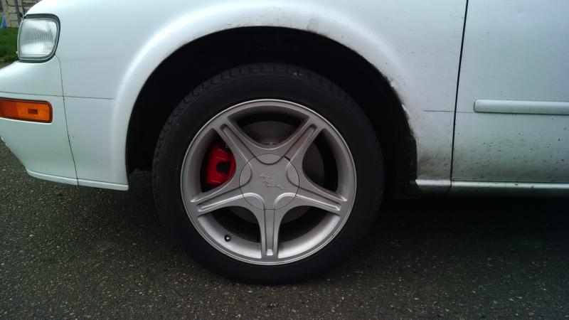

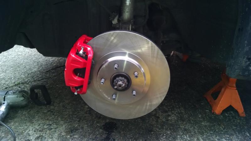

What size are your wheels? I just did 6th gen (2006) brakes and they are awesome. 12.6" and only $200 for calipers, pads, and rotors. Another member here was able to fit them inside 16" wheels using a grinder.

Sent from my XT1060 using Maxima
