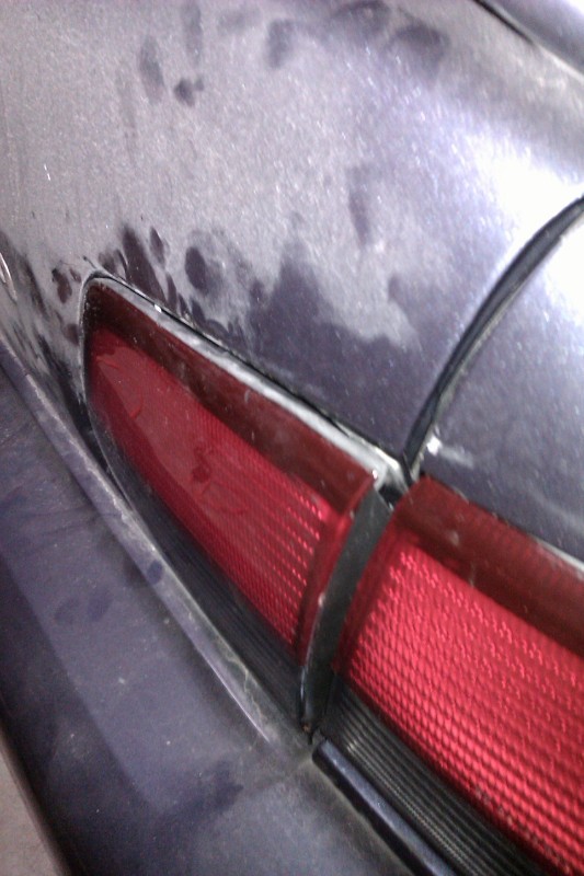

so my clear eagle eye taillights came in today and found a small crack on the driver side that attaches to the quarter panel, on the left side on the black area it has cracked a little, Is this fixable by the shop? And I also got this weird sticky looking "play dough" glue, is this what its used for? I will upload a pic of it. it wont completely come off though, so that being said its fixable? its not touching the light area.

Dang, those are some blurry pictures . I would send them back or at least contact the vendor to see what they have to say. You never know if that crack might turn into something bigger over time. I remember when I changed the tails on my '95, that adhesive / goop had a pretty good grip on those tails. I had to use a good amount of force to get them out.

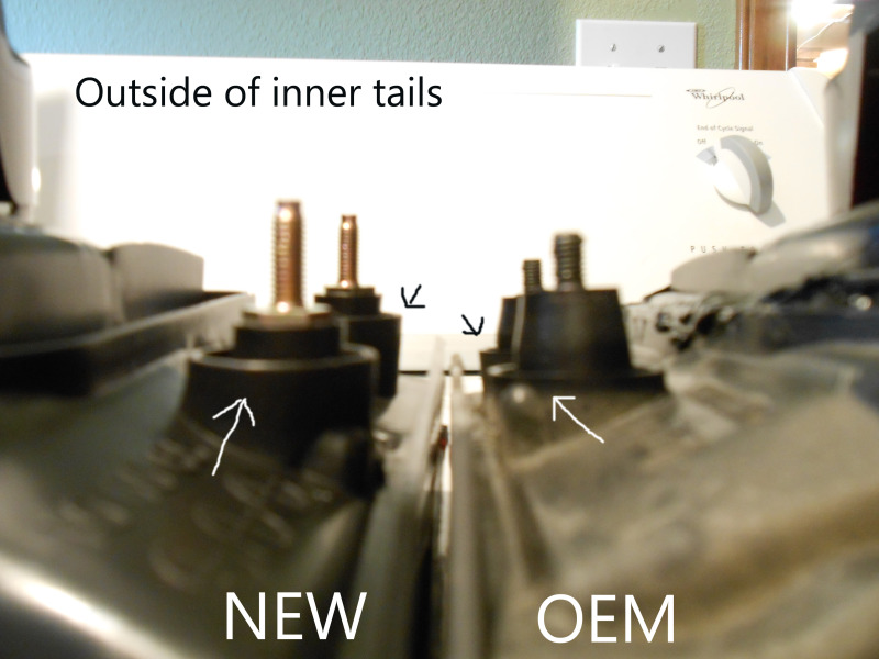

the pay-doh roll stuff it the Butyl...you basically unroll it around the perimeter groove before you put the tails on the car.
You should trim the inner tails' bolt mounting area a bit first...here's why:
they'll look like THIS mounted if you don't:

What do you trim it with?
Old Mar 18, 2015 | 08:13 PM
Amerikaner83's Avatar
Posts: 11,386
From: WA
dremel is best
Old Mar 18, 2015 | 08:24 PM
Cylent_JDM's Avatar
Joined: Feb 2015
Posts: 13
From: North Carolina
I dont have that, would a soldering iron work?
Old Mar 18, 2015 | 08:32 PM
Posts: 11,386
From: WA
yeah I suppose...the key is to get it as flat as possible...this is what's resting against the vehicle, remember. I suppose some dikes and a soldering iron would work...crude, but would work ok. Maybe along with a file?

so is the crack atleast able to glue it back in place? I tried putting it together and it looks like if they put some strong glue it would make it stay in place. or atleast when its on the car it will snap right on and close that crack? I mean I was gonna expect something as they are in fedex trucks bumping everywhere and hitting stuff.. so I was not a bit surprised.

It came with rubber washers so itll flaten out with that too..
