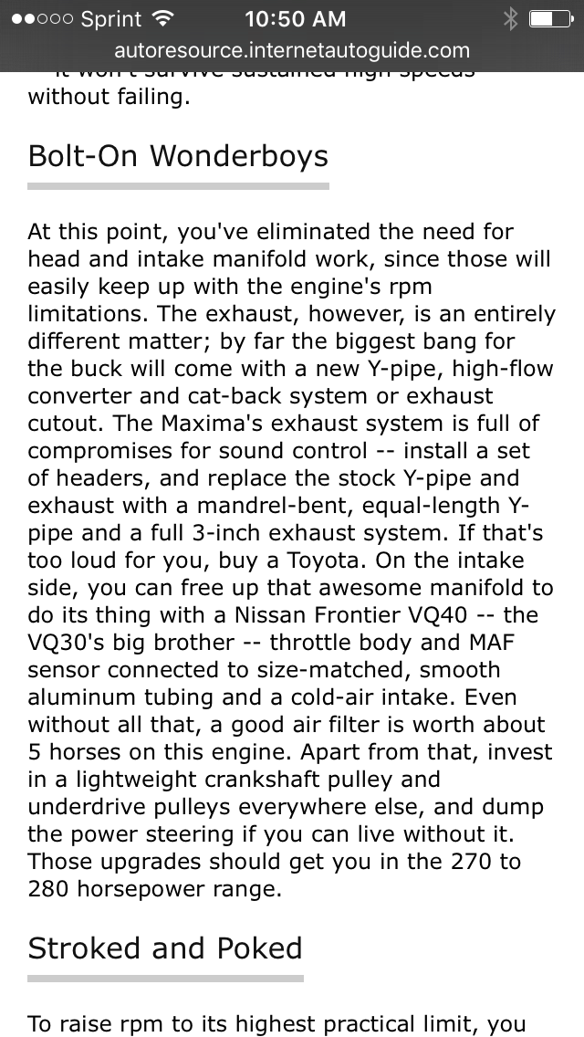

Ok, so I know this may be off topic but I looked everywhere on here and can't find anything I had a question. On auto source it says something about I can use the vq40de throttle body and maf sensor on my 2001 maxima. But I was wondering what else I might need from the frontier like the wiring harness or anything?

Here's a pic of the page talking about it
How many times and how many places are you going to post this?! Enough already...
