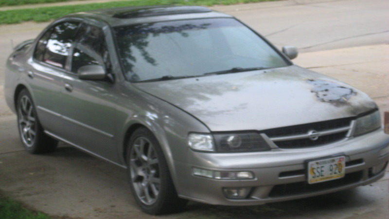

Neighbor rings my bell three time in rapid succession
I answer the door, what's up?
Your car is on fire!
whughwut?
your car's on fire!

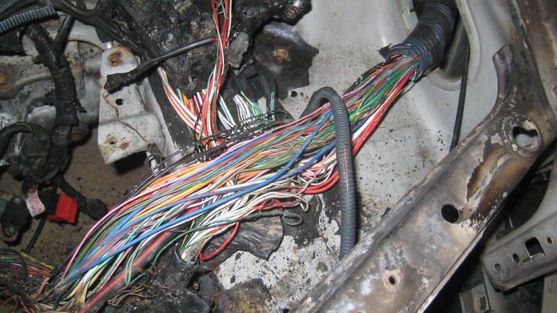

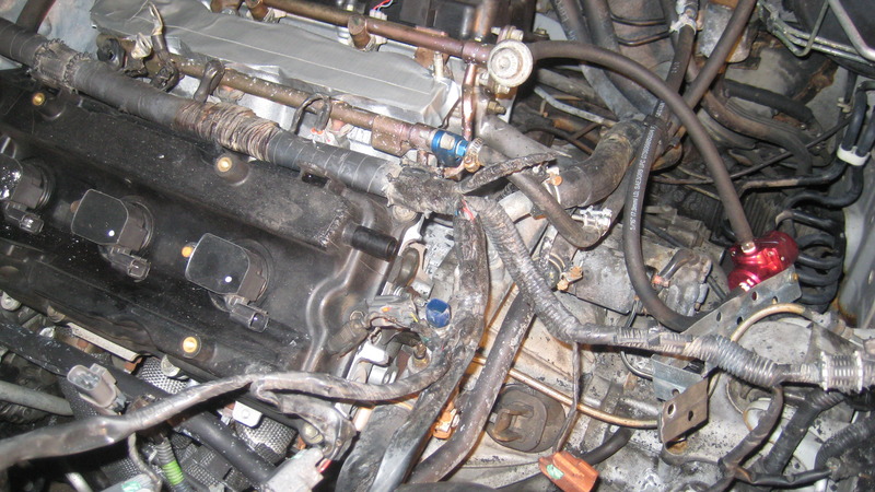

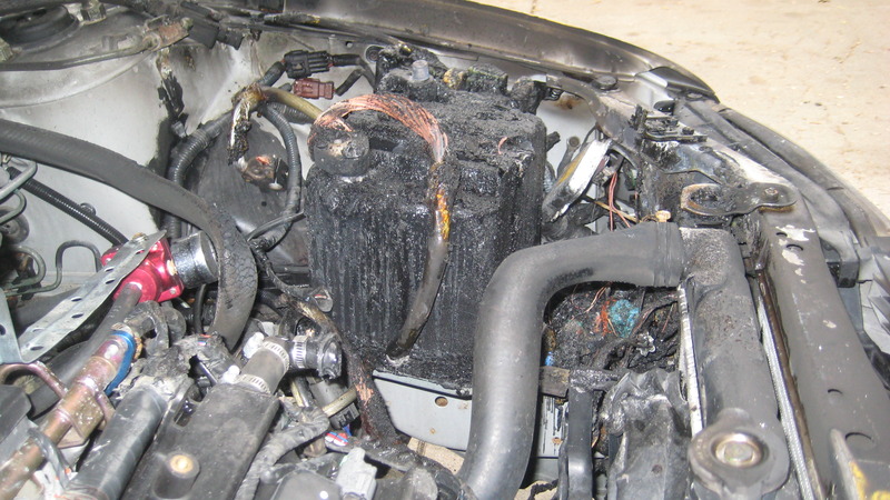

Dam it sure is, cant open the hood neither so I yank the rekease cable HELLA HARD and that does it, opens up the hood and there is the fire on the battery and maf sensor and iac tube and radiator is toast, and the fuze box is krispy deep fried. I can fix it.

what the hell? how does it randomly catch on fire? probably the battery?

Damn so your gonna fix what burned and a little body work? Insurance companies will total it sadly.. But I mean the body looks good! Hate to see good looking cars go to waste when it needs little stuff to be done.. See it all the time!

Oh... man sorry to see this, really the part is you and the car are ok, and it can be fixed with patience and jy parts and some amounts of cash. I find it odd that your car resembles the screen name, that name was bad change it. The harness check with the local jy and the fuses and the radiator and the headlight sockets and ect. Sorry for the loss get it patched up run her again.

Does it look like the battery posts shorted out on the hood?
Old May 5, 2015 | 07:20 AM
Maximeltman's Avatar
Joined: Jun 2004
Posts: 2,695
IDK man. The insulation that attaches to the hood was all burned on that side.

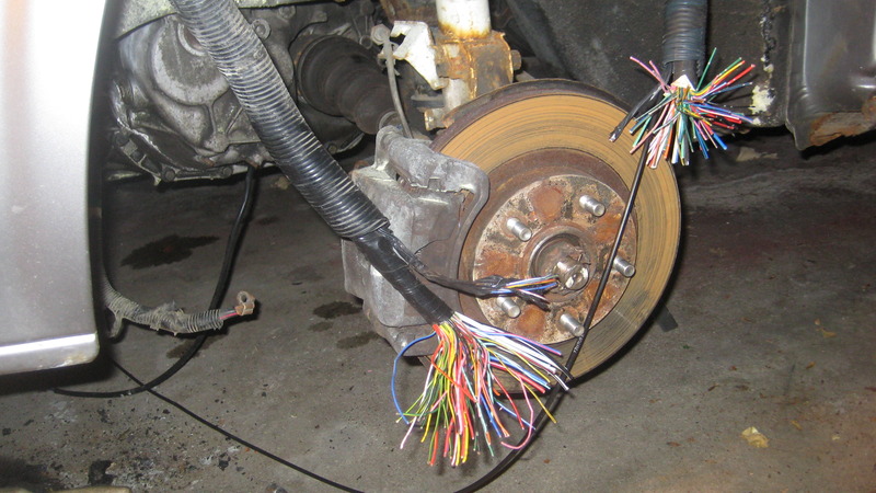

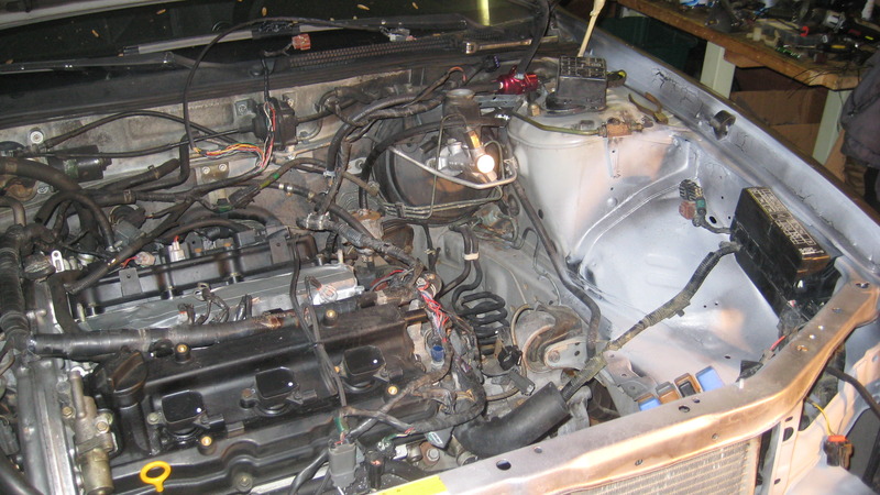

I stripped much of the wiring down today after work and came to find out that many of the wires in the big looms are the same color. It would be much simpler if each wire was different color but no such luck of course. mainly the loom going to the left wheel well so the body control loom. That is a ton of soldering.
The clutch master cylinder is kinda melted as well. I don't know what to do here boys. Total it or try to fix. The engine is less than 1500 miles has HR cams and pistons arp bolts all around. And I sold my cherry picker a month ago.
I'm gonna try to fix it. If anyone has any idea on the BCM loom wires being the same colors and trying to connect them without screwing it all up please chime in.

I was able to go to the junkyard finaly and get replacement harness, I needed the whole harness that goes from passenger side to driver side via over the radiator.
My original car is a 99 mt, the donor harness came from a 98 auto.
The 99 mt had a clutch interlock relay, and the auto has a clutch inhibitor relay.
I did a bit of searching and some say they are the same thing, but idk for certain.
Can someone please chime in on this?
Can I just use the clutch inhibitor relay on the manual transmission that normally has the interlock?

The new harness has a few more wires where I was going to solder it in under the driver wheel well. Particularly green/orange and green/yellow variety. I'm kind of hesitant because if I solder them in wrong what will that do?

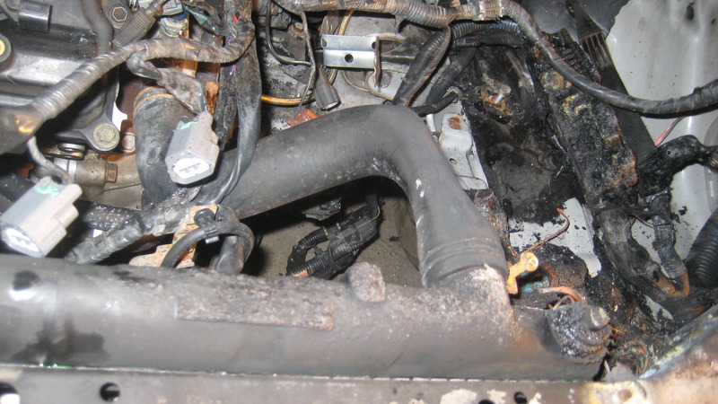

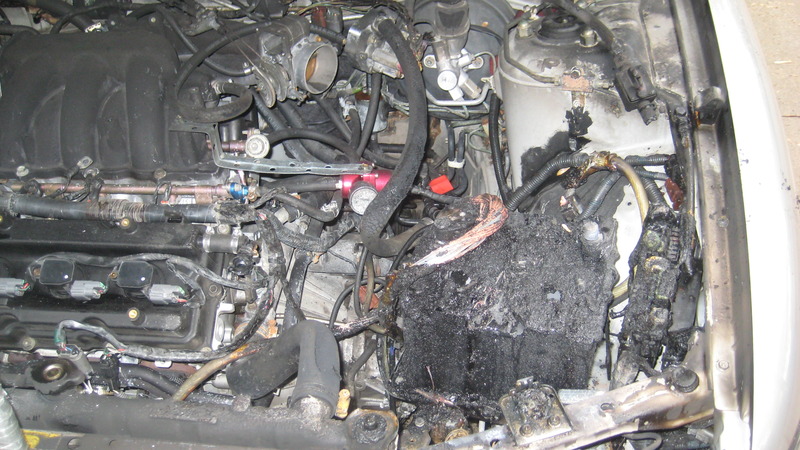

more karnage
cleaned up a bit 'new' auto harness in

I think I see your problem. The second pic in your OP looks like the positive batter cable comes up the side of your battery and loops back. I suspect the cable contacted the hood and wore through the insulation, causing a dead short of what ever your cranking amps was.
Old May 20, 2015 | 06:28 AM
Joined: Jun 2004
Posts: 2,695
That's pretty good detective work but no. That 0ga cable was well taken care of and its rubber insulation never wore out but I think that the intense heat from the fire caused it to fray out like you see in that first or second pic. The hood release cable did the same thing, it was so hot it literally started snapping apart I'm very lucky that I was able to pop the hood with it before it snapped completely, I'm sure that the FD would have had to been called.

Do you have an hid kit? Xentec in particular? If so was ur ballast touching the battery in any way? And xentec hid kits have been known for electrical fires
Btw 98-99 engine harness is diff, a 98 harness pin outs are completely diff from a 99, they are not interchangeable

Yea I been using that 95 ecu for almost two years so it's been re-pinned on the cps and cam sensor, whatever I did, it was so long ago lol!
I got a complete new harness. Been looking at the Haynes circuits charts comparing the 98 mt with the 99 mt, and looks like the main difference is the theft warning relay that's on the 95-98, the 99 dont have the theft warning relay. So in short I could bypass said relay and connect this brown/white wire that comes from fuse 33 to the green/black wire on the clutch interlock. I haven't seen anything else that needs to be rewired. If I'm missing anything chime in.

This is werking now I;ve been dippin around nicely. No way was I gonna let Maxine be torn apart and stripped down for parts. The clutch cant even handle the power in first gear. Gonna do brakes and clutch next. I;m just very happy it all works. On a 98 harness.
