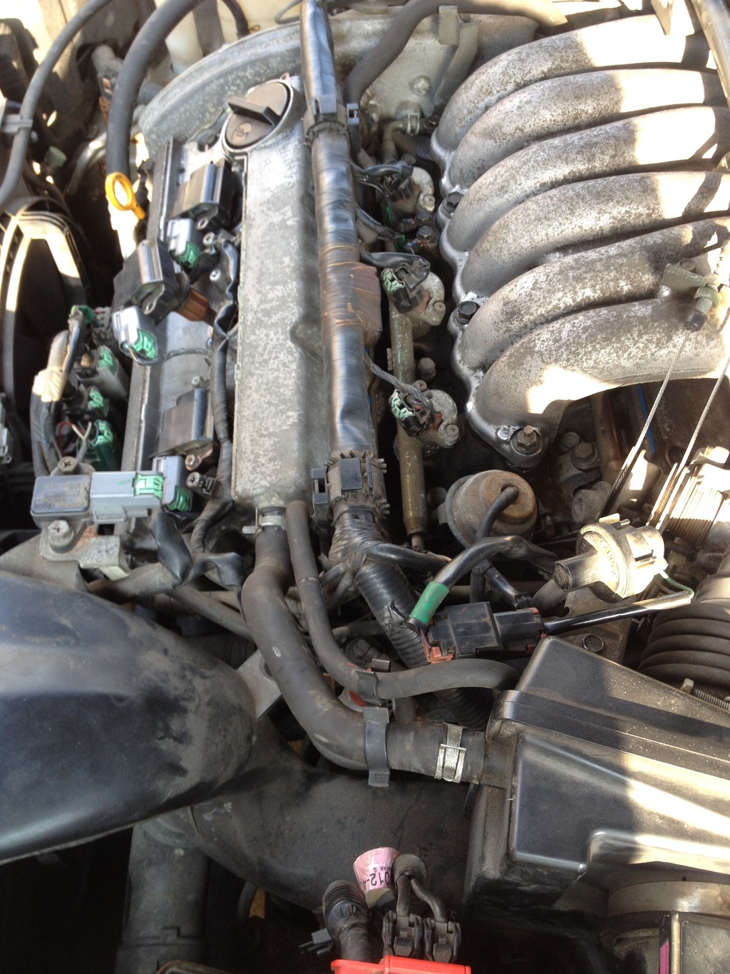

All right I just bought 99 nissan maxima. its got misfire so codes are p0300 and p0355. So there are couple issues. I am not sure if it is exhaust or intake manifold from on the top. Here the picture.
I was trying to find 3 more ignition coils but I don't know where is it. Is it under exhaust/intake manifold?
There is oil leak from exhaust/intake manifold. I just check valve cover and its sealed. How its possible oil leak from exhaust/intake manifold?
Old Jul 12, 2015 | 10:16 AM
Fakie J Farkerton's Avatar
iTrader: (51)
Joined: Apr 2012
Posts: 5,189
From: KCK
Originally Posted by yippzter
All right I just bought 99 nissan maxima. its got misfire so codes are p0300 and p0355. So there are couple issues. I am not sure if it is exhaust or intake manifold from on the top. Here the picture. I was trying to find 3 more ignition coils but I don't know where is it. Is it under exhaust/intake manifold? There is oil leak from exhaust/intake manifold. I just check valve cover and its sealed. How its possible oil leak from exhaust/intake manifold?
Next time post this up in the "I'm new here" section found in the stickies instead of thread jacking someone else's thread.
That being said, that's your upper intake manifold, and the gasket is probably just old and worn out.
Not a big issue unless you have a vacuum leak there.
All 6 coils are accessible without removing anything major.
The front 3 are under the plastic cover.
Just a few Hex head screws holding that in.
The rear coils are in the back between the UIM near the firewall, but still on top of the engine.
Have you ever seen an exhaust manifold on top of an engine?
Old Jul 12, 2015 | 11:50 AM
DennisMik's Avatar
Posts: 10,644
From: Plano, TX
