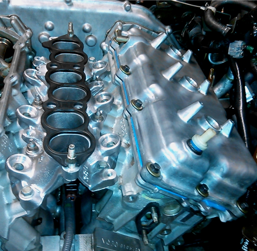

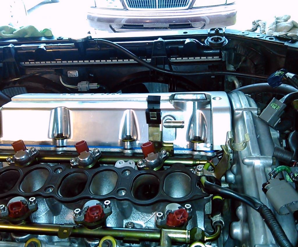

+1 for AdvanceAuto Felpro here. If you order online use the TRT30 coupon code for 30% off on orders over $50. Every gasket in the pictures are by Felpro.

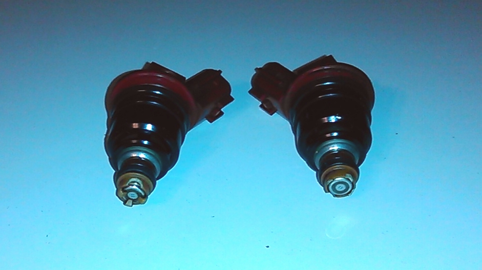

We're seeing cases of injector pintle caps and o-rings that deteriorate with age. Basically leaking injectors cause uncontrollable flooding and it will cook your cats. So it is a good idea to get the injectors serviced with new screens, o-rings, and pintle caps when you have the UIM removed for Valve Covers or other gaskets.

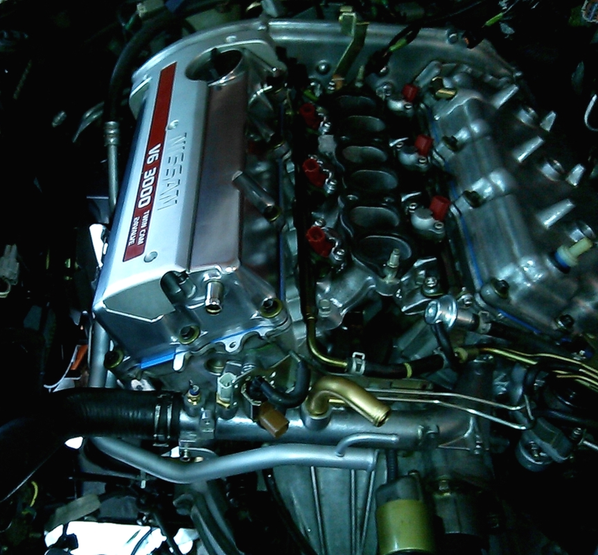

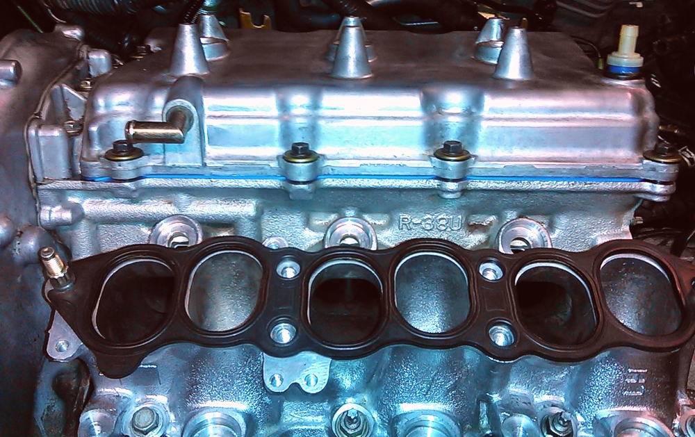

You may want to replace the injector cap and Fuel Pressure Regulator (FPR) brass Phillips head screws with some Socket Head Cap Screws
Injector Caps and the Fuel Pressure Regulator use M5 (size) 0.8 (pitch) x 16mm (length) with M5 lock washers.
I get Hillman Stainless Socket Head Screws from Lowe's or Ace Hardware.
I replaced all of the Phillips head screws associated with the fuel system in the picture below.
For my 4th gens, I actually like the Nissan (spring loaded) hose clamps. I've never had a problem with that type of clamp. However, I don't like the band type clamp that is on the Power Steering reservoir. I've replaced a number of those Nissan band type with shielded worm type that I get from NAPA.
