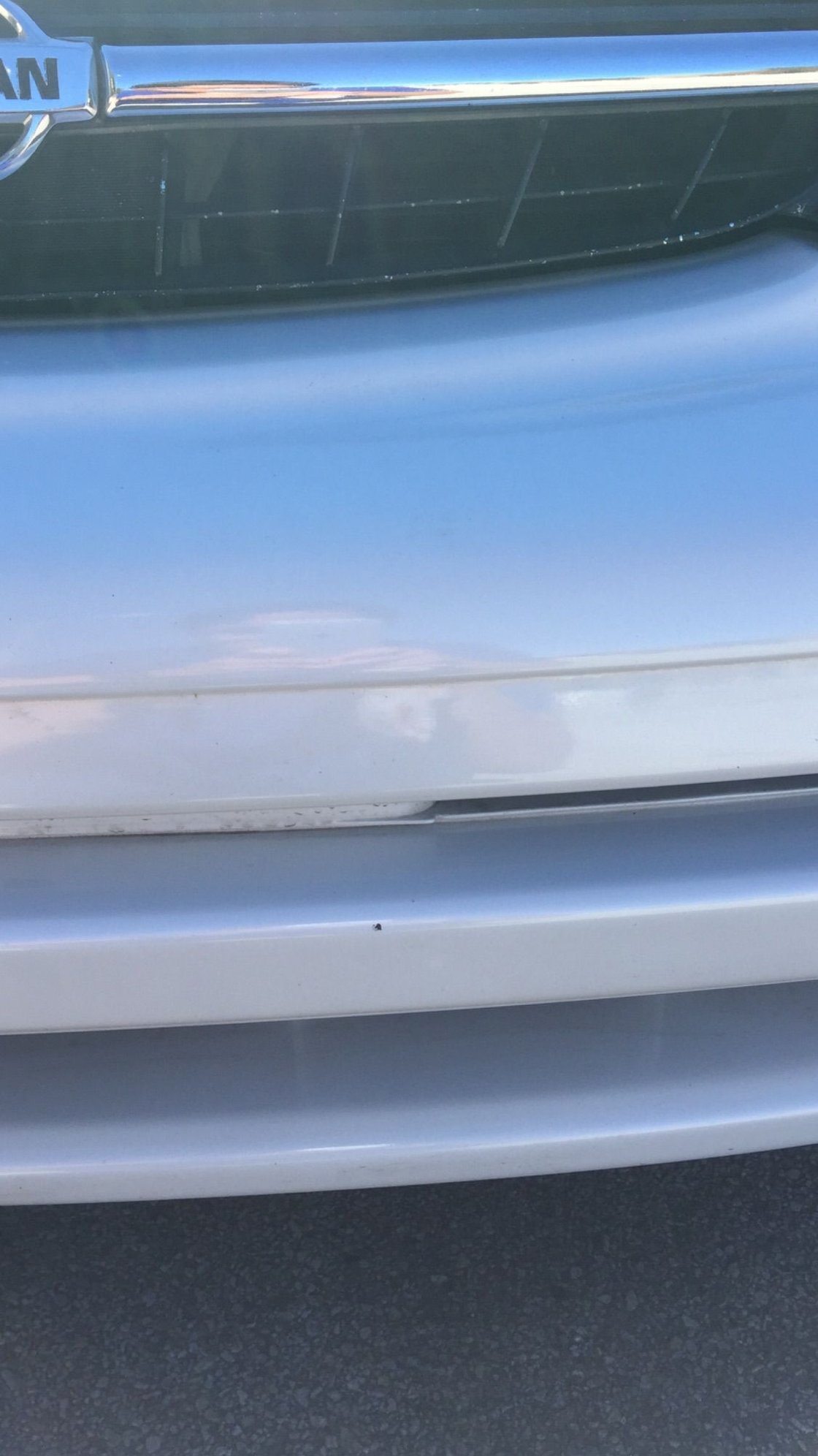

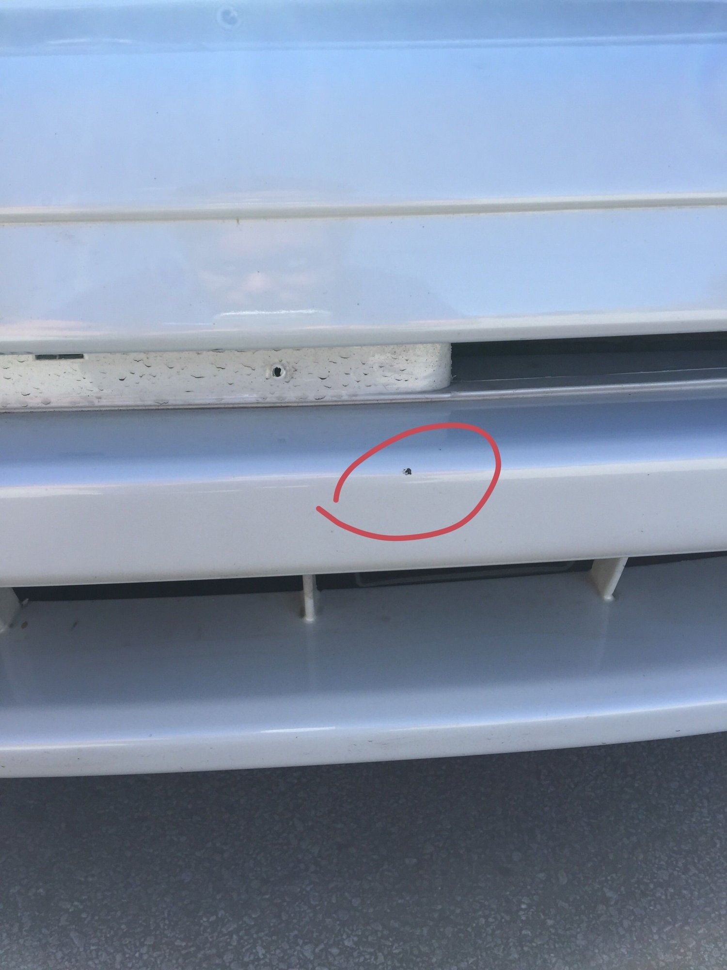

Well washing the car today after 2 weeks of cold weather and a lot of rain, not being able to wash the car.. I use fiber cloth towels to wipe the excess water left on it gently.
Well gently on my front bumper, as I was drying it out with the fiber towel.. small chip of the paint came off, I was a bit disappointed but it happens.
Would a paint chip repair shop be able to blend in the paint to make it less noticeable?
What are your experiences with paint chip repairs?
The paint chip is black.
If I were to have it repaired professionally, would it blend in good (not perfect) but less noticeable?

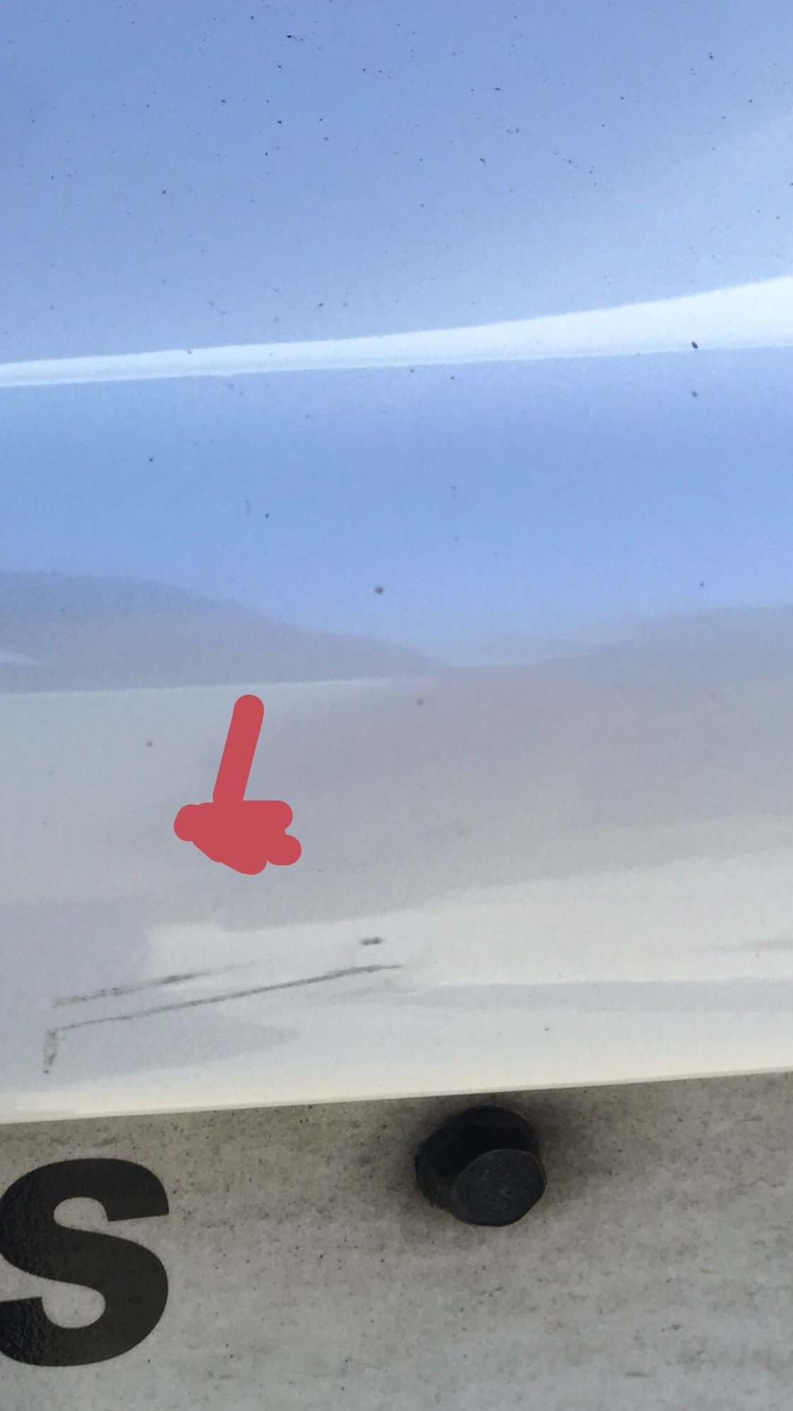

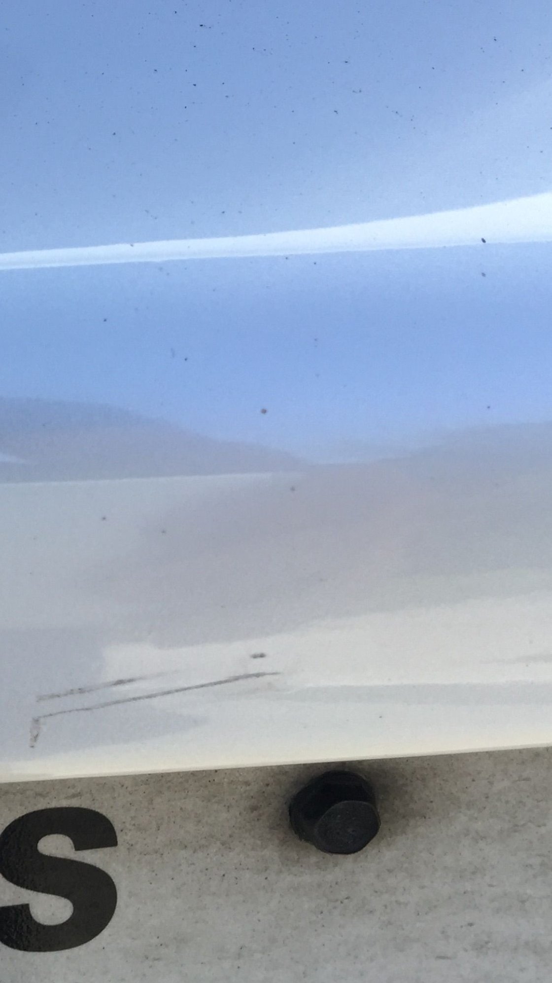

I look on my rear bumper, i have a scratch, though it's not black, more of a clear scratch.. what could I do about this one?

first off, whens the last time you clayed and waxed the car? the paint looks dry as hell, i know i detail my maxy all the time and she never looks like that. 3m compound for light scratches, clay, then meguiar's liquid gold and then get a liquid spray wax like lucas to keep the shine. can't expect the finish to hold up just washing her.

Try to compound the scratch out of the rear bumper, put a drop of touch up on the front chip.

yeah, 3m compound it after you wash it real good, then for the front you use touch up paint, put some on, then wipe off the edges, then apply some more so it's nice and thick. i've also put blue tape around the edges and wet sanded with 2000 grit and applied some clear coat. it takes a day or 2 to do these steps, so don't rush it. let the touch up paint dry overnight and do the same with the clear, you can wet sand the clear if it looks cloudy or too thick, then wax over it.
