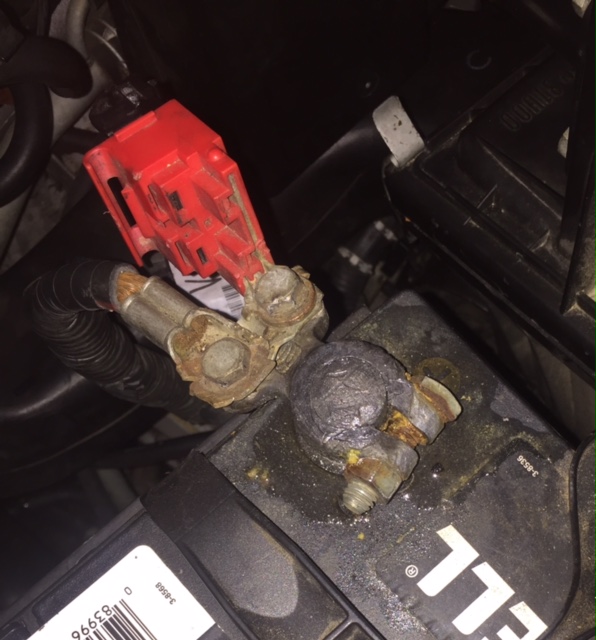

Thanks for reply guys. I had the ignition switch replaced not long ago and the starter and solenoid are one piece on this 98, so all of those should be working fine. The battery issue is very odd, I will check the connections although everything looks clean and this problem only started after I put in the new starter. Several years ago, I added about 3 addition grounds around the engine bay. I will go back and clean all connections though and see what that might do.

Thanks for all the help guys, too let this thread RIP. The two hot connections coming into the hot battery terminal were both a tad loose for whatever reason. I never touched these but maybe they were shaken loose while I was changing the starter around. I drove it around all day today and had zero problems with the hard start, the starter spinning, or any further battery issues.
I had previously taken the car to two different shops to check on the hard start issue within the last year that I felt was fuel related. No one picked up on this loose connection.
