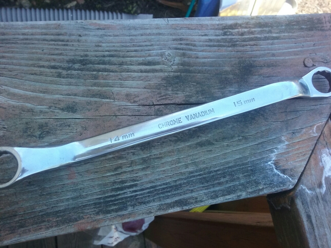

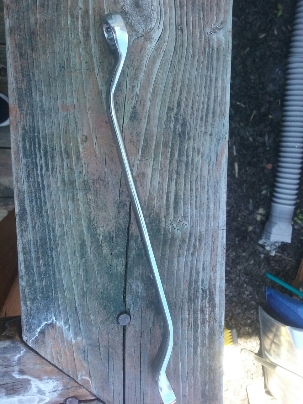

Then your good, if you take off your y pipe its soooo much easier. To get back 2 tranny bolts. Dont forget the 2 bolts on the shift rod

Youe going to need this tool to get the 2 bolts on the bottom and 2 bolts on the rod. Here is what it looks like

Great- thanks for the info and picture! That is where I am right now, trying to get the second bolt off that support rod...
