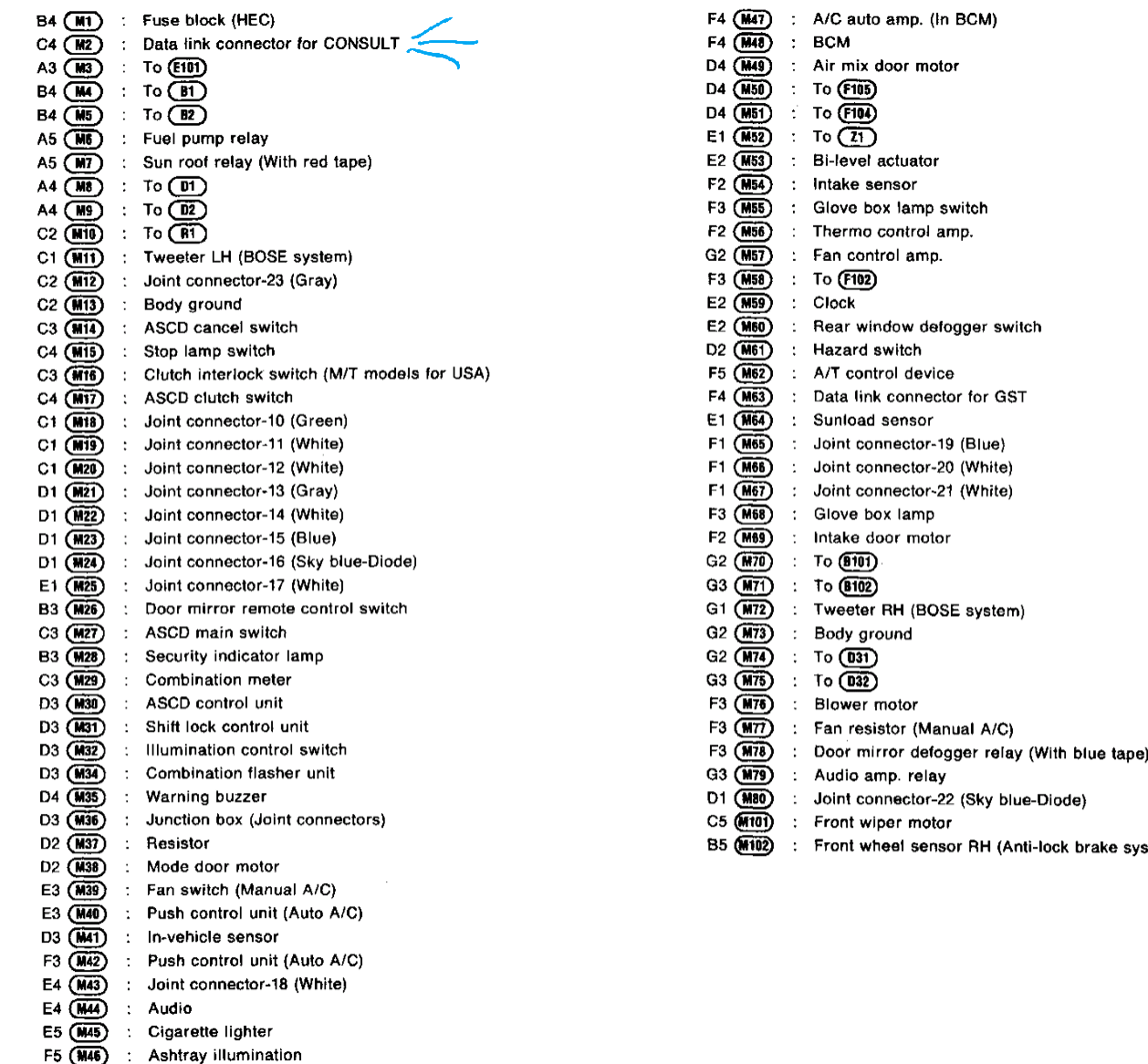

There is no OBD port by the fuse block. The connector by the fuse panel is for the Nissan CONSULT scanner, which is totally different from OBD.

There is no OBD I port in the 1995 Maxima. The only port by the fuse panel is the Nissan CONSULT.
Check that fuse. If an OBD scanner does not see 12 volts on pin 16, the scanner will think it is not connected to anything.

Consult connector in fuse box under side mirror button control.

Yall were right my bad. It looks just like obd1. Its hanging i guess its not where its suppose to be. Ok my thing is everyone has told me 95 is only part obd2 n the scanner will not pull n show u codes. N my scanner is a cheap walmart scanner but its brand new. All it does n show that there is codes but not say which ones. Does a 95 actually show codes on a scanner or no.

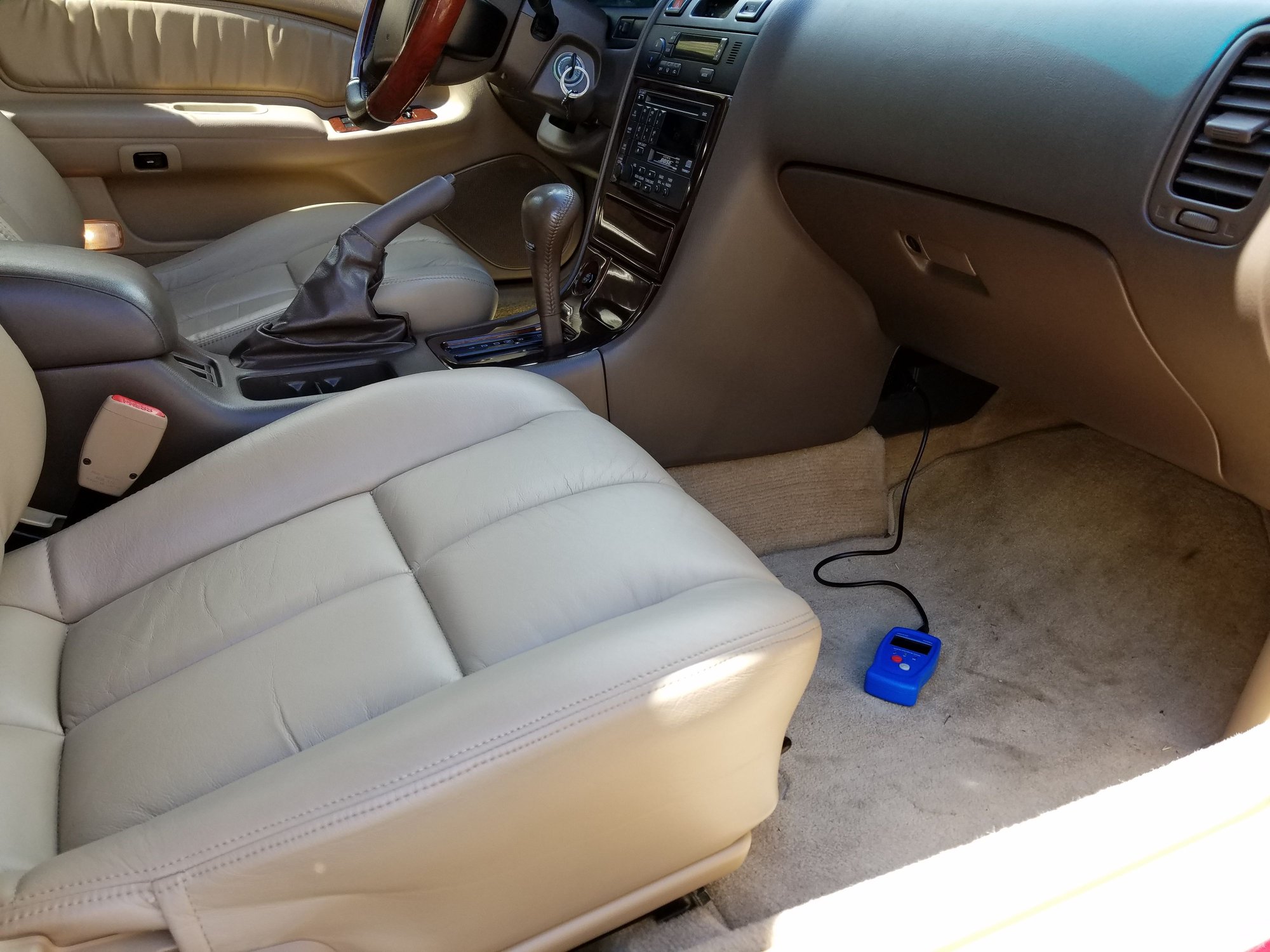

Yes I forget which brand scanner I have but it shows a Pxxxx code. It was $30. Im at work, Ill take a picture and show you what it looks like in a couple hours.
Old Sep 1, 2016 | 10:42 AM
martyl45's Avatar
Joined: Jan 2015
Posts: 90
In my case P0136 is the O2 sensor after the Cat.
