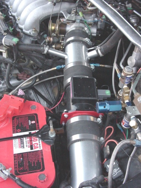

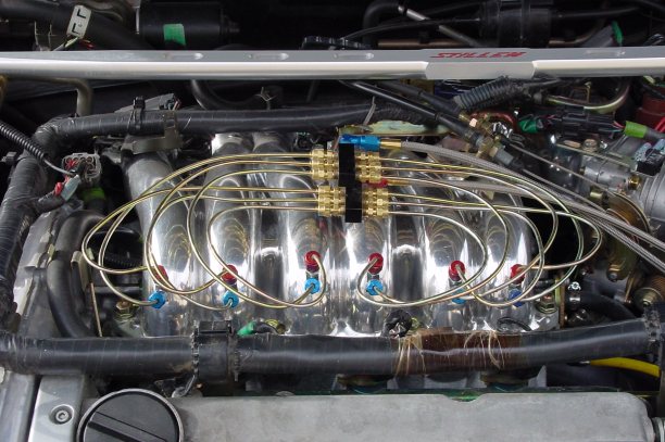

Old Jan 30, 2002 | 09:36 PM
sx7r's Avatar
iTrader: (15)
Joined: Aug 2000
Posts: 1,998
From: TX
hello.
DRY:
WET - DPI:

Old Feb 9, 2002 | 05:34 PM
j_bryan's Avatar
Joined: May 2001
Posts: 1,190
sx7r,
sweet pics of the nos set up!
