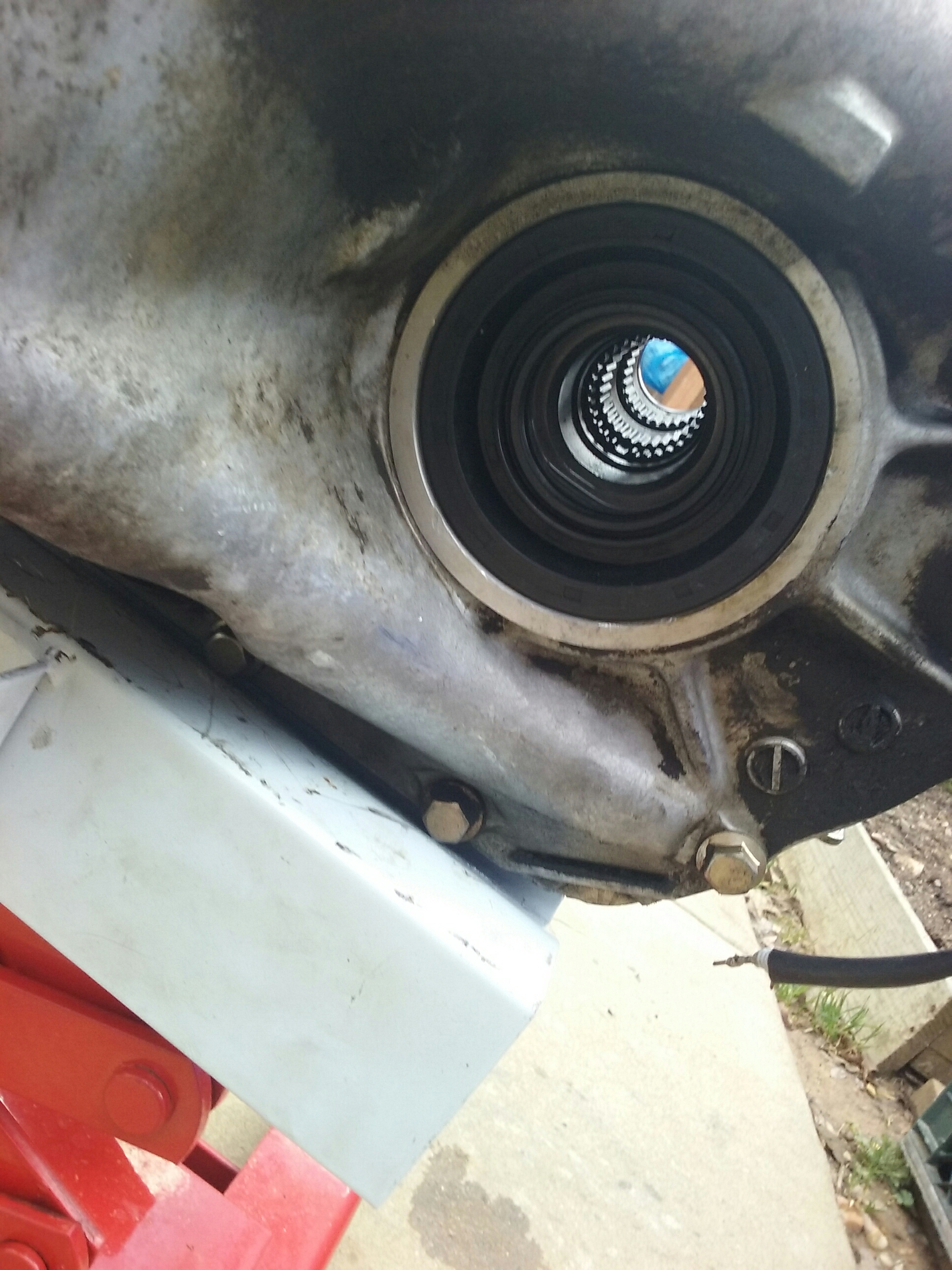

So... I'm running out of ideas. I have replaced the right side output shaft seal 3 times now, I've tried two different brands of aftermarket seal, tried seating the seal both flush with the outside of the diff and all the way to the back of the bore, no difference. It will not stop leaking no matter what I do. I am beginning to think it might be a problem with the axle causing it to not seal properly. I'm leaking about a quart a week, so not too bad, but I would really like to get this fixed. Any advice or ideas? Should I try replacing the axle and bearing next?

Passenger side. Right? What brand of seals have you tried? Does the CV axle look like it was replaced along the way?
Nov 15, 2016 | 11:36 AM
I can't be certain, but it looks to be the original CV axle.
The area of the axle where the seal seats looked smooth and flawless, so I don't see that being a problem
The brands I tried were Duralast and "National seal and bearing"
(By Moog)
I'm confused because it seems like either the axle is too small or the seals are too big, like it just doesn't fit tight enough... idk what's going on

Mine is Auto. Sorry I never specified that. The carrier bearing seemed ok when I took out the axle, it wasn't loose or anything. Also, I have a picture of my axle and seal if it helps anyone:
I assume the axle is pushed in far enough? There is that little 1/4 inch area that has a little more diameter than the rest of the "fatter" part of the axle, it looks like that should be pushed into the seal... I don't see how I could get it in any further though...

The left and right axle seals are not the same. The left seal (driver's) has a 1.535 in opening. The right side (passenger) has a 1.299 in opening. So if you used a left side seal, you will have a leak.
The National, Timken, Autozone part number for the right axle seal is 710124. The Nissan seal is part number 38342-81X01.
Don't be afraid of the dealer. Nissan has lower prices on gaskets than your local auto store. The seal is $12.99 at autozone and $10.02 at the dealer.

I definitely used the correct seal. The left seal is much bigger and wouldn't fit in the right side.
Nov 15, 2016 | 01:51 PM
Is the axle pushed in far enough in the picture? If it's not then that's the problem, and I somehow have moved the center bearing over to the right.

I can't tell from your picture if the shaft has is completely "snapped" into the transmission.
Am I seeing shaft splines sticking out of the seal area?
If yes, then that is a problem. I can show from the pictures that the shaft must be completely mated to the carrier.

Something about the axle doesn't look right.
Here a picture of the axle for an automatic without locking differential.
Here's a picture of the axle for an automatic with locking differential.
As you can see there is an inch difference between the one with locking vs. without.
Has this leak been going on since you purchased the car?
If somebody installed a used shaft from a car with locking on your car that does not have locking, that could explain the inch difference and why I think I'm seeing splines sticking out of the seal area. OR did somebody replace a locking transmission with a transmission without locking and failed to change the CV axle to match?
If you determine that your car has the wrong shaft, I've used CSP shafts from AdvanceAuto on all my 4th gens. I can tell you from experience the passenger side boot on a CSP axle lasts about 5 years before it starts to come apart. Then I get to use the lifetime warranty and replace it. I don't like that part about CSP axles. Strangely, I've never had a boot come apart on the driver side.
IIRC, we had a member on here a few months ago that had a car with the wrong shaft installed that caused some strange problems. Is this the same car?

maybe you have a VLSD tranny. I forget, but one of the axles and seal size changes significantly when you have VLSD.

Well, I think I am going to have to replace the CV axle. It's probably a used axle from a similar car but doesn't quite fit correctly. Probably not a maxima as locking diffs are only available in Canada. Maybe an infiniti?

For the passenger side, I use National Seal Part # 710124 - The same seal works for VLSD or non-VLSD, Automatic or Manual. That's the only seal that I need to keep in stock for the passenger side. It works on all of my 4th gens.
You can see the double lip inside the seal that really does a good job of keeping the transmission lubricant inside the transmission.
http://www.oreillyauto.com/site/c/de...0071&ppt=C0338
I just installed one earlier this week. No leaks.
Are you working by yourself? I have you have a helper, I can share a trick for how I mount the seal on the passenger side.
Can you snap a picture of where the shaft goes into the transmission? I think I can tell by looking if you have the wrong shaft.

My trick for quick passenger side seal installation comes from Lowes.
I get or cut a 5' long piece of 1.5 inch PVC pipe. Then add couplings to both ends. The pipe in the picture is now six years old. I've used it at least six times over the years.
The coupling is a perfect fit over the seal.
I loosen the strut just enough so it can move out of the way so the pipe is in a "straight line" through the carrier bracket to the outside.
Then I hold the coupling against the seal and tell a helper to tap at different clock positions like 12 o-clock, 3 o-clock, etc, until the seal is square with the transmission housing bevel edge. The length of the pipe absorbs the shock from the taps so I won't damage the seal in the process. It seems to take less than 5 minutes to install the seal using this approach. Also, I use some lubricant on the seal outer edge that mates with the transmission housing so I don't risk pinching or scoring the seal rim during installation. The lubricant helps the seal glide into place and it doesn't leak afterward.
At some point, all of my three children have helped me tap a passenger side seal into place. They all like to help and this is an easy task. So they all know about installing seals and the PVC pipe trick.
The seal and axle look like this picture when I'm done.
