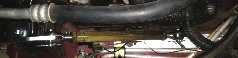

This afternoon I installed a NWP Engine Torque Link on the 98 GLE automatic. Installation was quick and easy. NWP does a "first class" job on packaging and instructions for this product.
I've been running a NWP torque bar on the 99 SE 5-MT for 3 years. It really provides a nice tight feel and practically eliminates any engine rock during during take off and downshifting.
For the 98 model GLE automatic, it gives a more direct feel and eliminated some of the sloppy feeling that comes from engine movement with an automatic. I now feel more connected to the engine when driving -- like it has a little more torque. Any wheel hop that it had before the installation is now unnoticeable.
The engine mounts are in very good shape on both cars. By reducing engine rock, I believe these torque links help extend the life of engine mounts.
Here's a picture below.

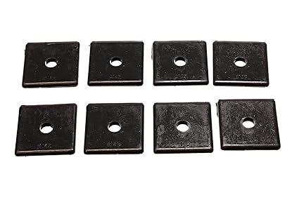

I already had a package of Energy Suspension 9.9533G Leaf Spring Pad, 7/16" I.D x 1/4" Height pads from some sub-frame experimentation last month. I decided to trim one of the pads and use is as a bushing between the engine mount and the torque link. Here's a picture of the ES 9.9533G pads. It only takes one.

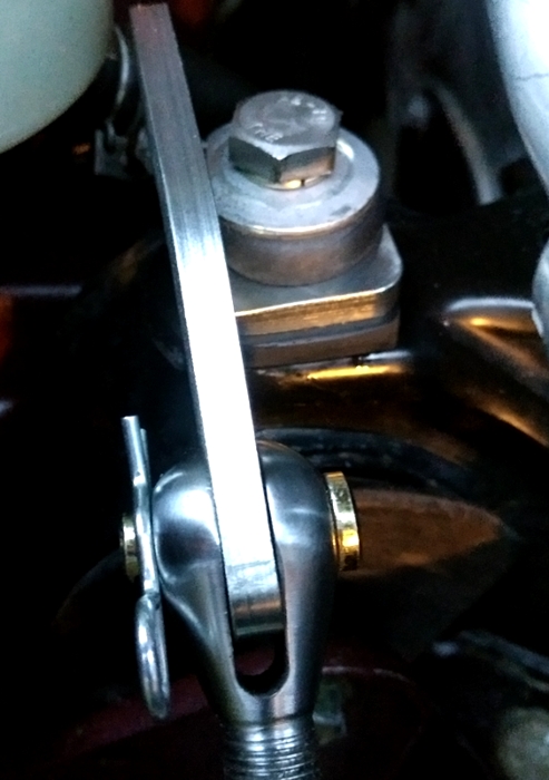

Next I used the metal cap part of an Energy Suspension anti-sway bar end link kit with an end link bushing.
Here's how it looks with the pad and the end link bushing. Note that I filed down one side of the end link cap so that it would not touch the torque link bracket. The bolt is roughly 1" longer than the standard bolt that comes with the kit. I found a stainless steel bolt with the same thread pitch in the Hillman Fastener section of my local Ace Hardware store.
The torque link still does its job just fine. It just works to cancel any engine noise transfers to the body.
Note that I am NOT using an ES end link bushing on the top. This was a bushing that came along with some MOOG end links that I bought several years ago.
Since this has worked out so well, I may try it with an ES bushing to both upper and lower will be using the same material that should last for many years.

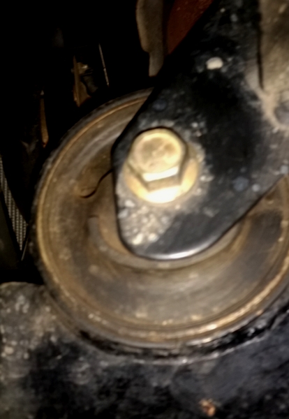

Here's a picture of an engine mount that has "Made in Taiwan" stamped on the top that I know has been running on the 99 model SE 5-MT for over 4 years, possibly 5 or more. The car is primarily driven in town.
This mount has at least 50,000 miles with a young aggressive driver. I still believe that running a NWP torque link lets me run low cost engine mounts for many years without issue.

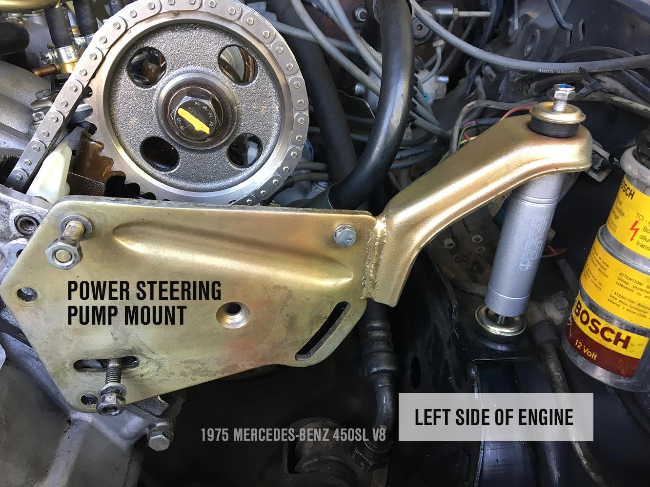

I got the idea for using the end link bushing and cap from a old Mercedes 450SL engine stabilizer mount that uses the same principle to keep the engine from rocking under load. So this isn't a new idea by any means. The NWP link is a simpler and more effective solution in my opinion.

I hand tighten it. Then I use a wrench on the long center part and give it about 1/4 of a turn. It's based on feel. Once I get the inner part set, then I tighten the end nuts so it will lock down. It tightens up like the video. It's easy to get it adjusted. I found the video to be very helpful and the NWP installation instructions are spot on.
