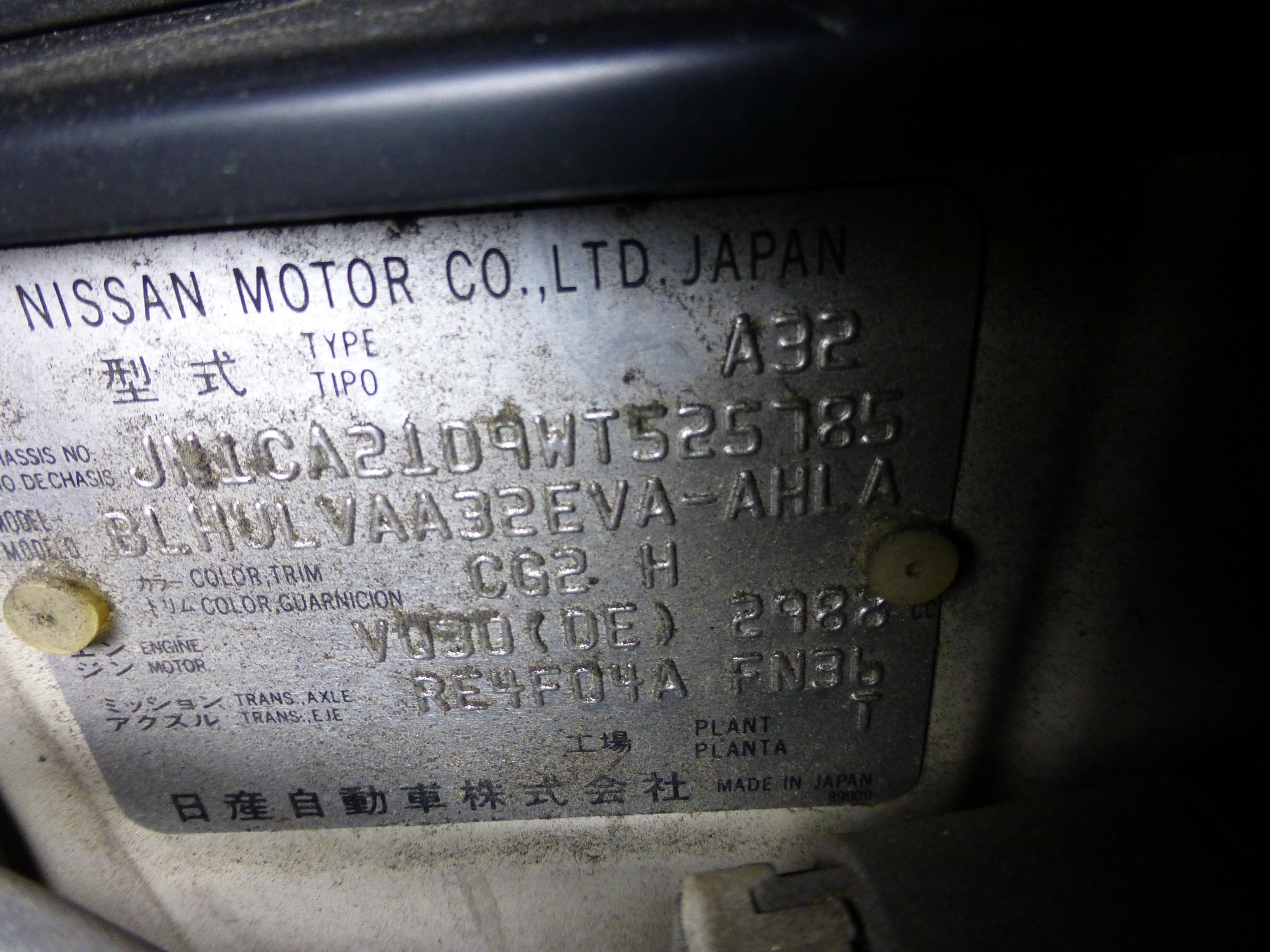

Here's a thread on how to determine LSD (locking) vs. non-locking.
When you add the item to the shopping cart it shows the warranty.
https://maxima.org/forums/4th-genera...sd-no-lsd.html
Old Dec 11, 2016 | 06:30 PM
reallywildstuff's Avatar
Joined: Mar 2014
Posts: 636
From: Planet Houston
Originally Posted by maximaham
autozone says limited warranty/ do i need locking or non locking
Do you have a limited-slip differential, or not?
Locking = limited slip diff
Non-locking = open diff

Ok so i jack the front of the car up. Stun one wheel one way and the opposite wheel turned in the other direction. So that means i do not have limited slip. I have open differential

I would check the plate in this post from asand1.
https://maxima.org/forums/4th-genera...ml#post9127101
Also, if you are replacing the passenger side, check out this post.
https://maxima.org/forums/4th-genera...ml#post9131498
The axles for a LSD transmission have a double set of transmission splines. Non-LSD has a single set. It's an easy thing to check at a store before you leave with the wrong axle.

Ok so i have open/non locking dif. Does it matter if the new axle i purchase is abs or non abs. just wondering my maxima is non abs.
It doesn't. Every replacement axle that I've purchased has come with the ABS sensor ring. However, only one out of four 4th gens came with ABS. They all worked on the non-ABS cars. I think on my first axle replacement job, I took a chisel and snapped off the ABS ring. Then I realized it didn't matter and left the ring in place.
