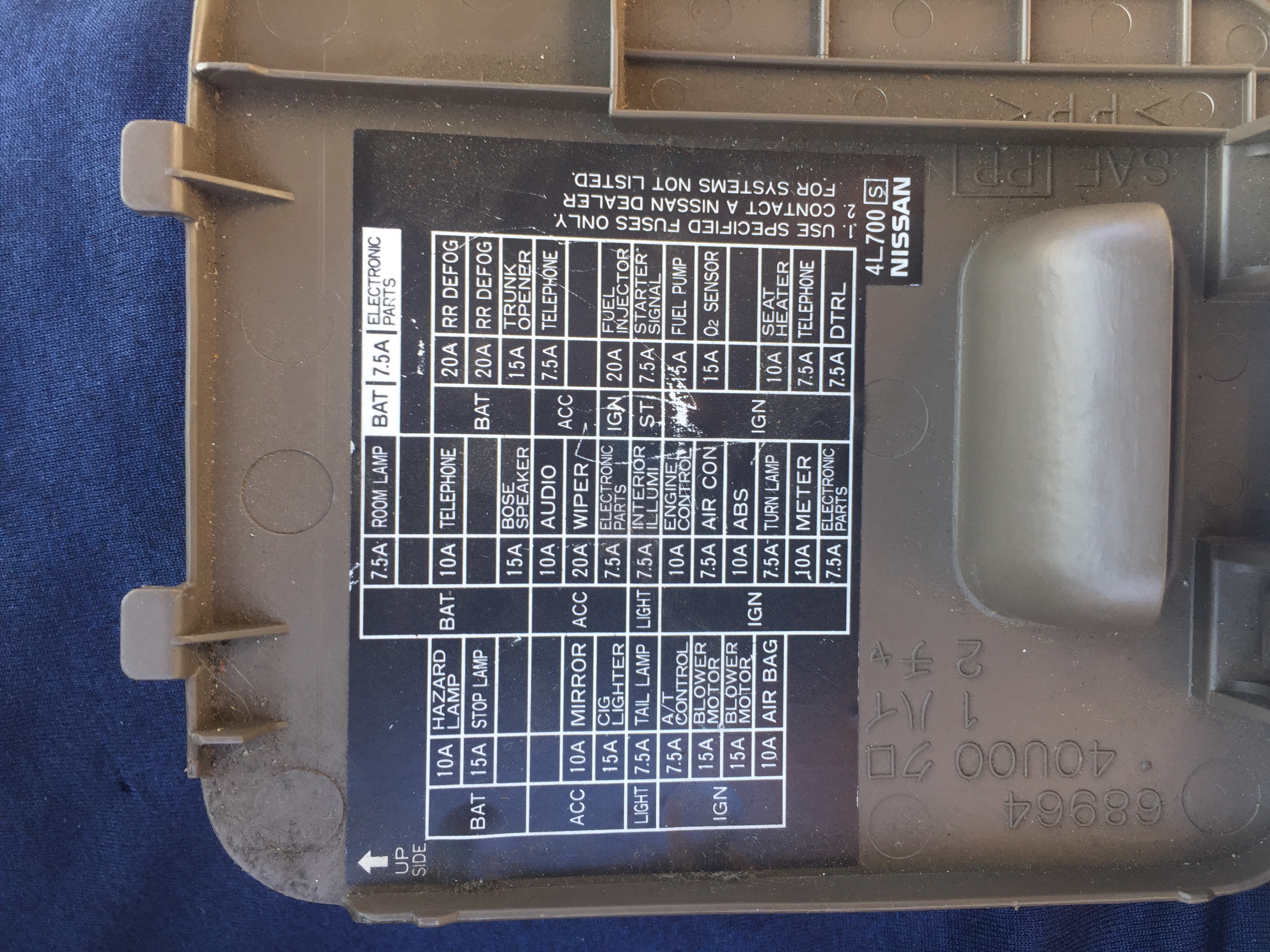

So I noticed driving home last night at 9pm I couldn't see how fast I was driving or any of the lights on my dashboard , even after I turned on my lights (as well as brights . I made sure the light dimmer was turned all the way up , still nothing . I seen that a fuse might of gone out , but where would it be located at , and what size fuse ? Is it the fuse location under neath the steering wheel column or the one underneath the hood ??

I'd guess it is the fuse box located inside the car, but if you open both fuse boxes, and look on the cover, it will tell what each fuse protects, and how many amps it is.

Nothing specific underneath the steering wheel column , it had "Interior Illumi" and I replaced that (7.5A mini) and still nothing . Everything else in the car is fine just the dashboard lights won't come on !

Fuses # 13 & 18 are used for the dash lights and are in the dashboard fuse panel.
Fuse # 13 is in the center column, second from the bottom. The label is METER.
Fuse # 18 is in the center column, 7th from the bottom. The label is INTERIOR ILLUM.
If you have lights in the heater controls and window stitches, fuse # 18 is OK.
