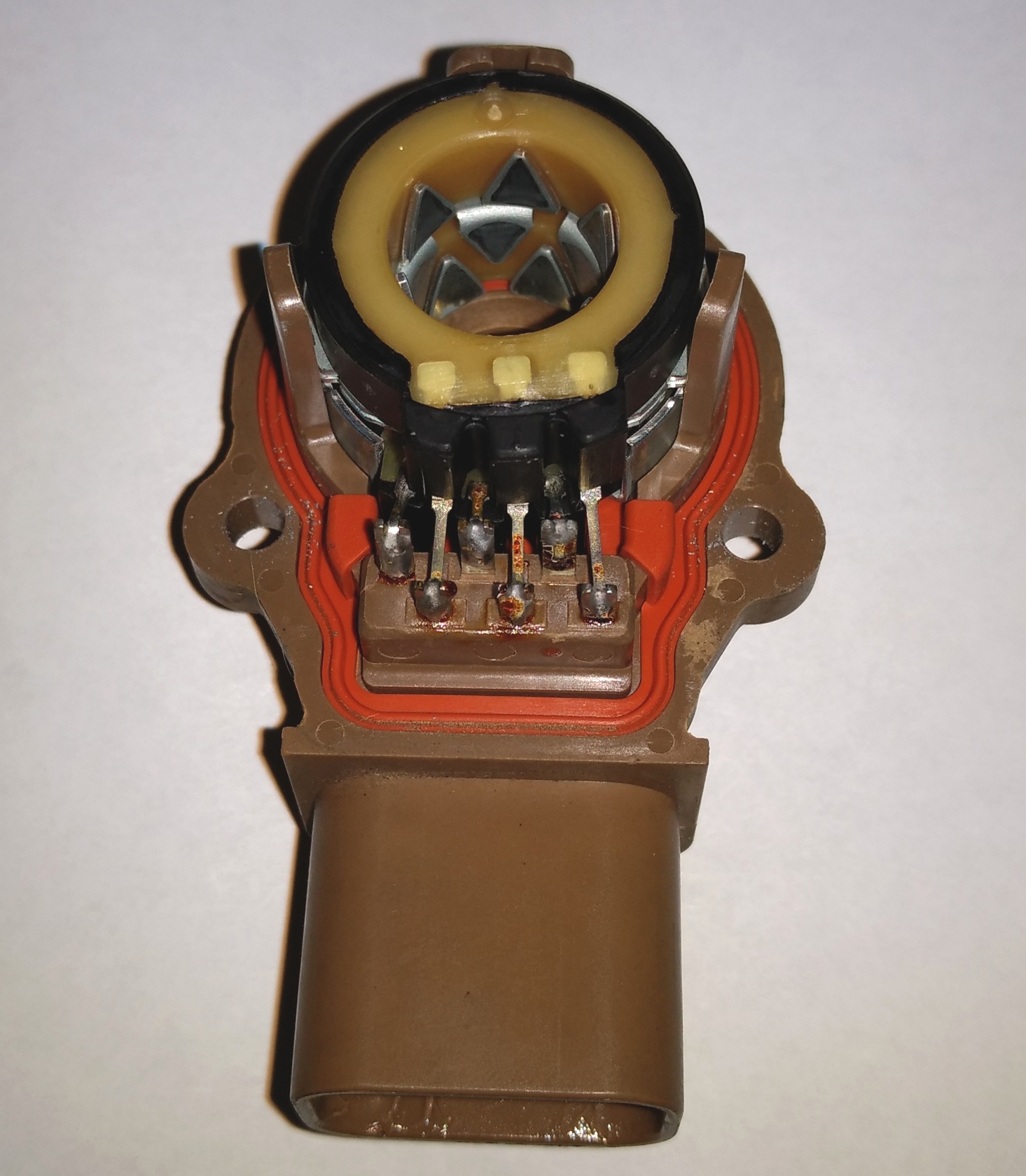

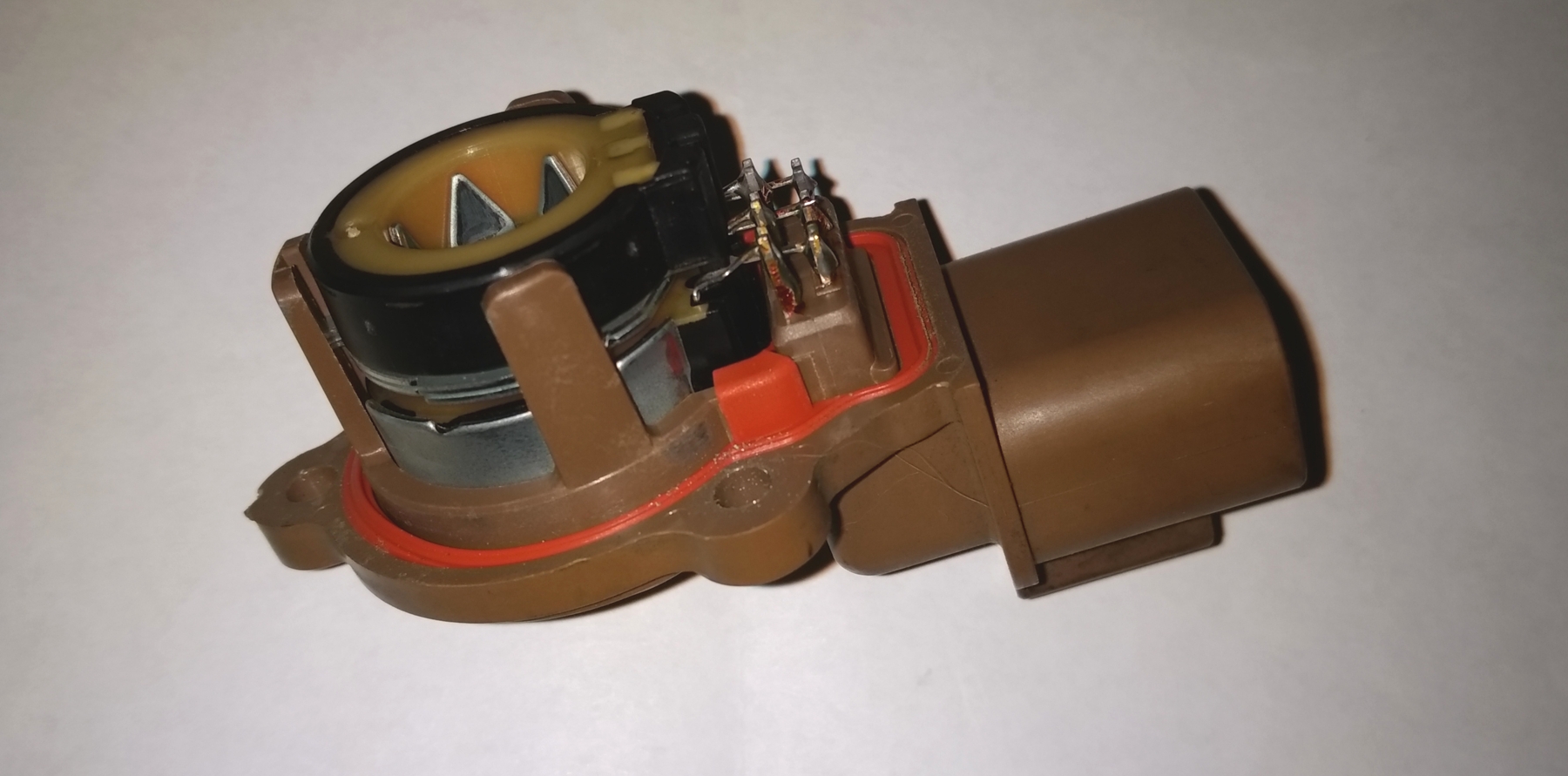

Long embarrassing story short, while removing UIM had a slip and broke some of the plastic on the tan part of the IACV. No junkyards around have maximas and I'd like to save the $50 and salvage this. Before I go JB welding it back together I want to make sure I have all the connections aligned how they were and none got bent out of place.
so if someone could remove theirs to take a cpl good pictures at the right angle so I can use it as a guide, it's the tan piece held on by 3screws and I'd be extremely grateful
in the last pic the pin on the right is bent back a little bit I assume it's supposed to be the same as the others

Here you go. There is a spring the drops into the center of the stepper motor.

Thank you so much exactly what i needed. That's what I was missing, when i actually separated mine the black plastic piece and a washer stayed with the rest of the iacv, pulled it out with pliers and lined it up seems like the long 3 prongs on it should be soldered not just touching so i'll solder those and jb weld the plastic and hopefully it will still work. Thanks again
