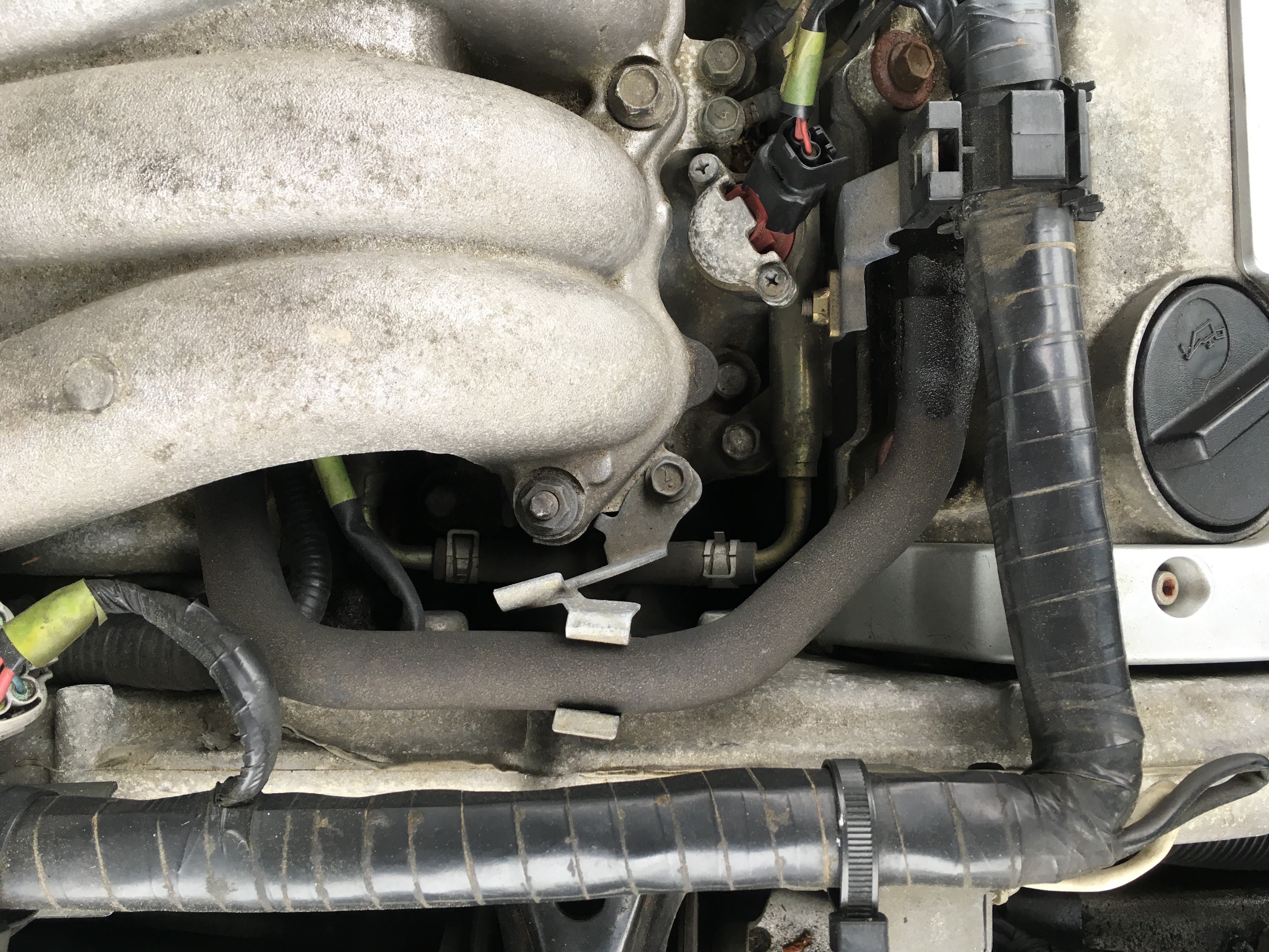

I saw this cracked and leaking hose when I was replacing my fuel filter. Gawd this car is showing its age.
Planning on light driving in the next two weeks... 5 mile commute to work. Should I leave her sit while I wait for a replacement part?
How hard is it to replace this hose? Looks pretty easy but looks can be deceiving...

Hose just pulls off. Last one I replaced I think I used reg. coolant heater hose. I believe it is just a breather hose between valve covers.

Ah. So it probably isn't impacting performance? It seems to be leaking oil.

This hose your referring to it's a crankcase ventilator hose. It helps to keep the cams cool.

Yes, it is the crankcase ventilation hose. It is used to suck oil vapor fumes out of the engine via the PCV valve.

14 bucks at most online dealers
this is for a 95 but may be same for others
11826-31U00
you can see pic here
https://www.infinitipartsdeal.com/pa...826-31u00.html

Thanks! I'll probably order it.
Could this cause a vacuum leak?

yes on the vacuum leak

These vacuum leaks on this type of vent hoses will effect the motors performance. The improper breathing and cooling won't let your car run right.

Hmmm wonder if I'm blaming my MAF for something that this hose is causing...
Any tricks to replacing this hose? Doesn't even look like it's clamped on.

Also I replaced this hose - only took about 5 minutes, just had to wait for the part to come in. Now to see if it helps after the car starts...
