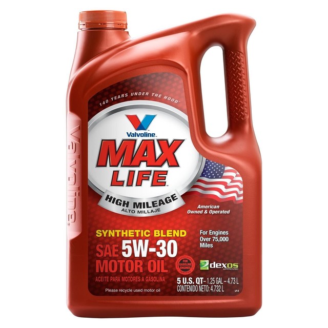

One of my vehicles is a Honda 3.5L V6 with the chronic rear main seal leak problem. Basically, rear main seals start leaking just over 60,000 miles. So when the last seal started leaking, and Honda didn't want to help with replacement, I tried using Valvoline Max Life Syn-blend. It slowed the leak to a level that I can live with. I no longer leave an oil slick in someone's driveway when I visit.
One of my friends is a fleet tech for a HCAV company with roughly 16 trucks. So he was having to add a quart of oil each week to most all of the trucks. They were purchasing approximately 4 gallons of oil each week to keep the trucks in oil. He switched Valvoline Max-Life Syn-Blend and that cut the oil usage in 1/4.
If you have a leaking main seal, half moon, or o-ring, this product will not completely stop it. However, the seal conditioners have been found to slow an existing leak to a manageable level.
