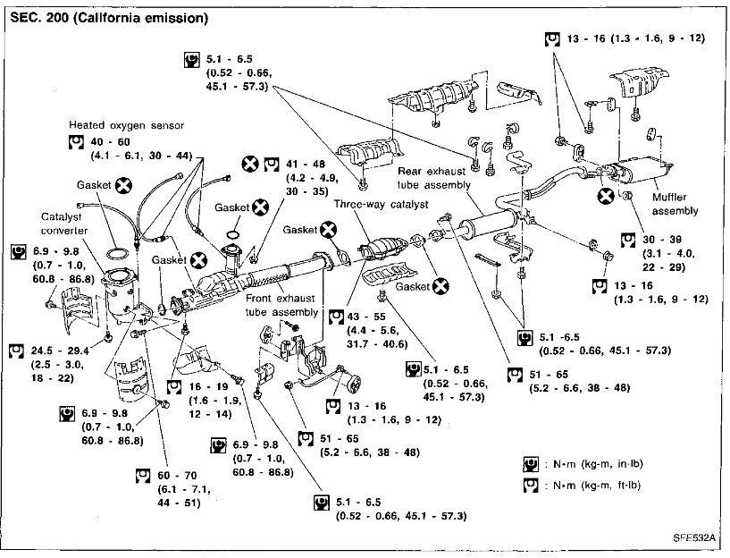

To start, I know I could have a shop do this, but I enjoy tinkering with the car and would like the learning experience. So my exhaust is completely split apart in two spots and I'd like to replace the whole exhaust except for the pipe from the exhaust manifold, cat and connector pipe. I figured to go with a cheap ebay exhaust since it's more of a tinkering project.
Is this everything I would need?
1x Part # 31311 Gasket
1x Part # 608404-1 1st Extension Pipe
1x Part # 608404-2 2nd Extension pipe
1x Part # 790241 Rear Muffler
1x Part # 31576 Gasket
1x Part # 55260 Connector
