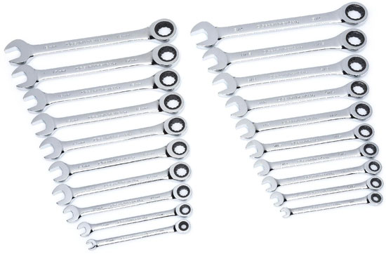

At one time, I thought my ps pump was leaking, so I prepared an attacking plan.
If I were you, I would try to reinstall the locking bolt, #29, 12mm. If this is done, everything else would fall into place. I would do it from the top.
-use rachet-style wrench, duct-taped to a metal bar to a specific length with hope that I can tighten the bolt from the top.
-tape the bolt #29 and washer to the wrench, set in locking direction. No tape, can use a piece of paper.
-use left hand's fingers to guide the bolt into the bracket hole, apply pressure. Right hand attempt to tighten the bolt from the top. Or ask another one for help.
Explore various body's positions to follow your arms' curvature.
Do it by feel
I did not do it since it is not needed but I did some practice/experiment at it.
Good luck!
