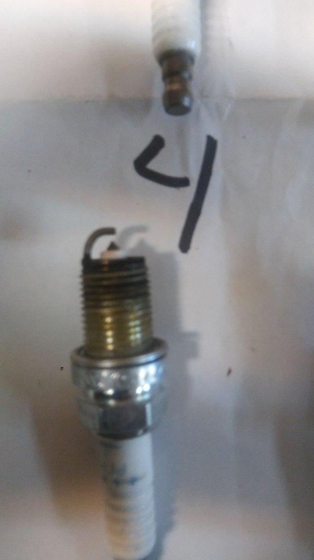

#50
I thought the same thing but it actually is misfiring ...would the computer tell it not to fire because it thought there was an issue?
#52
That is one clean plug.
Looks almost new.
Almost too new. Like it's not firing.
I would compare that plug with one from a cylinder which works properly. Then switch them.
Clear your codes, as Wizard reccomended.
Looks almost new.
