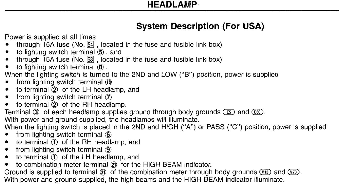

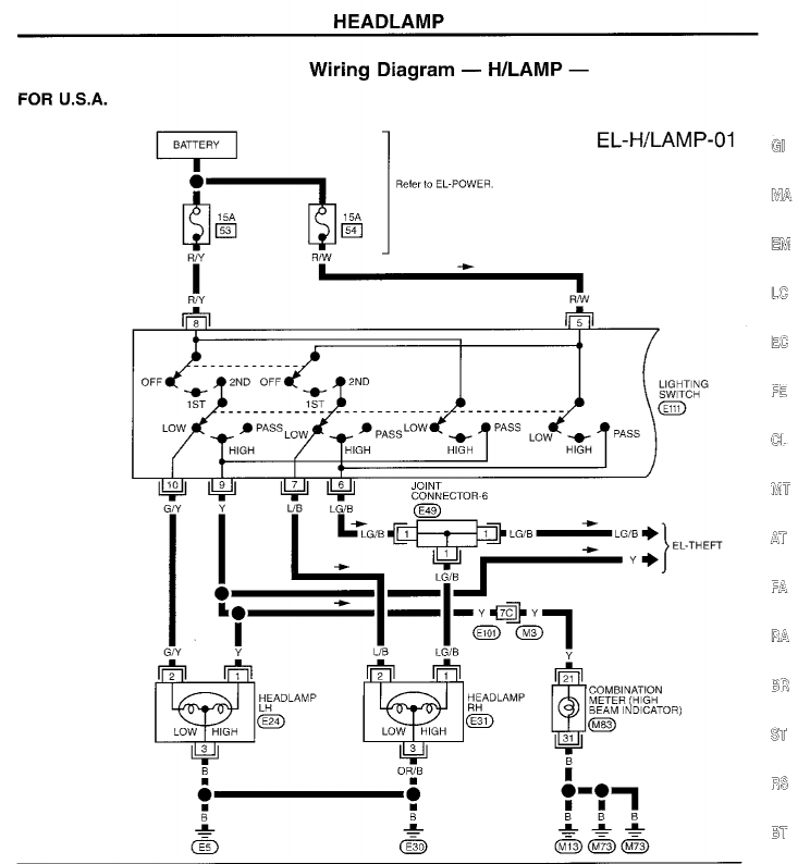

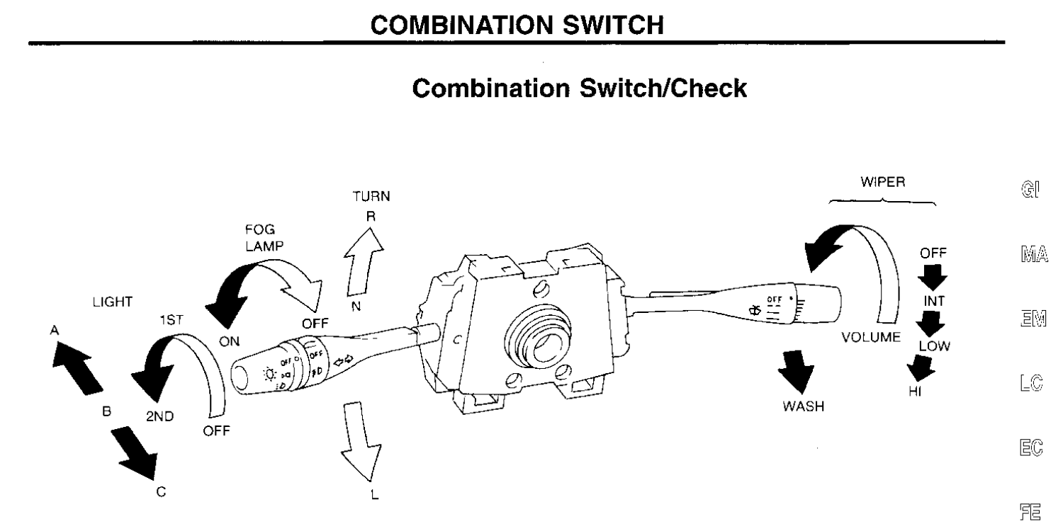

I thought it would make sense for the lights to work in position "C" but not "A" because when holding the switch in the passing mode it powered both the low and high beams, but the FSM seems to disagree with me.
When switching from low to high, does the shield move because it is getting a new power signal (high beam power) telling it to move, or because it is losing a power signal (low beam power) and returning to a default state?

Some projectors handle this differently.
I remember reading something about installing a diode between the hot to High Beam to Hot to Low Beam. Something about the low beam hot turning off when high beam is engaged and the high beam power only moves the shudder.
So to get the low beam hot again, a diode is put in to send the Hot in one direction to the low, but the low can't power the high beam.
Diodes only let electricity travel in one direction, kinda like a one way street.
Which diode, I don't know. Some here know, but it's their business and if they give all their trade secrets, they'd have no job.
