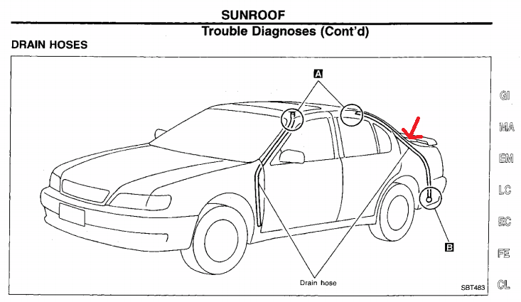

The odd thing with this leak is that it doesn't seem to be coming from an end point of the drain hoses... I've looked at the FSM and it seems like it might be draining into the interior if the sunroof was clogged. Some hose tests I ran a few weeks ago drained appropriately, but I'm going to blow the line out anyway.
You can see where the drain hoses are in this BT-39 diagram; I've made a gaudy red arrow pointing at the approximate location of my leak. PLEASE NOTE: This image does not show the passenger side, and my leak is on the passenger side.

I'm actually curious about that too... All 4 drains were still working; the front passenger side was a littler slower than the others but everything was draining just fine.

I am curious on how to access the top of the drain hoses to blow them out.
Turns out that no one else knows how either:
https://www.nissanforums.com/a32-199...rain-hole.html
https://maxima.org/forums/4th-genera...of-drains.html
Nissan says that you have to remove the headliner (BT-39):
Here are some additional diagrams from BT 35 and 36:
So that sounds a bit painful.
Is the headliner glued in place?
Also an old TSB about the rear drain from one of the old 4th gen stickies: http://www.jatan.net/tsbs/056829.pdf

Old Jan 8, 2019 | 03:16 PM
KP11520's Avatar
Joined: May 2012
Posts: 1,621
From: Long Island
Please detail dropping the headliner!
Old Jan 9, 2019 | 05:08 AM
Turbobink's Avatar
Posts: 2,758
From: Tampa Bay
I'd recommend that you clean that truck sill up real good and check the seal on those plastic trim fastener anchors.
Old Jan 9, 2019 | 06:15 AM
Shrout1's Avatar
Joined: Mar 2015
Posts: 363
From: AL
Piece of cake! :P
Thanks! The gutter area has been thoroughly wiped out (really cleaned it up when we took the rear molding off) and the trim anchors are good everywhere except a tiny bit around the bottom right corner of the trunk. The piece stays in place though and I haven't seen any water come through there, ever.
I think I just have to wait for the next rain storm to see if I got it! I'm hoping it was as simple as that build up of gunk under the rear molding, but we'll find out...
