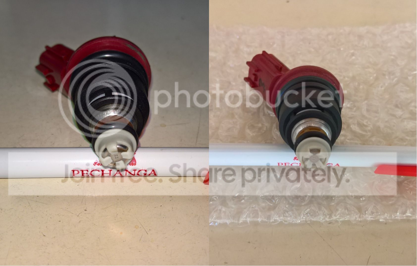

I decided to add in injector servicing on my current list of coming maintenance to-have-done tasks, while I have my new clutch work done (O2 sensors, rear main seal and oil pan gaskets being on the list as well). I picked up a "remanufactured" set of JECS injectors off eBay which looked pretty clean when they showed up (new O-rings and caps) at a good price of around $60. Didn't really trust the quality of an eBay unknown so drove down to RC Injectors (formerly called RC Engineering I think) over the weekend to have them balanced and blueprinted (fair priced at around $28 per injector). I had them send them back to me via mail with a one-day turn around period. Glad I had them serviced before having them installed...
LEFT = Before / RIGHT = After

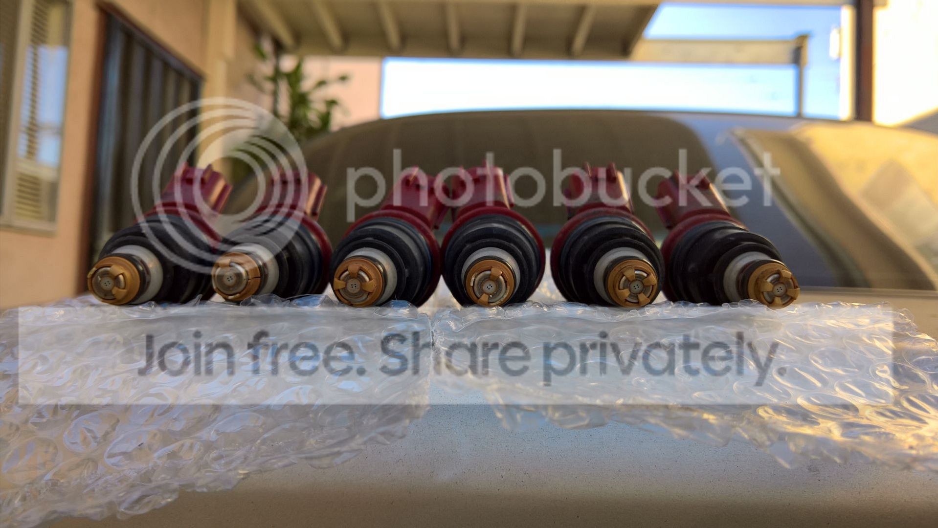

Just a follow up... Finally had a chance to get the balanced injectors installed over the weekend (combined it with clutch work and RMS I had to get done). My 140k mi factory injectors taken out looked like the below... Four with broken pintle caps, and the two other compete ones showing visible cracks on them. Car didn't run too bad with them in this condition, but idle did sometimes get rough after sitting for a short duration.
