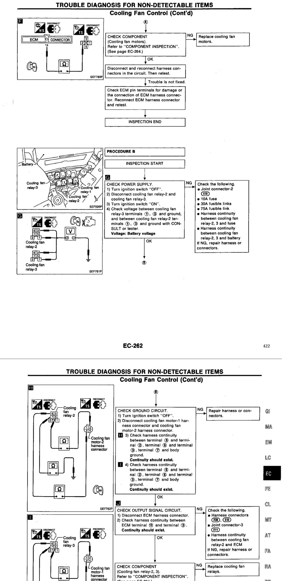

Old Jun 19, 2019 | 03:43 AM
martyl45's Avatar
Joined: Jan 2015
Posts: 90
Old Jun 19, 2019 | 06:01 AM

Download the FSM as martyl45 has done for you above and grab your VOM, 12v power supply and non-contact infrared temp reader and start crossing things off. IMO if your fans run with 12v applied to them then your issue is the electrical signal to the fans (i.e. fuse, relay, ground, broken wire, continuity, ECM, etc.). Whatever needs to tell the fan(s) to operate has failed. Based on your symptoms and the excerpts from the FSM above your Rad Relay 1 has failed as that is the low speed fan relay/switch. But that is just my two-dimensional guess with the info you have provided to this point. With the A/C on, below 95 degree C and zero mph read by the speed sensor the low speed fan should be on and it isn't.
Did you actually apply a 12 volt source to all three rad fan relays once removed from the relay box (as in the video) and confirm their functionality and continuity to and from the relay box (again in the video) for each? Something isn't adding up.

Marty, thanks for the chart. However admittedly I wasn't able to fully understand it.
If there's anything I may have left out in the diagnosis process please let me know.

Originally Posted by martyl45
Thank you Marty. I finally found and corrected the problem. Admittedly it took me a while to read through the documents you posted, however eventually I was able to trace down the problem.
There was no Terminal 4 to ground continuity. (Listed under section 'E' Terminal 4 to ground) With that I spliced in and ran a ground line to the chassis and now both fans are running perfectly !
Thank you again....
