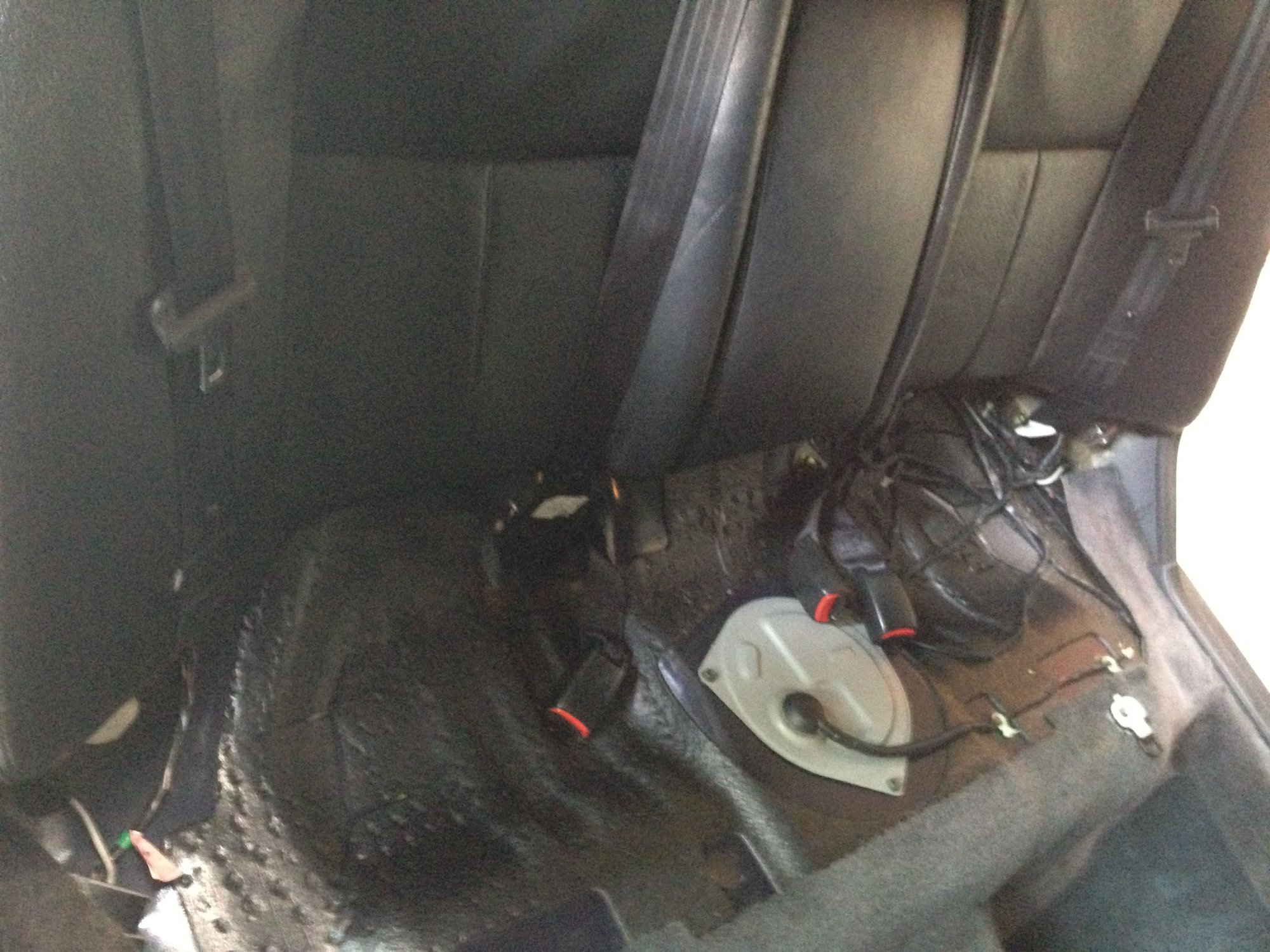

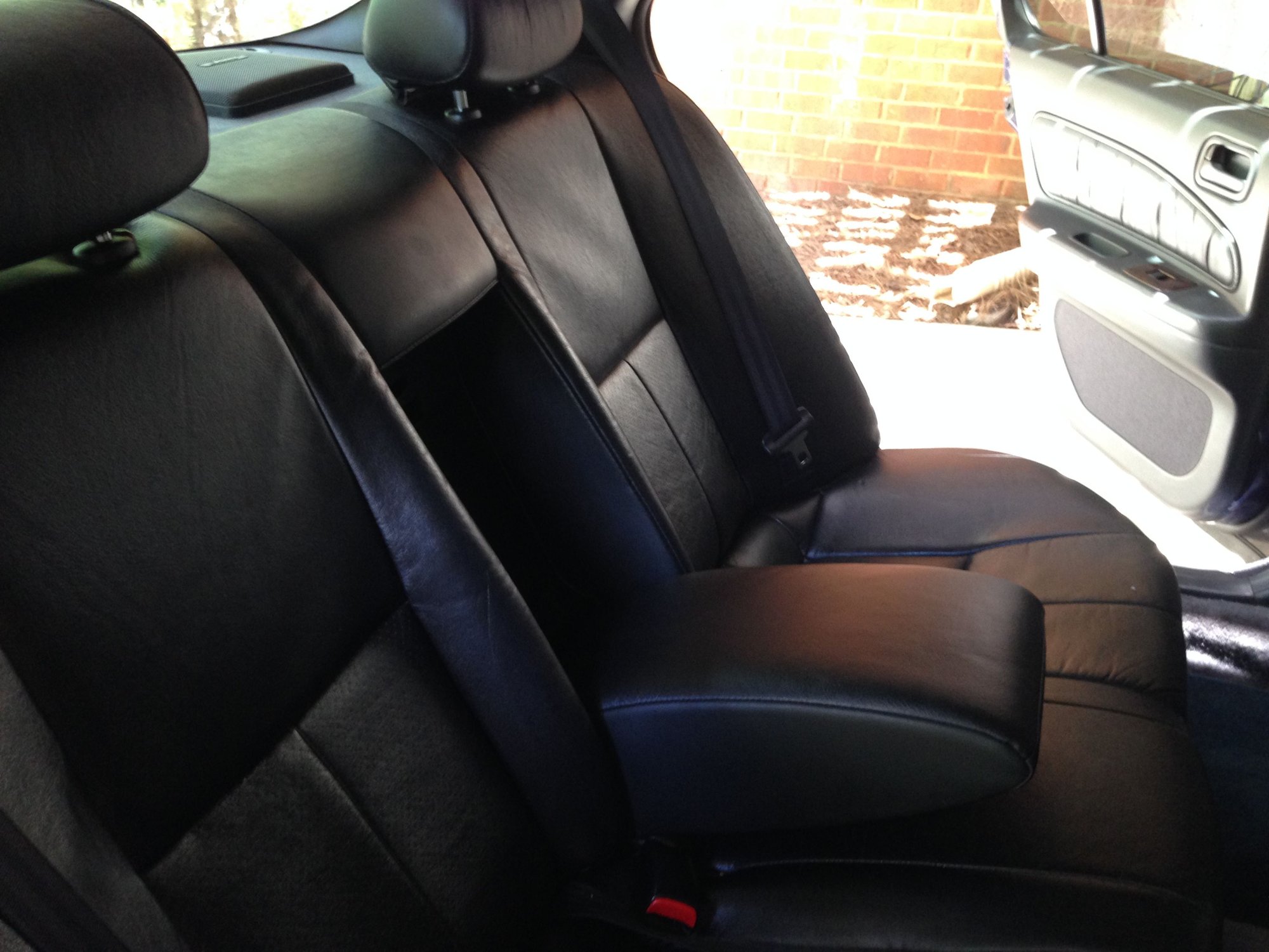

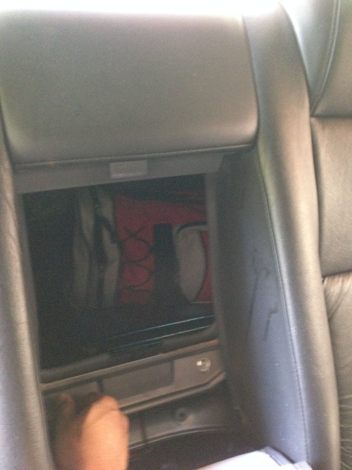

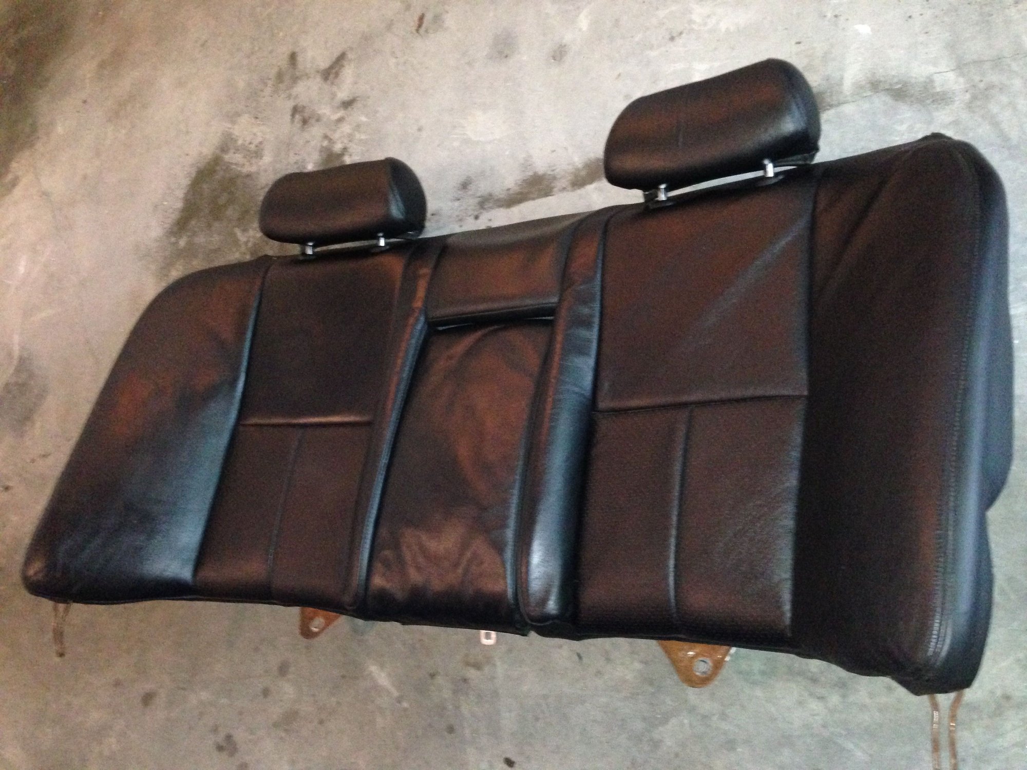

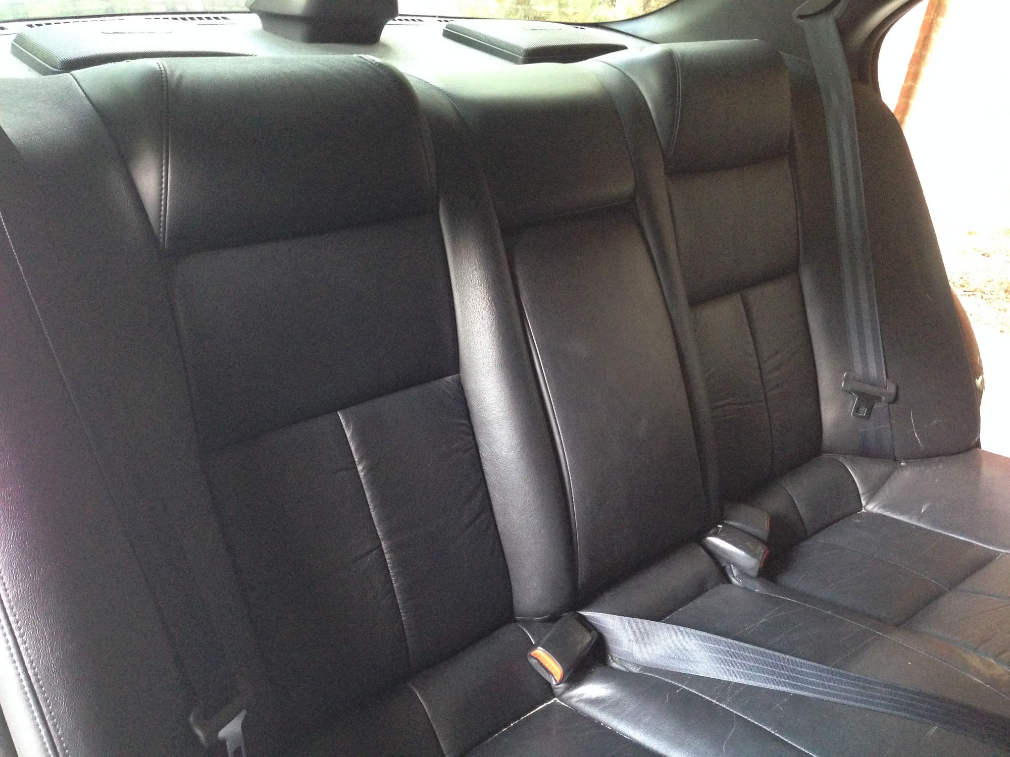

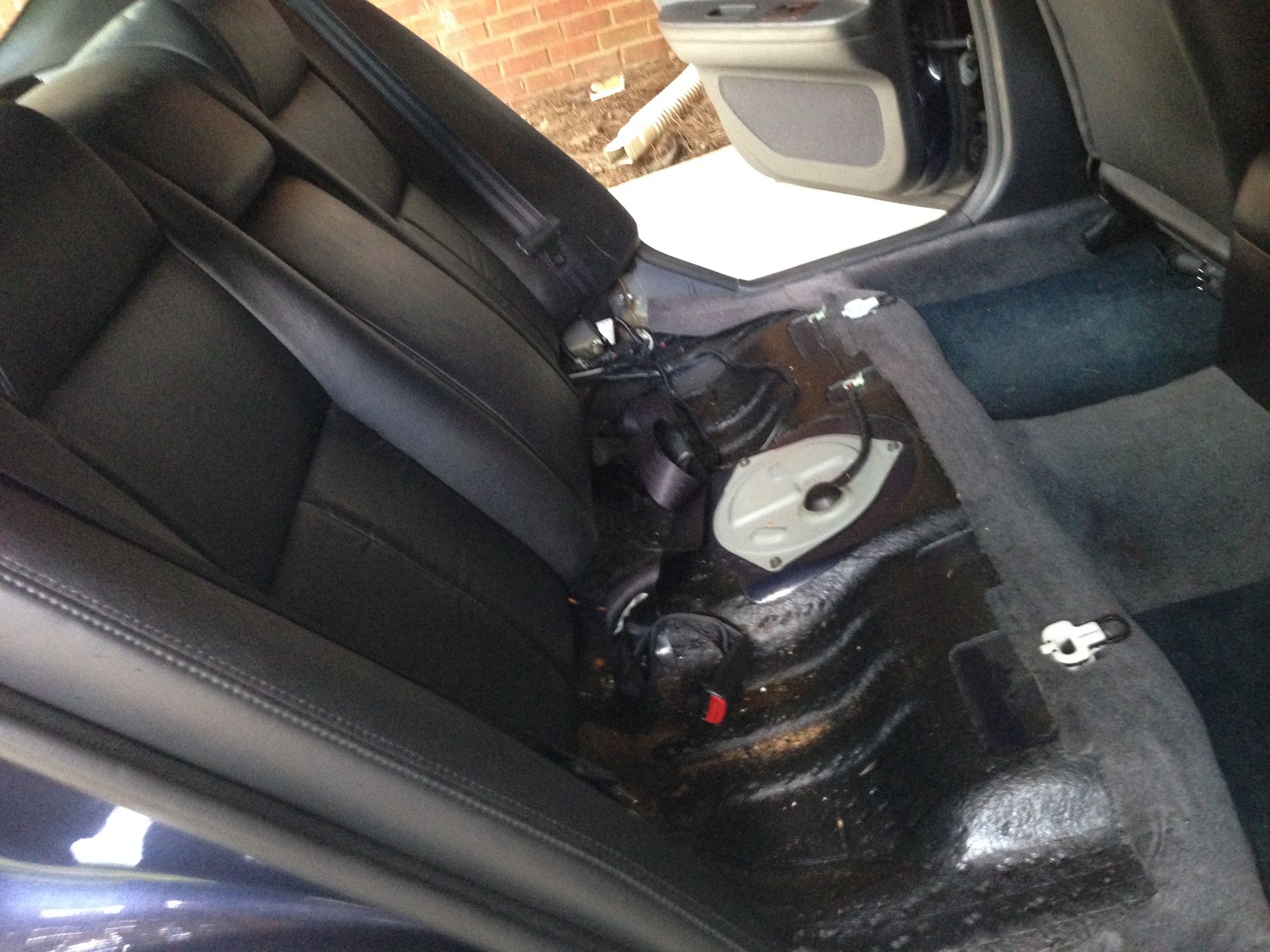

This post is about upgrading your Maxima rear seats. Even on my GLE, the original factory options did not offer rear seat headrests (which are so common in even the most basic cars today). The solution is to find an Infiniti I30 fourth generation -- take that seat and put it in. There is no drilling or modification needed.
When I was scoping a replacement seat, I didn't know if an I30 seat would work or not -- but I found a good condition leather black seat which matches my Maxima. I spent no more than US$30 (I had to remove the seat myself from a junked car). The whole job only requires typical metric wrenches. The pictures will help you finish -- please post your experience if you perform this upgrade.

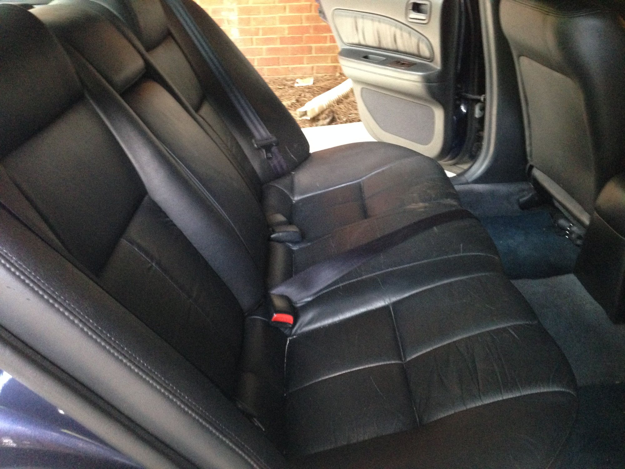

Start: how the seat looks at the outset
Start: another angle
The replacement seat from an Infiniti I30

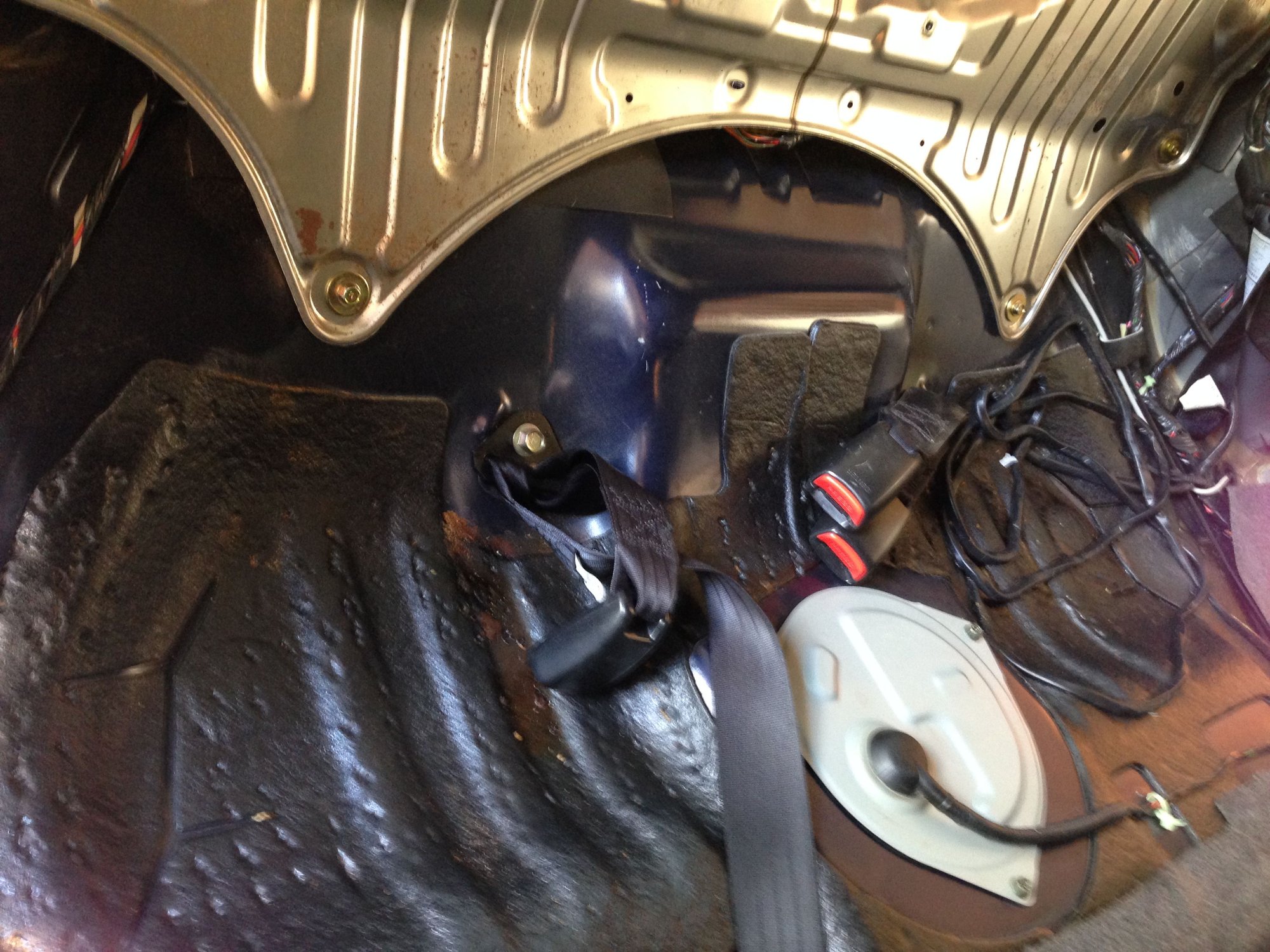

Must remove the bottom seat first to access the bolts
Bolts in the center portion

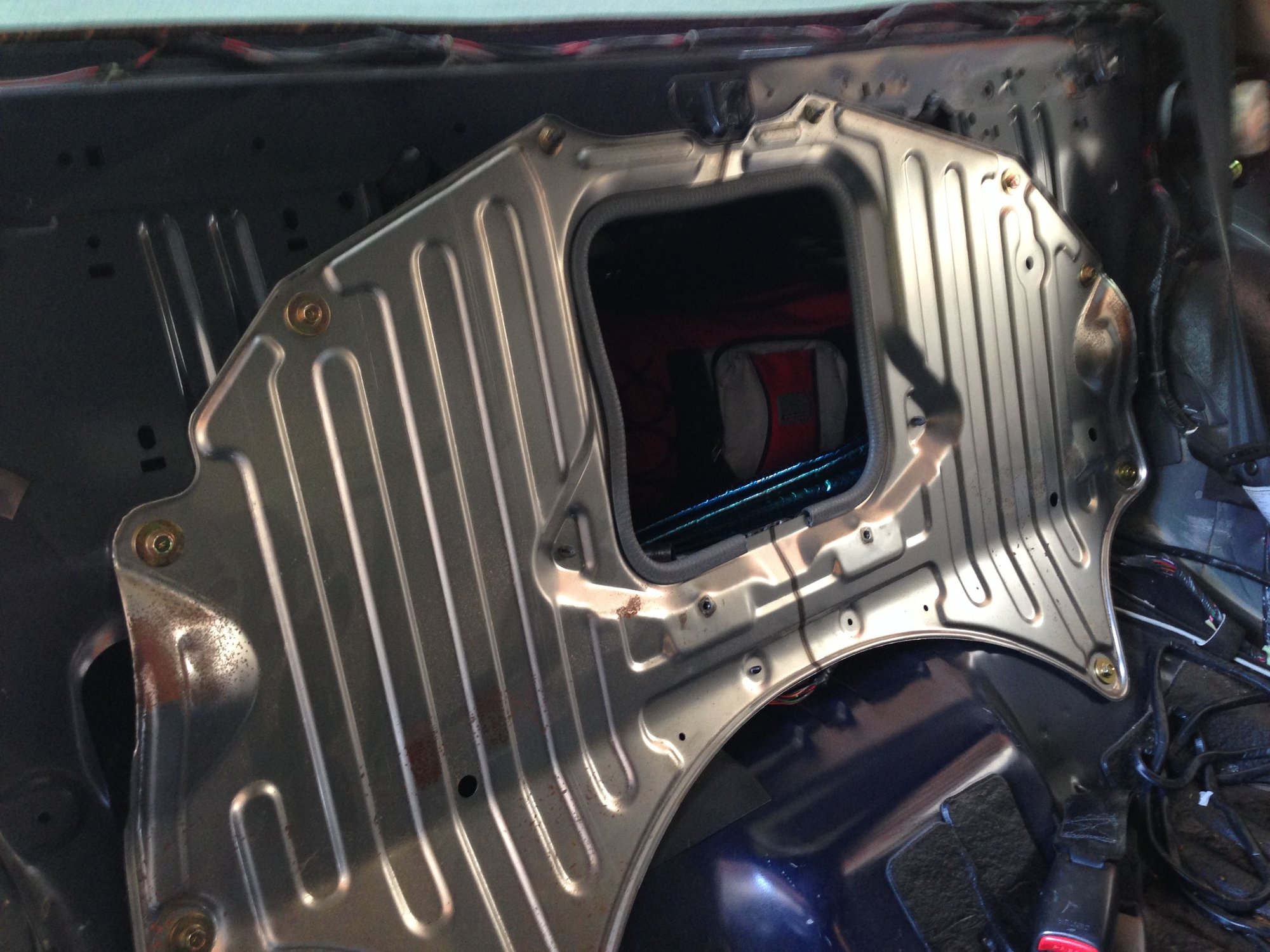

How the panel looks with the back seat removed -- this picture indicates where bolts connect
Bottom portion of panel -- this part is mostly covered by the seat bottom

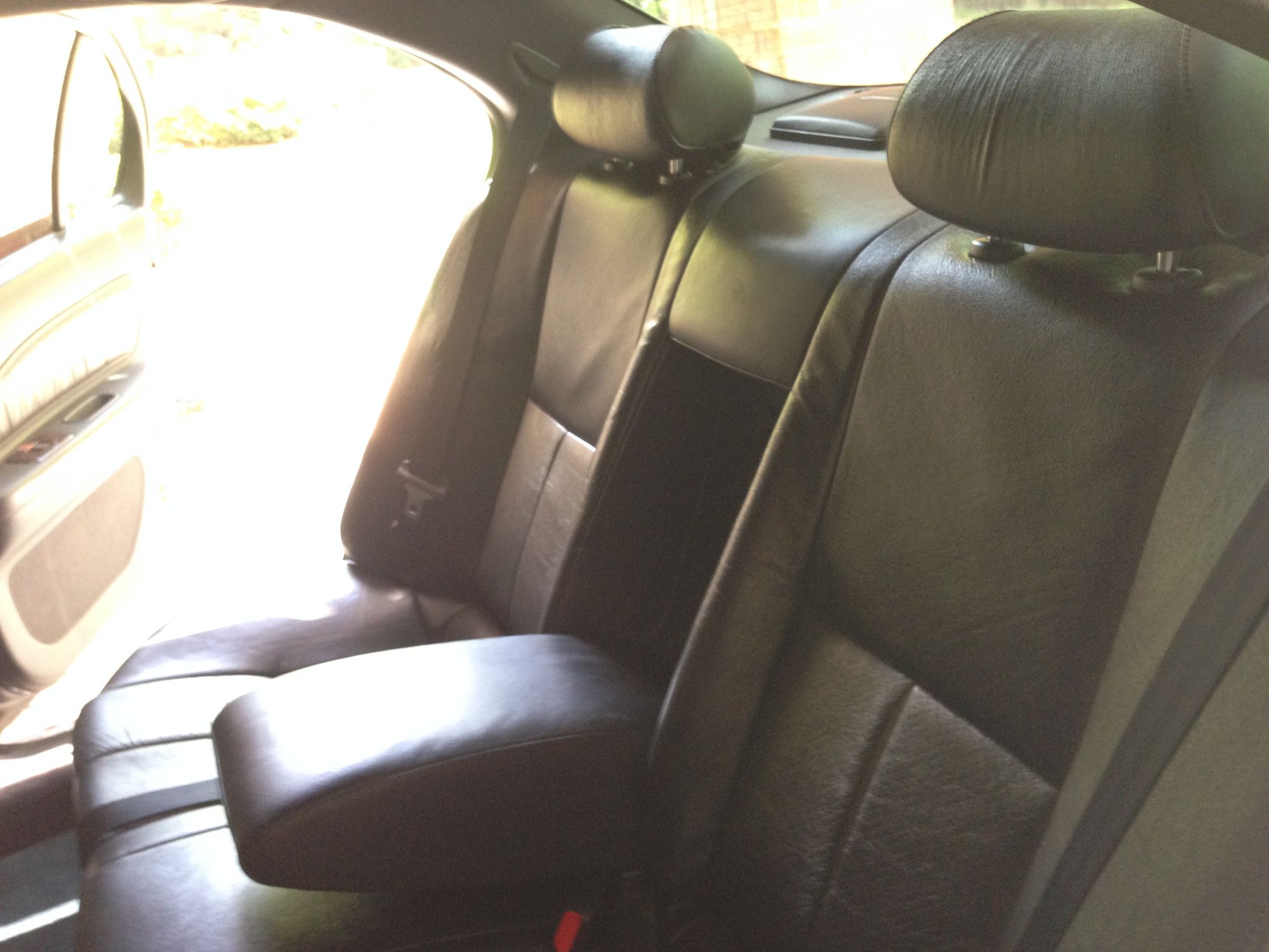

Replacement back installed (no seat bottom yet)
Complete: angle 1
Complete: angle 2

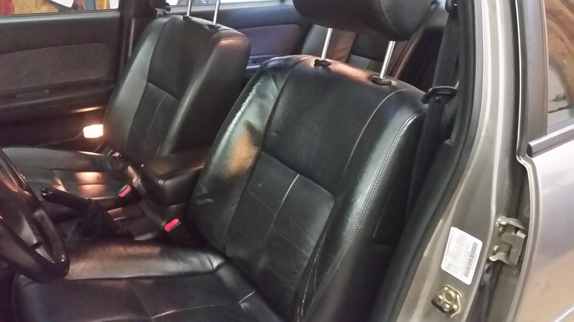

It's a common swap. You can use the front headrests too. The I30 ones adjust.
Sorry not a good pic, they tilt forward.
