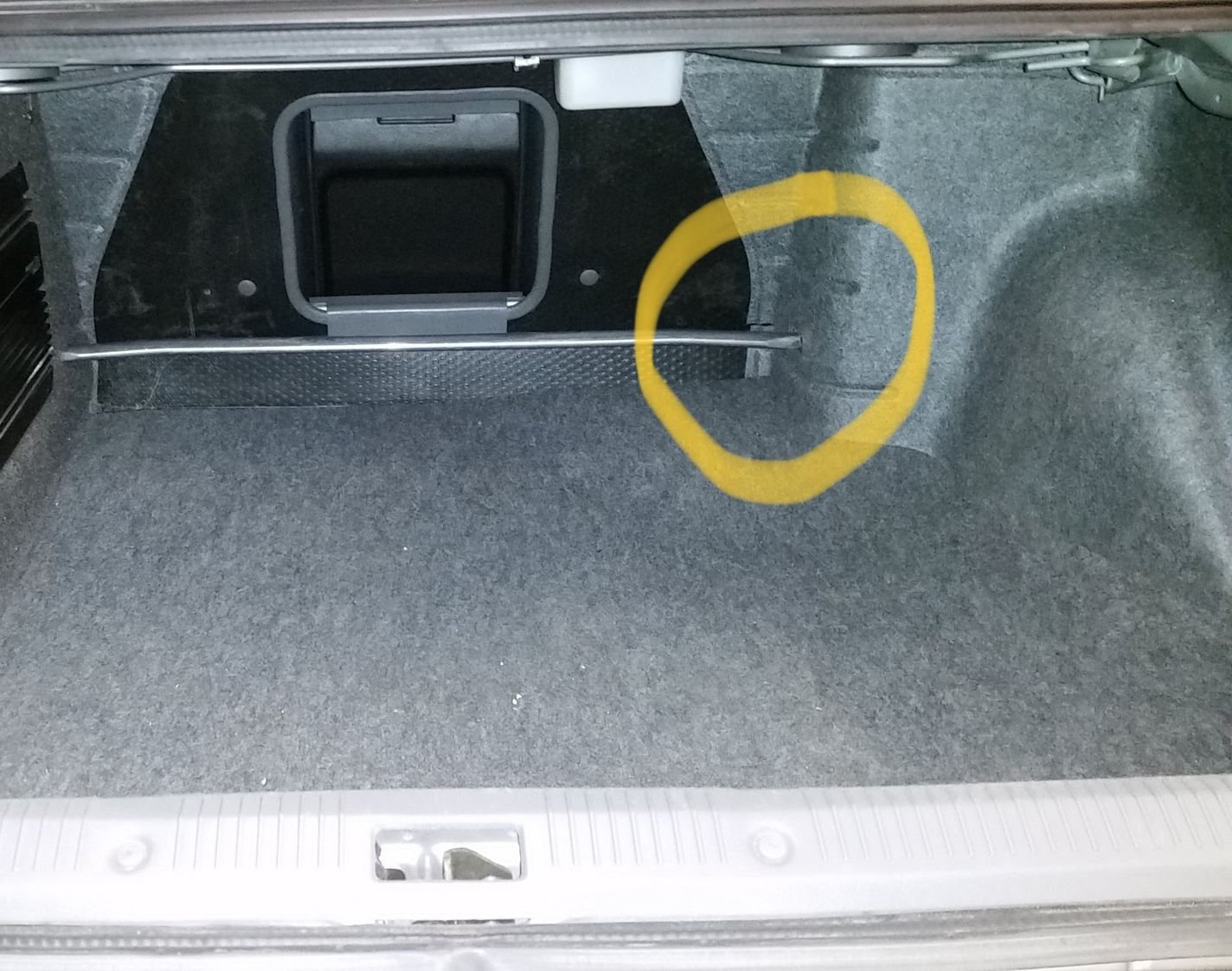

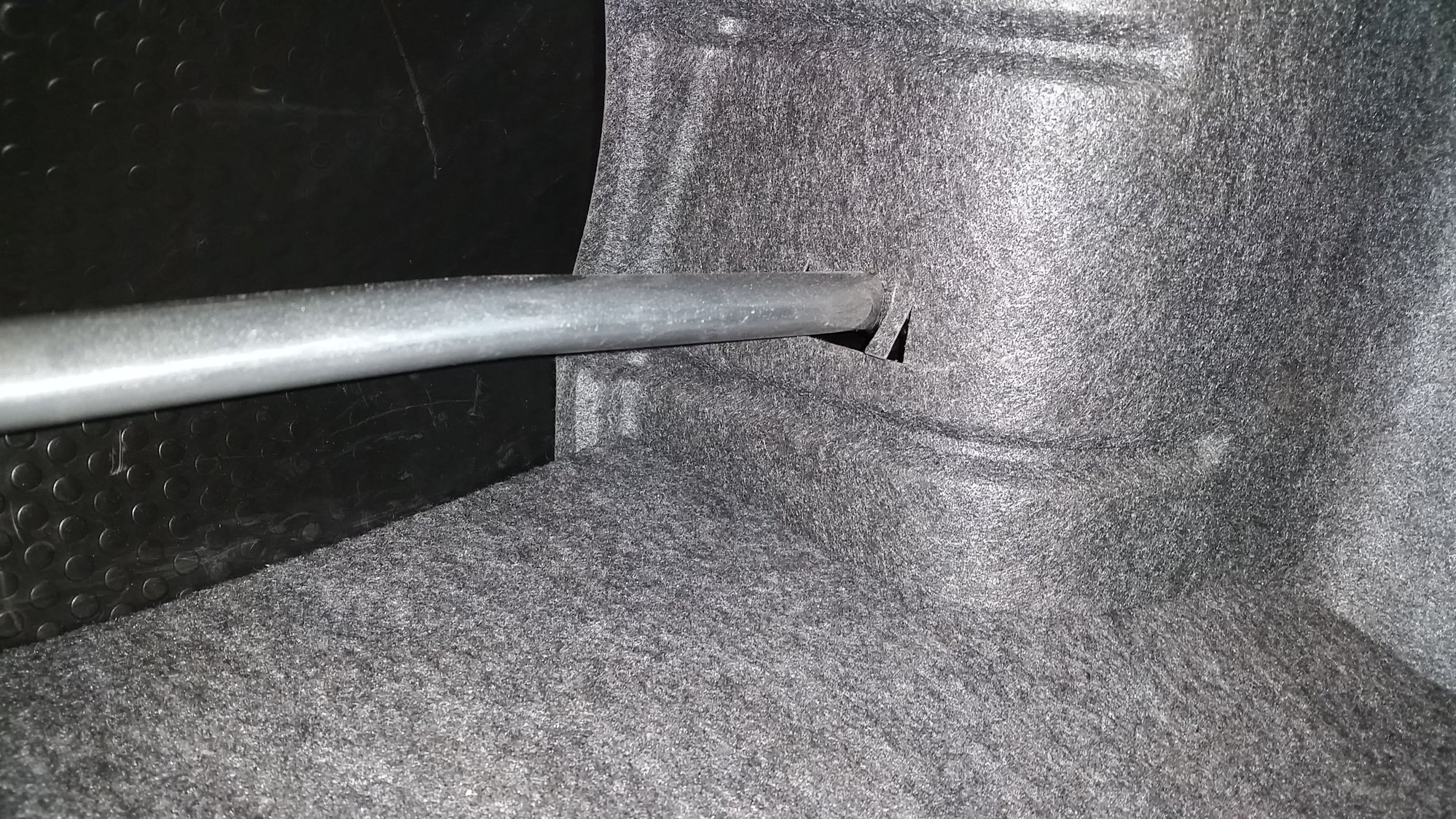

Test fit, eyeball the horizontal cut, keep checking fit. Once it's right make relief cuts for the bar but don't remove any material. Make little fingers for lack of a better explanation.

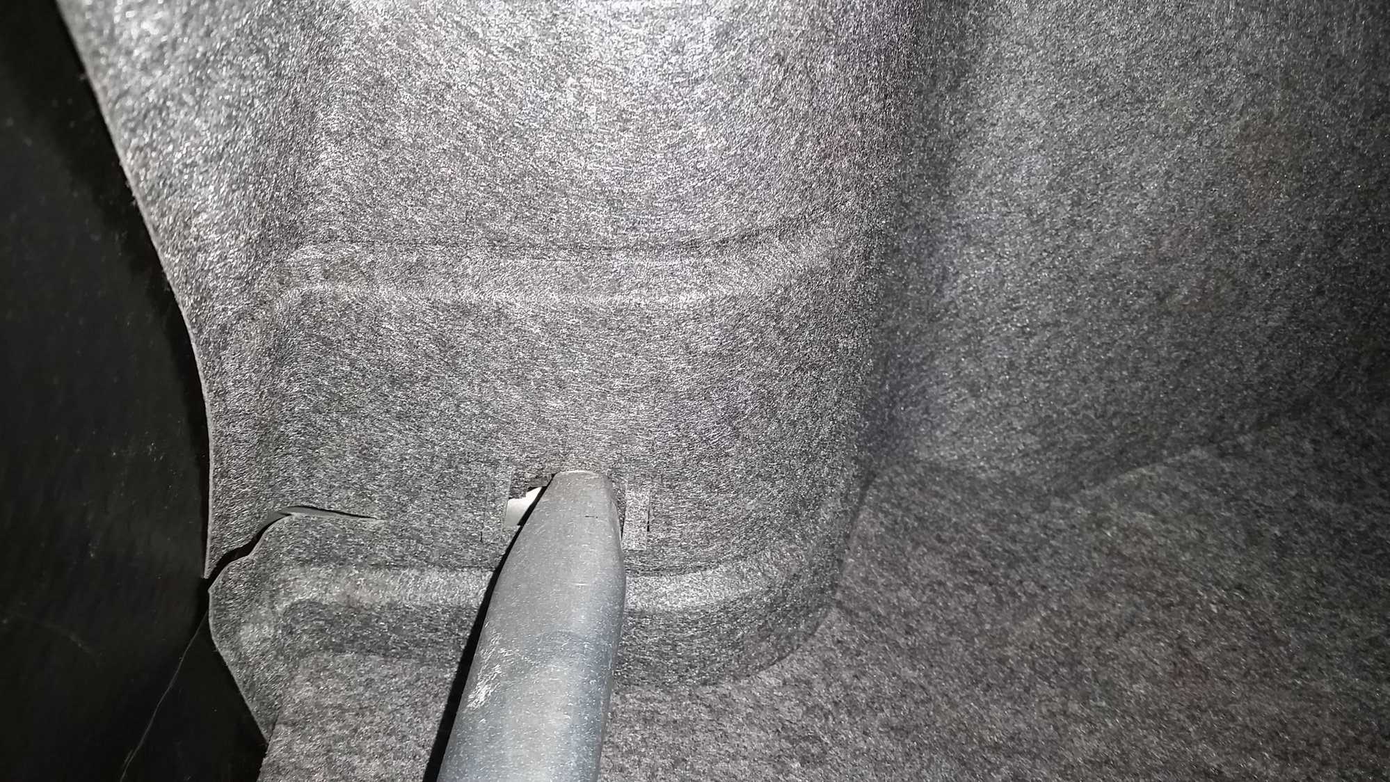

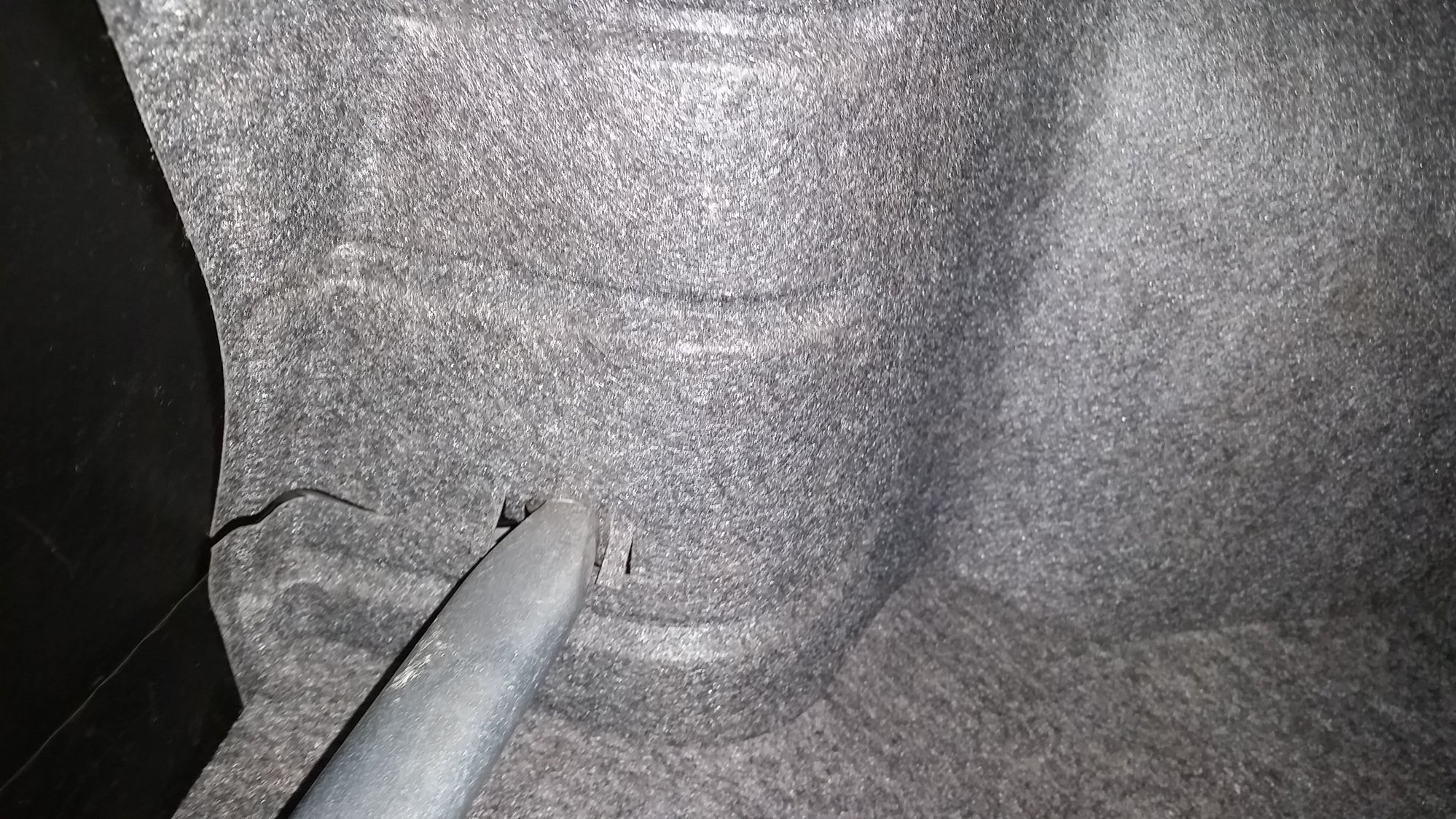

Sutter,
if it’s not too much to ask, when you have the opportunity, would you mind posting a close up/closer up of this spot ... ?
Old Jan 3, 2020 | 02:10 PM
RA030726's Avatar
I'm nutty for Nissans
Posts: 9,311
Not the prettiest up close. I should put some tape on the back.

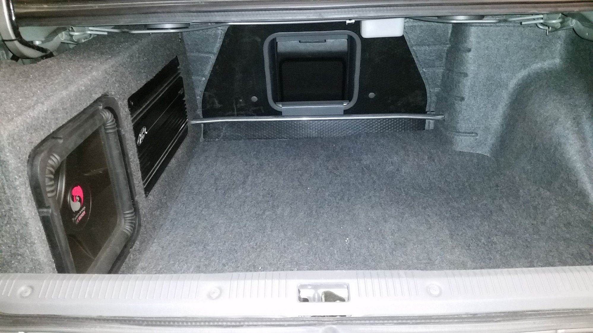

No. It's probably just a waste of time. This particular one is from parts laying around. I think it's a generic A32 gen bar with B14 brackets. More of a whatever, toss it on because I can. I've build a few others.
I had a Stillen bar, while bragging rights are high, the cost is not worth it. Not to mention it was pretty to look at.
