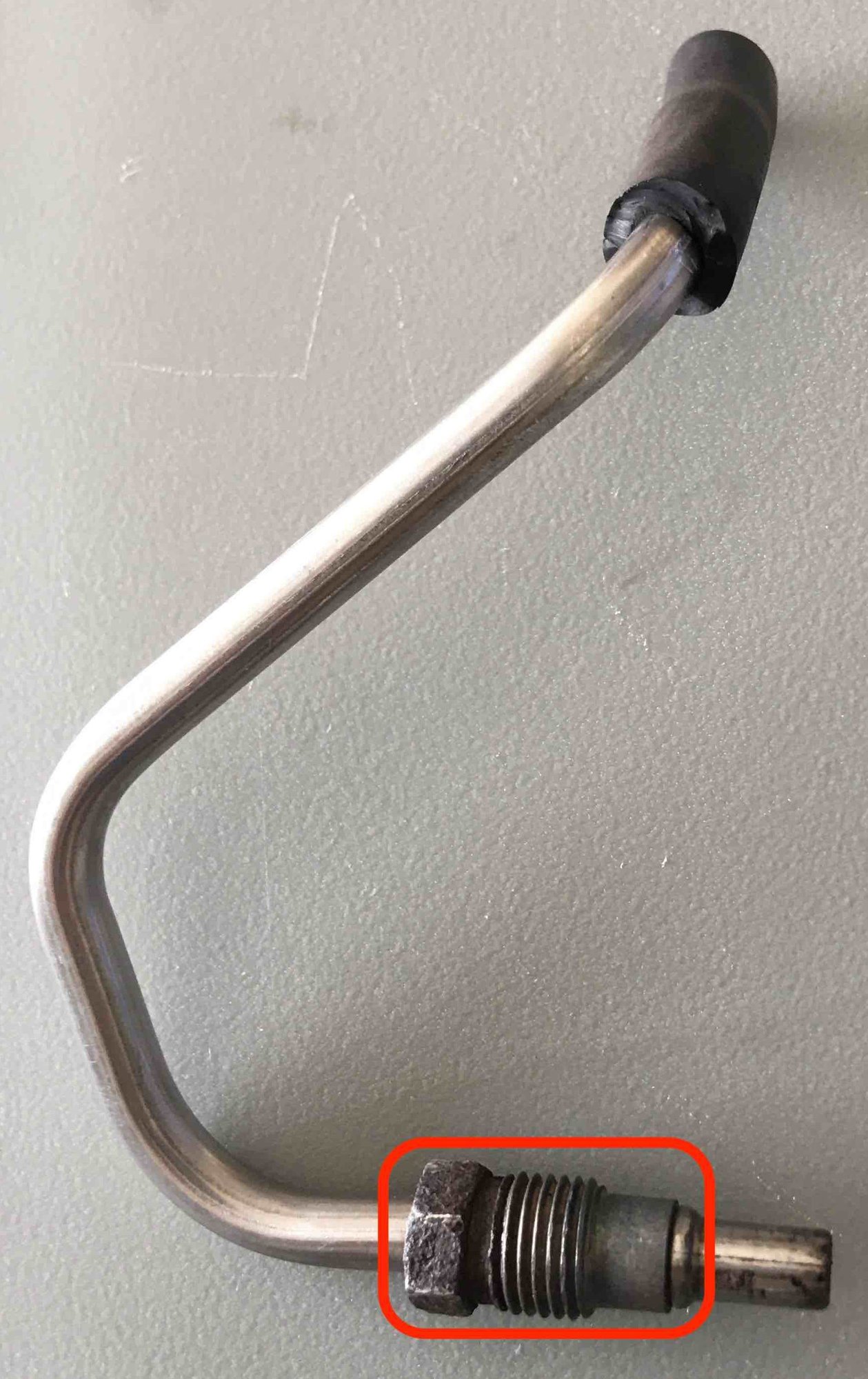

- I bought an EGR Valve a couple of years ago but never took the time to install it. I removed the old EGR Valve but had trouble removing the tube that connects it to the EGR Valve Control Solenoid. I had to turn the entire tube with the nut to remove it from the EGR Valve, is that how it should be or should the nut move freely? Can someone tell me what it’s called so I can order a replacement? see pic:

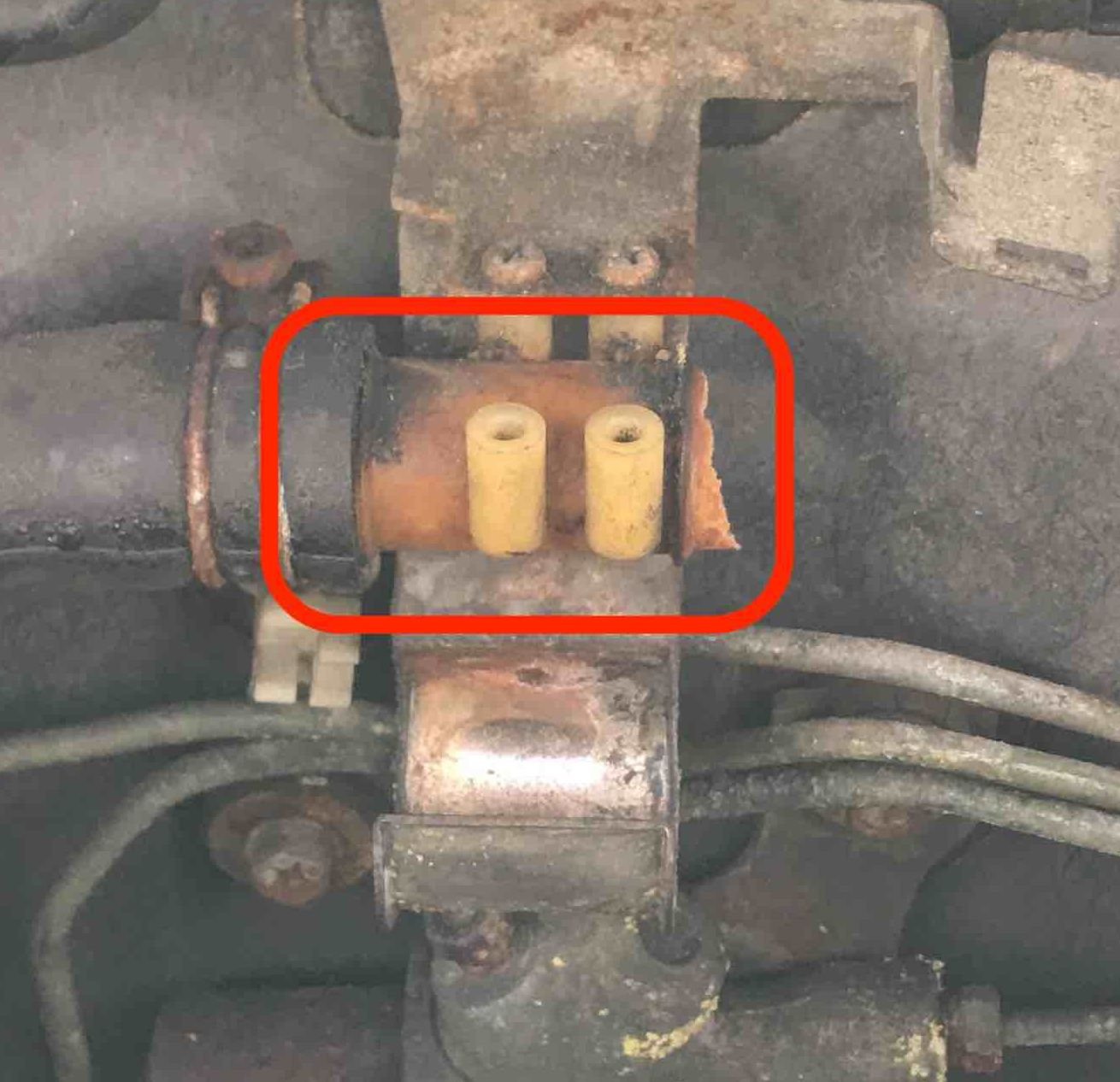

- What is the plastic part on the firewall called that connects the heater hoses? The original was so brittle it fell apart.

The broken plastic piece can be replaced with a 3/4" hose barb or get a hose from a newer 4th gen which is one piece and gets rid of that splice. It's a heater core hose.
