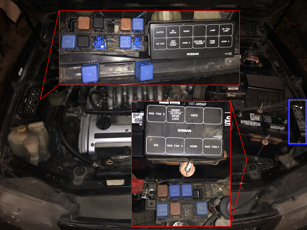

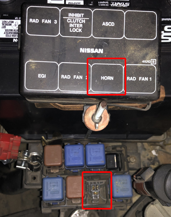

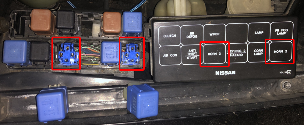

There are three horn relays. The first (Horn) is in the box in front of the battery. Already removed from its normal spot, it is the small black one seen pictured in the top right corner of that box. Horn 2 and Horn 3 are in the box on the passenger side and are the larger blue relays seen resting on my fender. I normally keep them in the two adjacent empty spaces in that box. There is also a 10 amp Horn fuse in the slim fuse box between the battery and the fender (blue box in first picture). For some reason I still have this fuse in place. It is possible that by removing the fuse you won't have to remove all of the relays as I have done. I haven't taken the time to check the FSM. I just pulled relays until the horn stopped and my battery kept its charge.
My car only has two actual horns, though there is wiring for a third. The first one (or possible two) is / are between the grill and the radiator. The last (or third) is on the passenger side next to the relay box.
