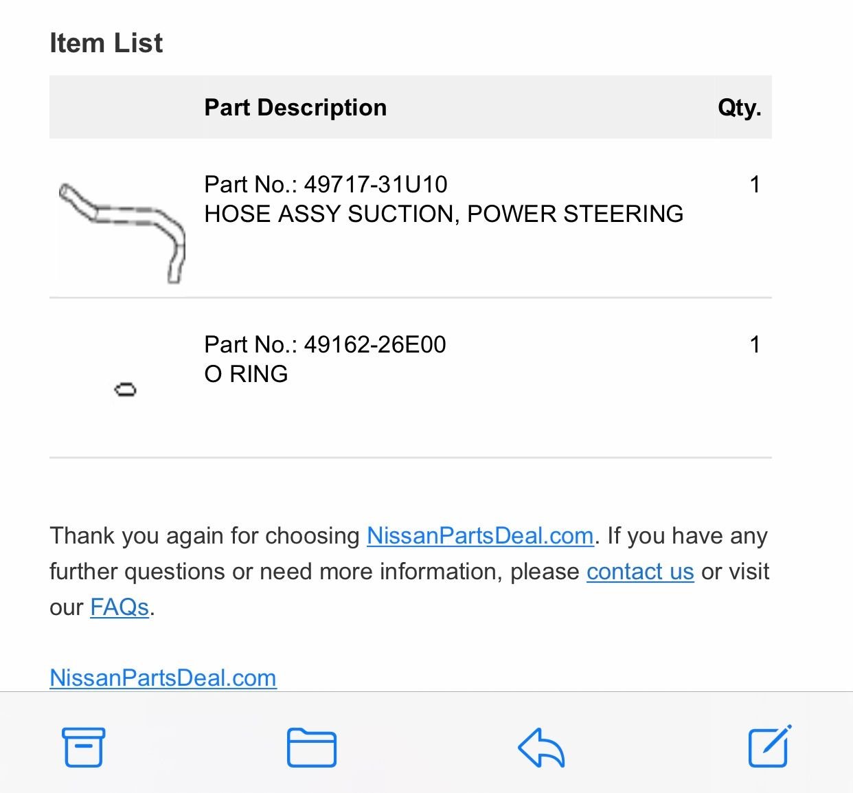

I'm beyond that, not really interested in where the leak is coming from, going to replace the hoses and pump and anything in that area that could be the source of the leak. There's no point in leak testing, I already have the car half torn apart, I'm not going back to do it a second time.

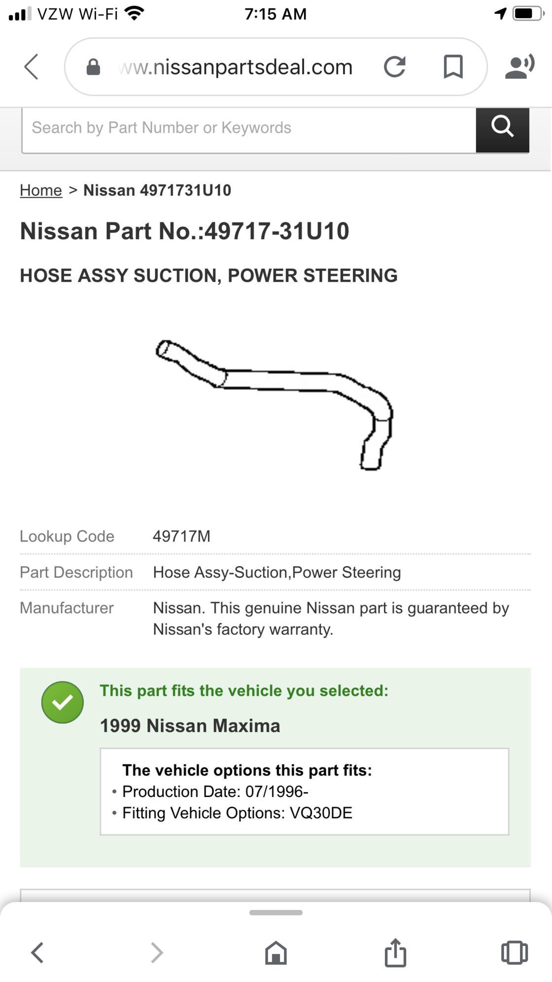

B) I'm after the two hoses that connect to the pump, correct? I assume one is pressure and one is return hose. Rockauto shows a return hose but it's a tiny elbow, which looks nothing like either hose attached to my pump. Can someone help me locate a replacement part for the return hose? Or describe how the one on Rockauto actually fits, because it doesn't seem like that's the correct one.

Hose

Here is what you need
Return lines aren't under pressure like the pump and high pressure hose.
I've seen plenty of pumps and high pressure hoses leak but NEVER a return line.
So.... Rebuild or replace the pump and high pressure hose and call it a day, i'm willing to bet it's one of those two.
