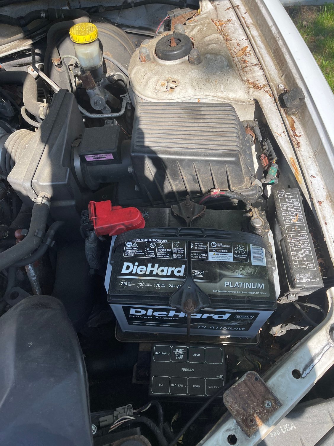

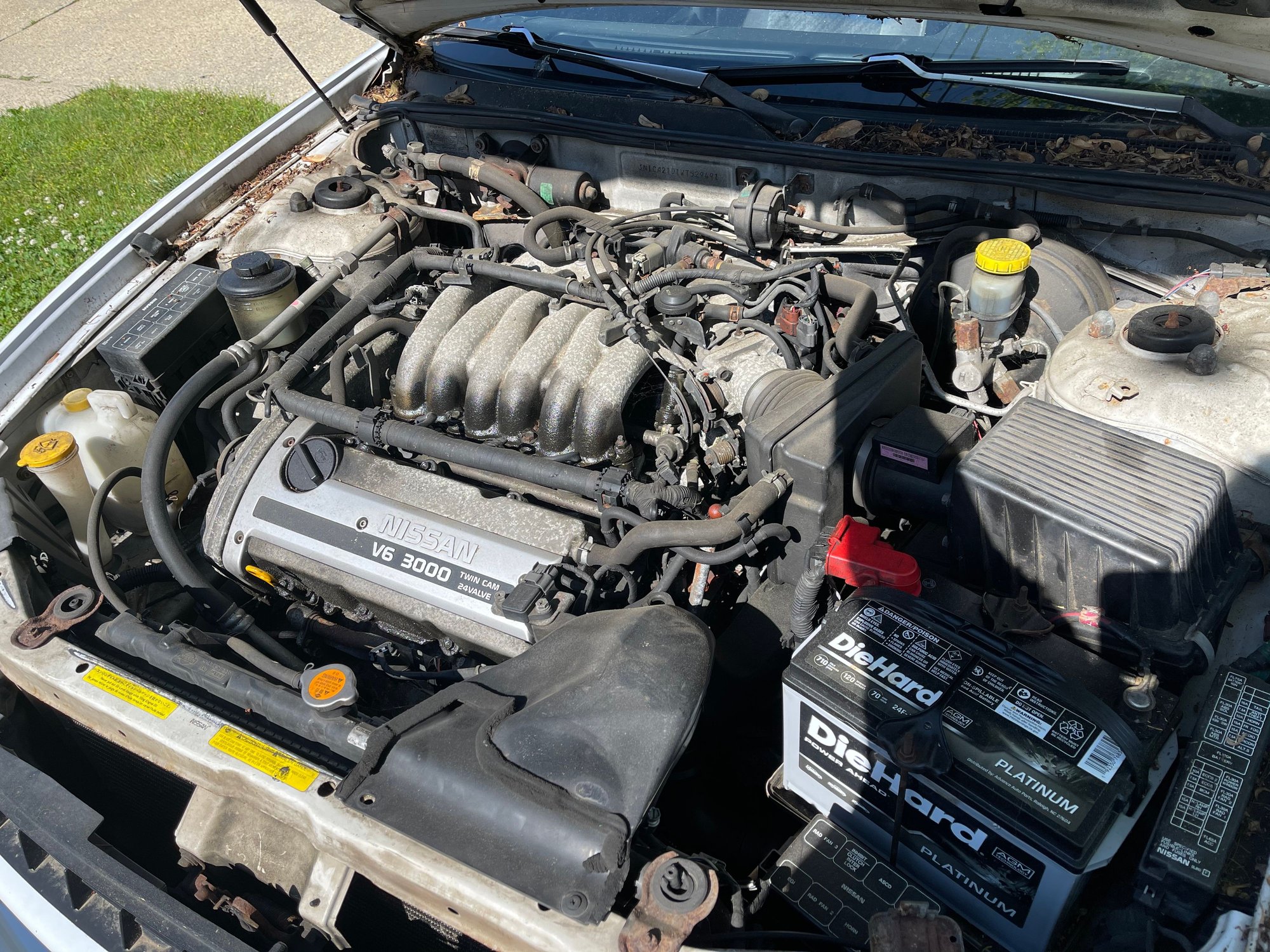

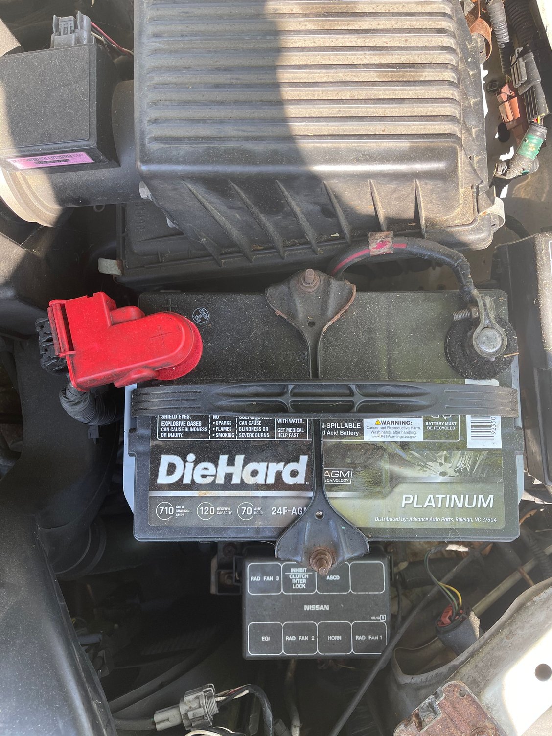

Bought a 98 last year, ran fine with zero issues. Drive it maybe once every two weeks. During the winter the battery died out and needed to be replaced. So I replaced it with this new battery and it’s been dying out every week everytime I go to drive it. Can’t understand why. The only thing I have on it is the standard alarm lock/unlock. It doesn’t even have a radio in the car yet. Once it’s boosted it’s fine, if I go to drive it again 3 days later it’s fine and will start with no issues. If it’s anything past a week then I have to get it jumped again. Makes no sense.
Any one had this issue or can think of a reasoning why this is happening?
Took it to my auto shop and they said they don’t see anything wrong 🧐

I did hear that term before but the car isn’t even making any noise when I try to start it. Straight dead with not even a click. Would that still be linked to parasitic drain? Crazy part is I had the battery checked and replaced. So this makes no sense to me. Can’t be two new batteries in a row that’s the issue you know.
