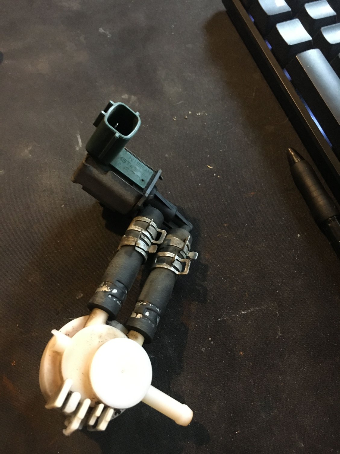

What is the part number for this
I am finally fixing my EVAP codes on my 97 I30 and ended up breaking this when I took the hoses off. They both are faulty anyway, What are they called and what are the part numbers
Thanks

Looking at rock auto, part number is
2379630P01

green one is evap solenoid valve.. you can test it by bringing 12 v to it listen if it opens and closes.
the other part is called BpT something,. you maybe able to just clean it out.

The nipples are broken off.
I know I ended up replacing it. Those things are brittle
