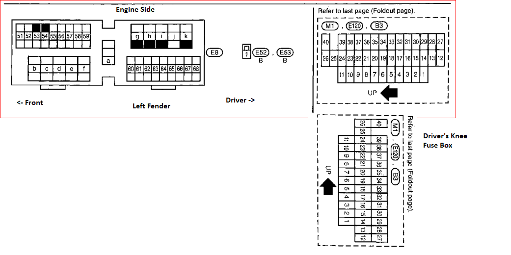

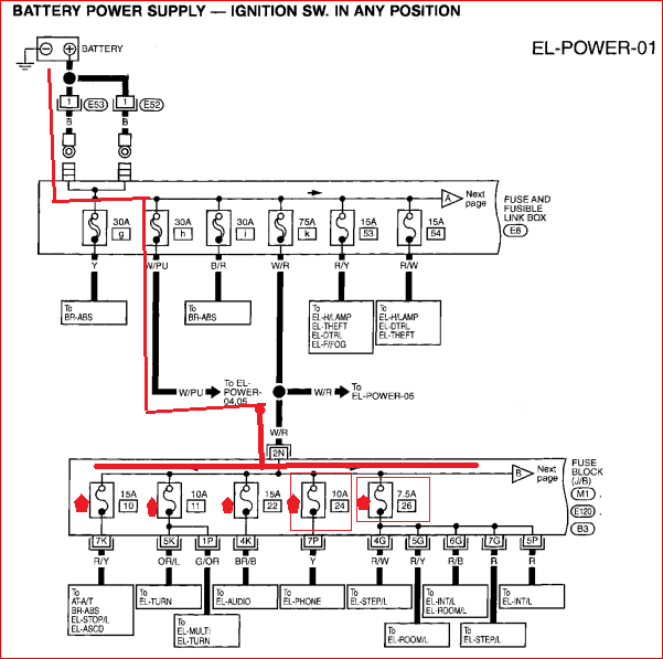

Old Dec 4, 2021 | 03:52 PM
saig's Avatar
Posts: 235
Use this
Amazon Amazon
Tap to either fuse 10, 11, 22, 24, or 26, etc. at the fuse block (driver's knee location) to create a separate circuit.
Page 9 of 1998 FSM-EL
Old Dec 4, 2021 | 06:16 PM
RA030726's Avatar
I'm nutty for Nissans
Posts: 9,311
Under the center console is a small plug for a car phone. It has the following wires:
Battery 10A - Yellow
Ignition ON/START 7.5A - Green
Ignition ACC/ON 7.5A - Yellow/Green
Ground - Black
