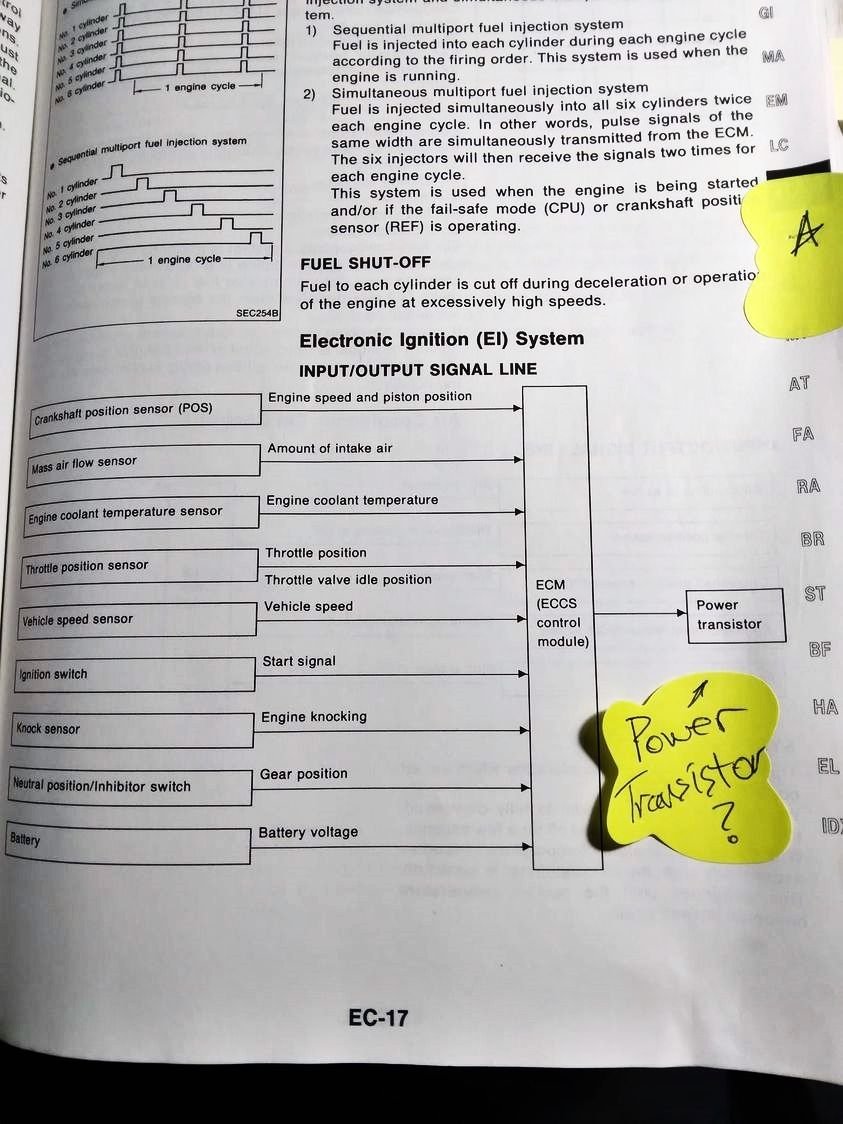

Well, I found this in the FSM... I know a transistor is an item that could be affected by heat (in this instance caused by current flowing through it) and could fail and cut off power from the ignition system.
Now, to find out if it's a serviceable item, or is integrated into the ECM of the car.
On edit: I think it's not an actual item on the 1995 engine control electronics... it may only apply for engines with actual mechanical distributors... but, what would explain it being shown in the manual for this year of engine/car?

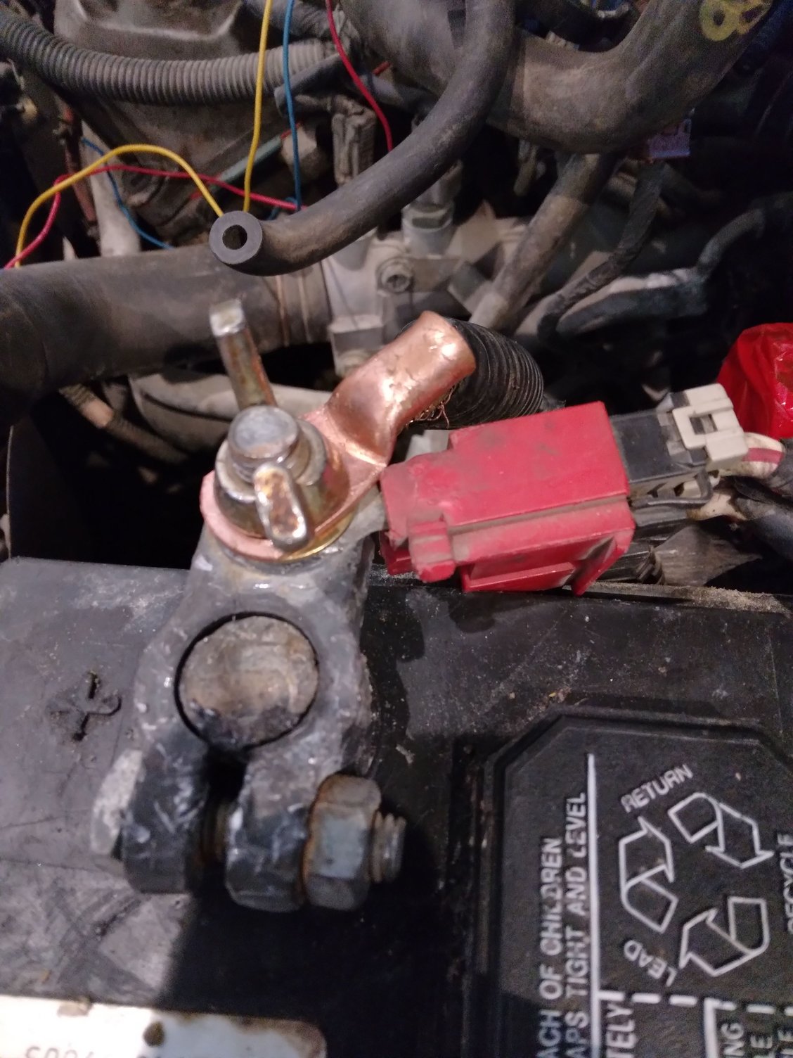

Wonky Battery Connections?
The positive cable clamp when tightened to the max, usually never tightens fully and you can remove it by pulling it! They sell lead sleeves to make the battery post thicker so it will clamp on tight when tightened fully.
Hey... Ya never know?

I was thinking he could be loosing power from a loose connector at the two plug connector b+ at the battery. Which powers the fuse box. They can become loose over time. Like most of us. Its bypassed. However he would loose all power in the car when this happens.
From what I can image of this story is that the car had been cured of the stalling due to a bad alt, previously...and had been running fine for sometime untill a shop replaced the LCA's and Axles..

Now, the two wires that connect at the positive terminal... they're on there good. I crimped copper lugs on the cables that come up to the battery, and put on the battery terminal clamps like the ones pictured below.. and attached everything on those studs.

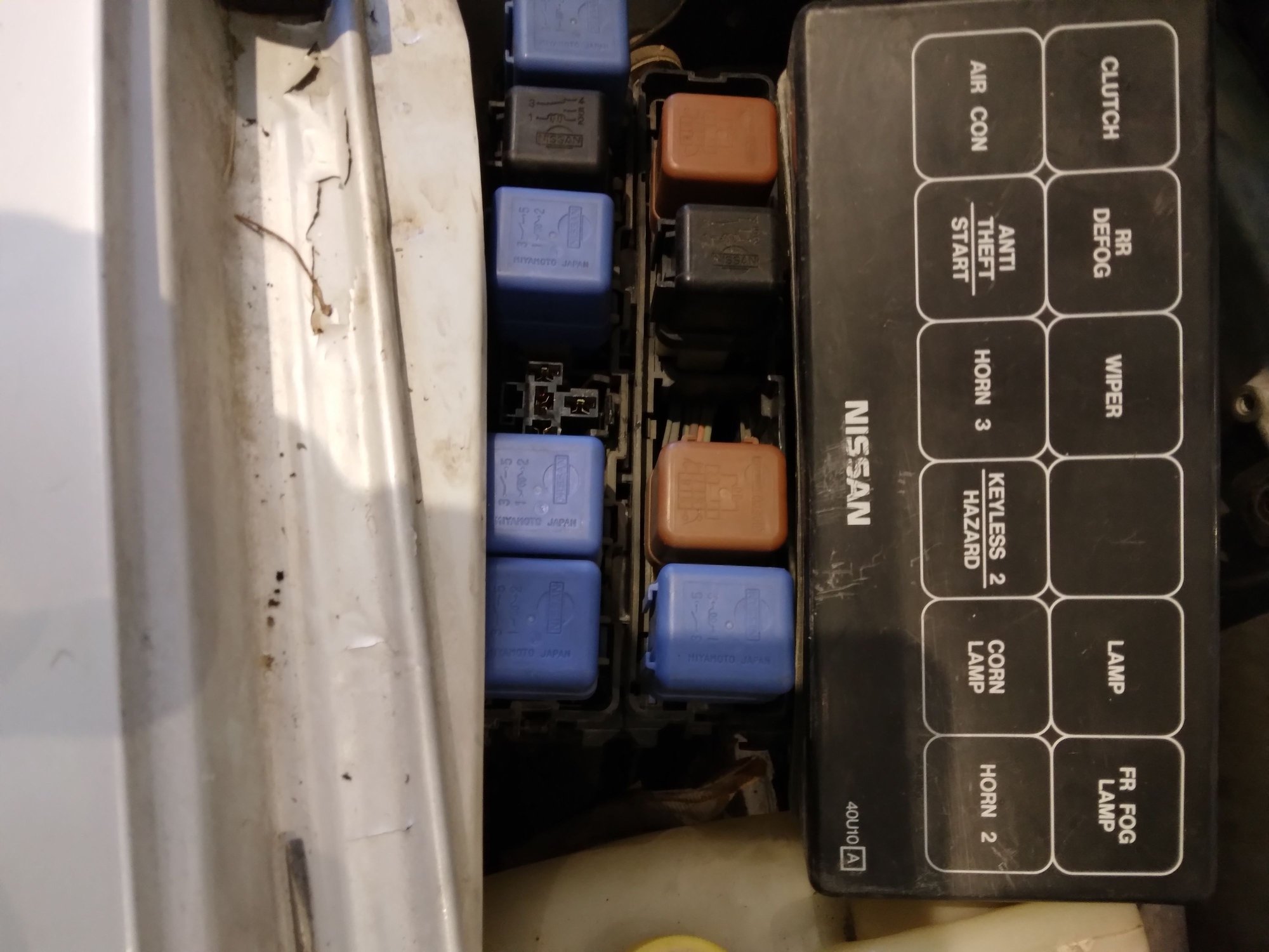

Where there was front end damage, the box that held all the relays right behind the drivers side headlight... that box must have been destroyed and some wire damage occurred up there. All the relays are still there, and a lot of the wires have been soldered back together and covered with shrink tubing.... but the group of 8 or so relays are laying there in a group, the wires "wire tied" together keeping them all in a big clump.

Here's what I meant when I said the relay box behind the driver side headlight had been destroyed and all the relays wired back in place and just held together with a wire tie..
Aug 10, 2022 | 01:25 PM
I just come into the shop and was trying to decide what to experiment with next.
I removed the "keyless2/ Hazard" relay out of the relay box behind the passenger side headlight... then I reached in and started the motor.... it surprised me and ran for more than a minute and a half, so I thought maybe I had figured out what was wrong..
Got in the car and hooked the OBD reader up to it and was setting their scanning... after it had been running for probably three and a half 4 minutes... the engine died..,
Dejected, I thought I had found the problem,
but evidently that ain't it. The engine started the second time and ran for about 10 seconds and then died and wouldn't start again.

Quote: These terminals are just fine.. those little strap clamps are little on the flimsy side to me.
Awesome now I can see what you have going on, That Red 2 plug connector is what I want you to check. All 3 of those wires big wire included need to be on B+ directly with out all that other crap. Looking at your other photos you may have inadvertently moved a relay or connector or wiring somehow to get to this point.. simple Koeo, do the old wiggle test on the wiring and fuse box where you were and listen for anything.. Ide also un tape and take a look at that junction where the set of relays are hanging. I never said to replace anything.. I said to Test..
Check this section of the harness..
I would also, I would also take a Look at Nissan Service Bulletin NTB-98-00B..

There are two relays down on drivers left kick panel, behind the ABS control module. They're exposed because I dug them out a long time ago to check them. One is the sunroof relay, and the other is the fuel pump relay... I think. Pretty sure that's right, without digging out the book,
Anyhow, I grabbed one... it was noticeably HOT!!!! Actually, they both were, but I think one more than other.
I grabbed digital voltmeter and back probed terminals 1 and 2 on both relays. One, the hotter of the two, was getting 14.4 volts. The other was at 12.4.
Not sure which one is which. I think I read in the FSM that the fuel relay could be identified by a stripe of tape around it. I thought that odd when I read it, and now that I've mentioned it, I'm sure I could never find those words again in the manual if my life depended on it, lol.
Anyhow, I am unsure why one has higher voltage than the other. I didn't want to tempt fate and remove either one while it was running, so I left them be. I have one of those temp guns I was going to aim at the relay housing and see exactly how hot it was, but the battery was dead.

I suspect that, too.. that's why I'm wanting to find those two relays... and see if they're staying closed or opening.
Until that episode yesterday, it was predictable... the engine would run like a top for 1'30" and die, like clockwork.
All I had done was remove that hazard relay, and reinstalled it after it ran a bit.
I took that relay and put 12 volts to it on my test bench... let it set for a few minutes, to give it chance to get hot and open the contacts. It never did.
The only reason I chose that relay because it has something to do with the keyless entry. I am just grasping at straws.... I thought that if it would even start and run without it.. I'd experiment and see if it had any effect. But, after all that, I'm not sure it did.

I'm beginning to think that the way it loses ignition signal to coil paks... it's got to be either the ECM or the relay or whatever provides power to it....
